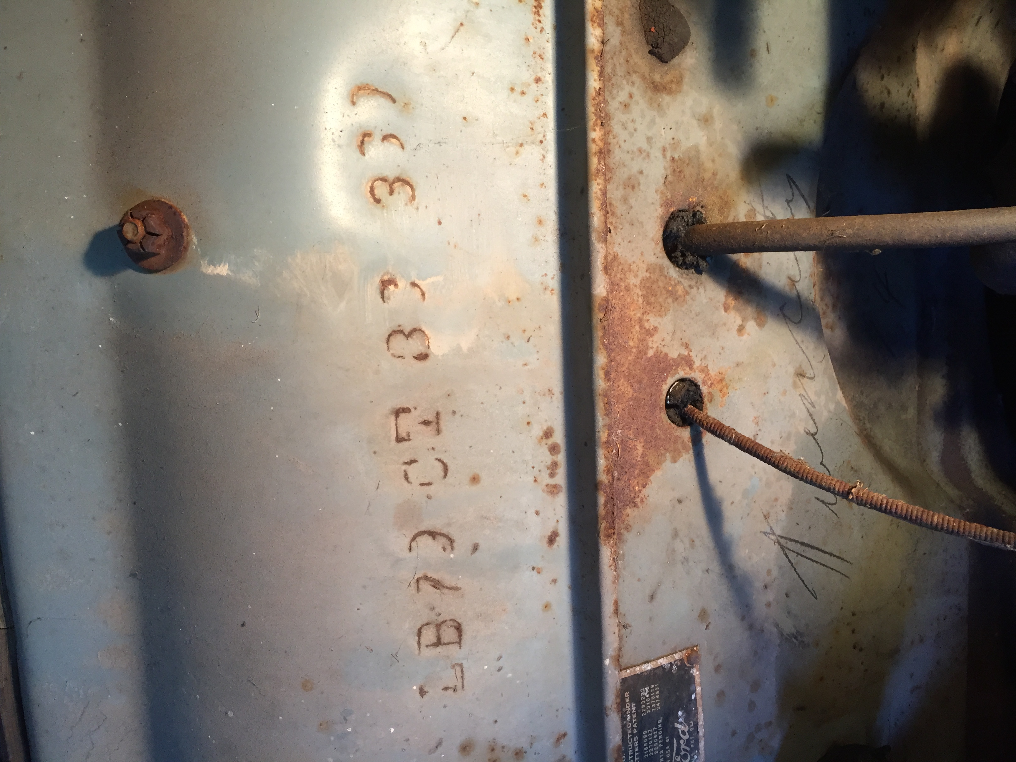

I have just liberated a 1951 Ford Country Squire from being off the road since 1974. wondering what these letters and numbers mean that are stamped on the fire wall LB79CT39337 OR SOMETHING LIKE THAT AS THE STAMPING IS NOT REAL CLEAR. serial #B1LB115700
ALL help appreciated.

Part of the cowl code can be deciphered using data in the 1940-1950-1951 Ford Book, available on this website.
LB=Long Beach assembly plant
79=Country Squire Station Wagon
C=Sheridan Blue exterior paint
T=Two-tone tan vinyl
The remaining numbers are unclear. The first three should denote the day/month of production, but the second or third number is normally a letter. The latter part of the number is the unit production number.
Variations of these cowl codes have stumped owners for years.
The serial number indicates V-8 engine "B" 1951 "1" Long Beach assembly (LB). The 115700 is the unit production number at that plant.

Bird,
Looking at the cowl code, there is a possibility that the codes after the "CT" could be 3C or 8C. If so, this would indicate production on March 3 or March 8. The 337 would be the production number on that date.
If there is any original glass on the car, you can decode those codes as well. If they are February or March 1951, that would be an additional clue.

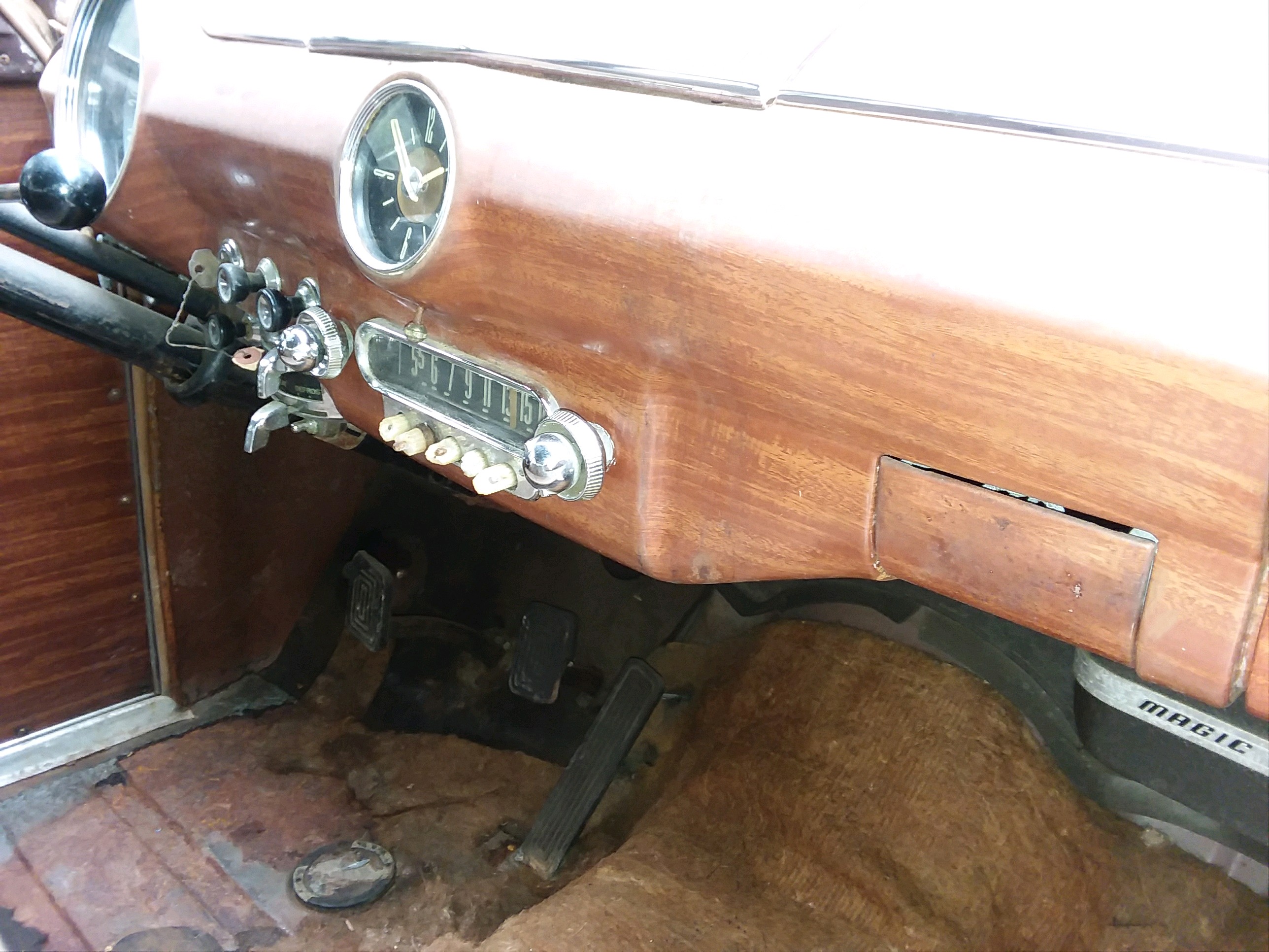

Ive known this for yrs but why did Ford put a 50 dash in 51 wagons ???? ken ct just curious!

I think the reflection off of the windshield is blocking out the chrome strip and solid color painted part forward of that up to the windshield.
bird
10-23-2018 @ 7:52 AM
Posts: 10
Joined: Sep 2018
Upon viewing other picture the chrome strip and solid color painted dash shows up well so dash appears to be the correct one.
