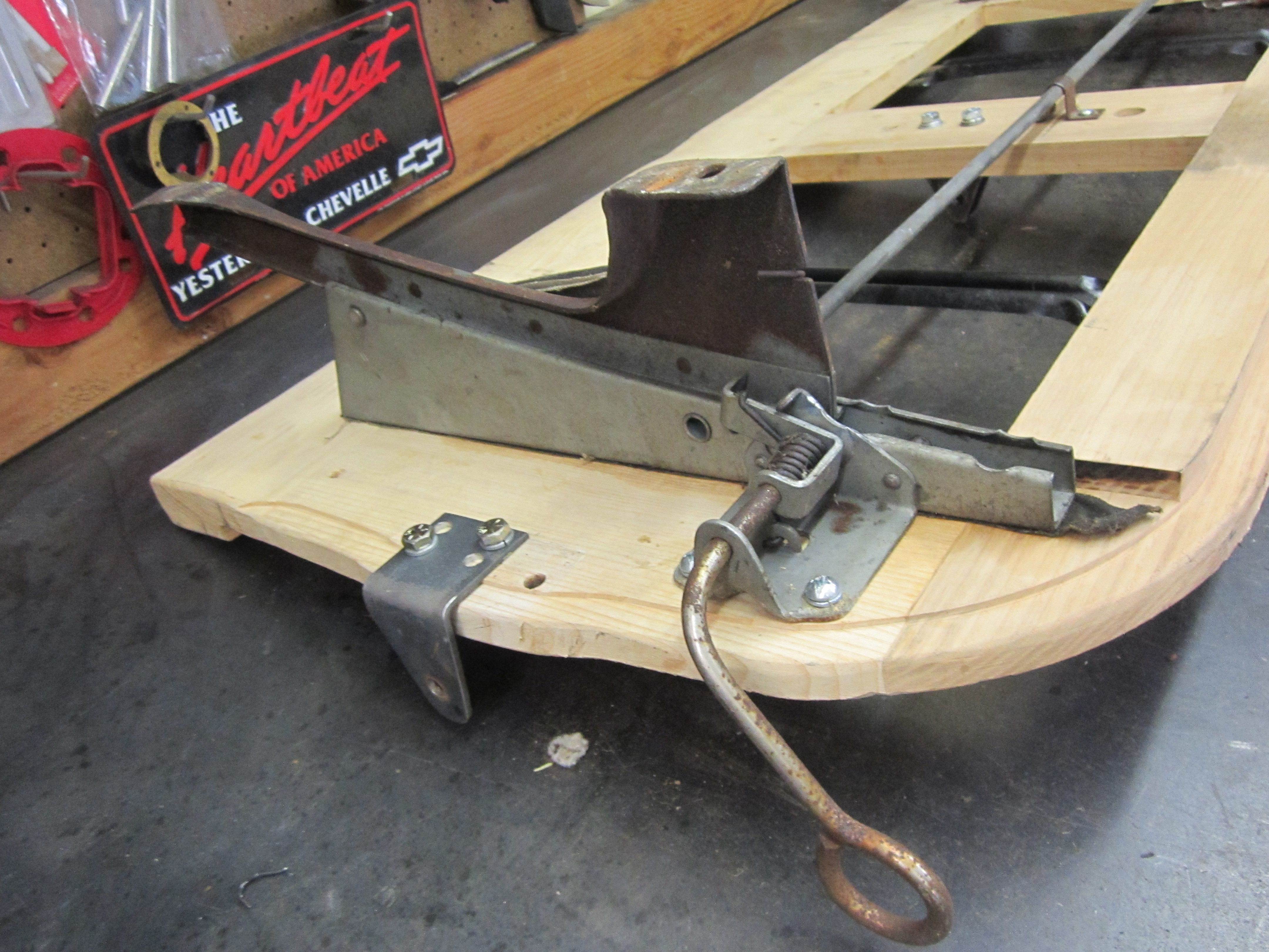

Tom, yes the photo indicates the drivers side seat track. The attached photo shows the adjustment lever and where it fits through the hole in the seat track. As you can see the lever does not have anything attached to it that would turn the seat track gears. A photo or diagram would help me figure this out. Thanks, Jakes.

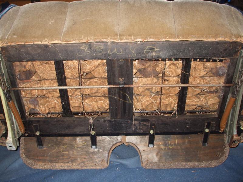

Jakes, Check out the attached pics. I have more and can take more specific pics if you want. Let me know how I can help. I went through the whole seat restoration and it works nicely. Gregg (I attached two pics but only one showed up)

Here is a photo of my seat underneath. Unrestored 1937 Ford Fordor Deluxe. Jakes, the book is well worth the money. . . . 78-730B

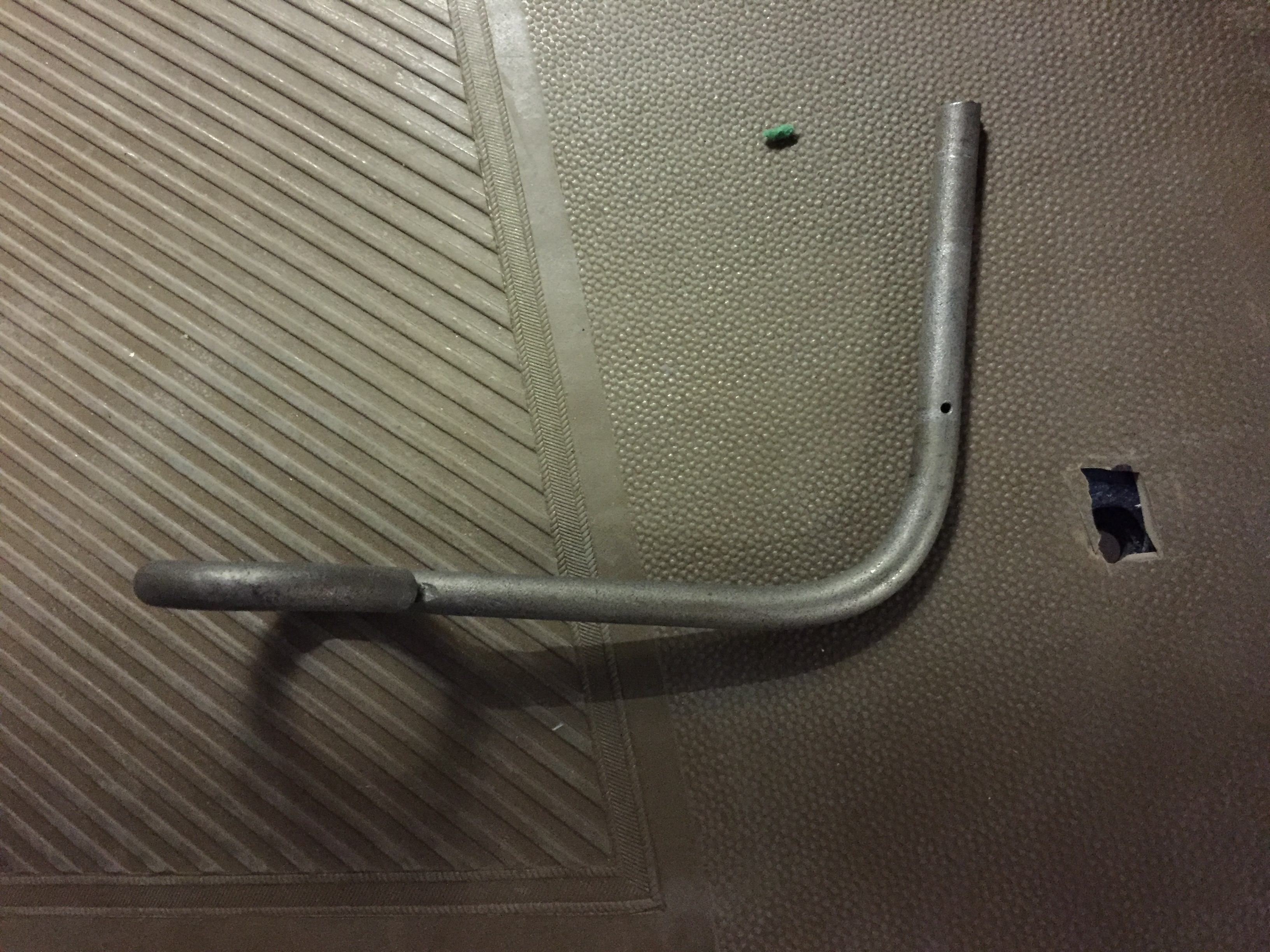

Gregg, thanks for the photo. Now I know what parts I'm missing. Like they say, a picture is worth a thousand words. Thanks again, Jakes. Oh by the way, I tried to send 2 photos of what parts for the seat I had and only the seat lever photo showed up on this forum. I guess you are allowed only one photo.
