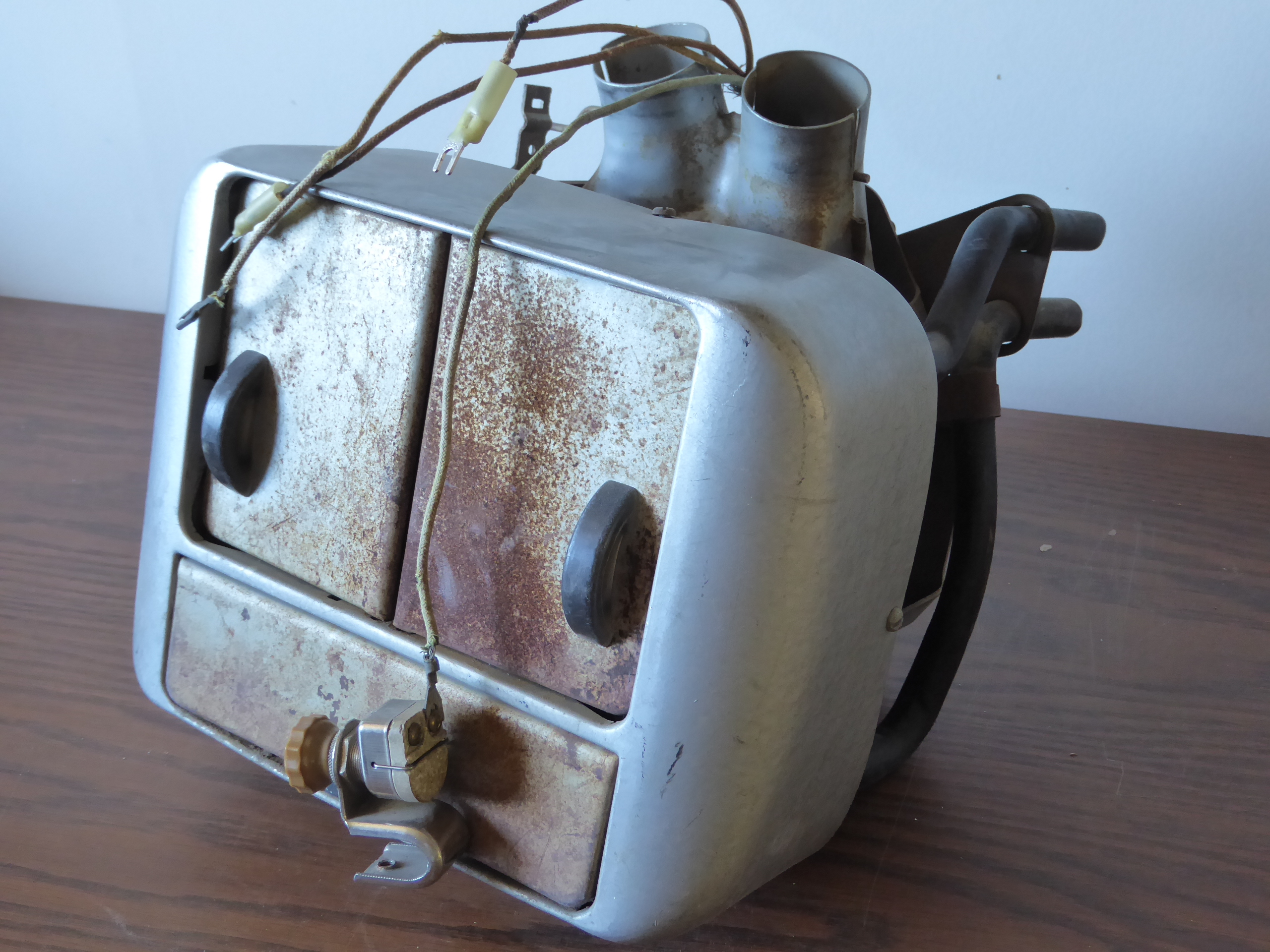

Thanks for the great help in your replies . As requested here is the photo the heater and switch.
TomO |
07-08-2018 @ 11:08 AM
Posts: 7386
The heater is a 46-47 heater with a reversible motor. The switch is an aftermarket switch made for a single direction motor. Here is how I identify the wires: There are 4 wires coming from the motor. The yellow and the green wires come from the field windings and the red and brown wires come from the brushes. If your colors have faded so they all look yellow, I use an ohm meter to make an initial guess as to which wires are from the brushes and which wires are from the field and then I use a battery hooked up to a switch to determine which of the wires used for forward and reverse direction of the motor. Usually you can see a little of the green cast on the green wire and the red color on the red wire. If you connect your ohm meter between the green wire and the yellow wire, you will have near zero ohms resistance. Any other wire will show an open condition. The reading will not vary when you rotate the motor shaft. When you connect the red and brown wires, you will have more resistance than the field connections showed and it will vary slightly as you turn the motor. Three of the wires from the motor will be attached to the switch according to the colored dots next to the terminals on the switch, the green wire will be attached to ground and the terminal with the black dot will be attached to a 6 volt source. The red and brown wires control the direction of the motor. When the switch is in the HI Direct position the fan should be blowing air through the heater core. On 1940 heaters this means that the motor is turning counter clockwise.
