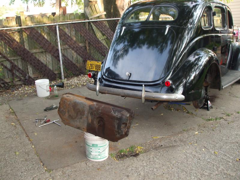

Zero
07-08-2018 @ 7:07 PM
Posts: 63
Joined: Jul 2018
The tank came out today. As Tony mentioned the filler neck was the hardest part. The spanner wrench was a great tip. Alan, thanks for that.
This tank has been out once before because there is a big patch on the top. From the looks of all the crud on the bottom of the tank, it could have been a DIY cleaning and seal job gone bad. I don't think it's worth trying to save. The cost of getting it cleaned and sealed is almost the same as a new tank.
Any recommendations for a replacement tank?
Again, thanks for all your help and tips.
