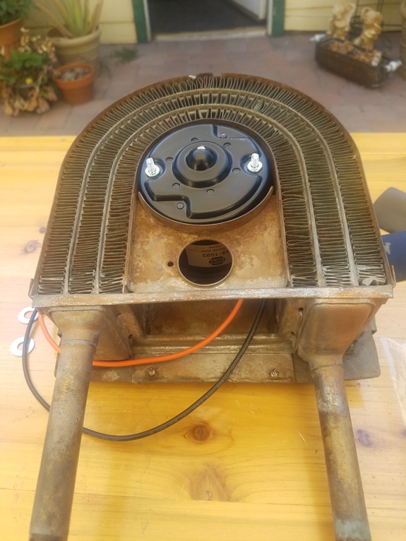

tight fit

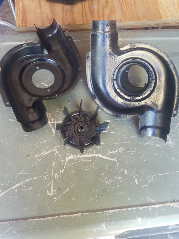

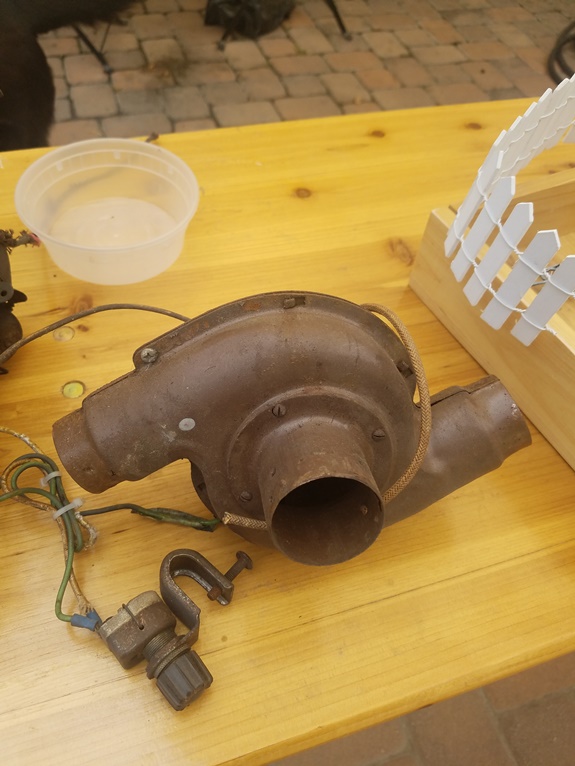

More photos

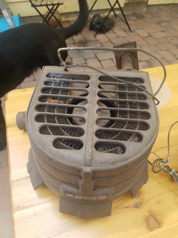

before photo

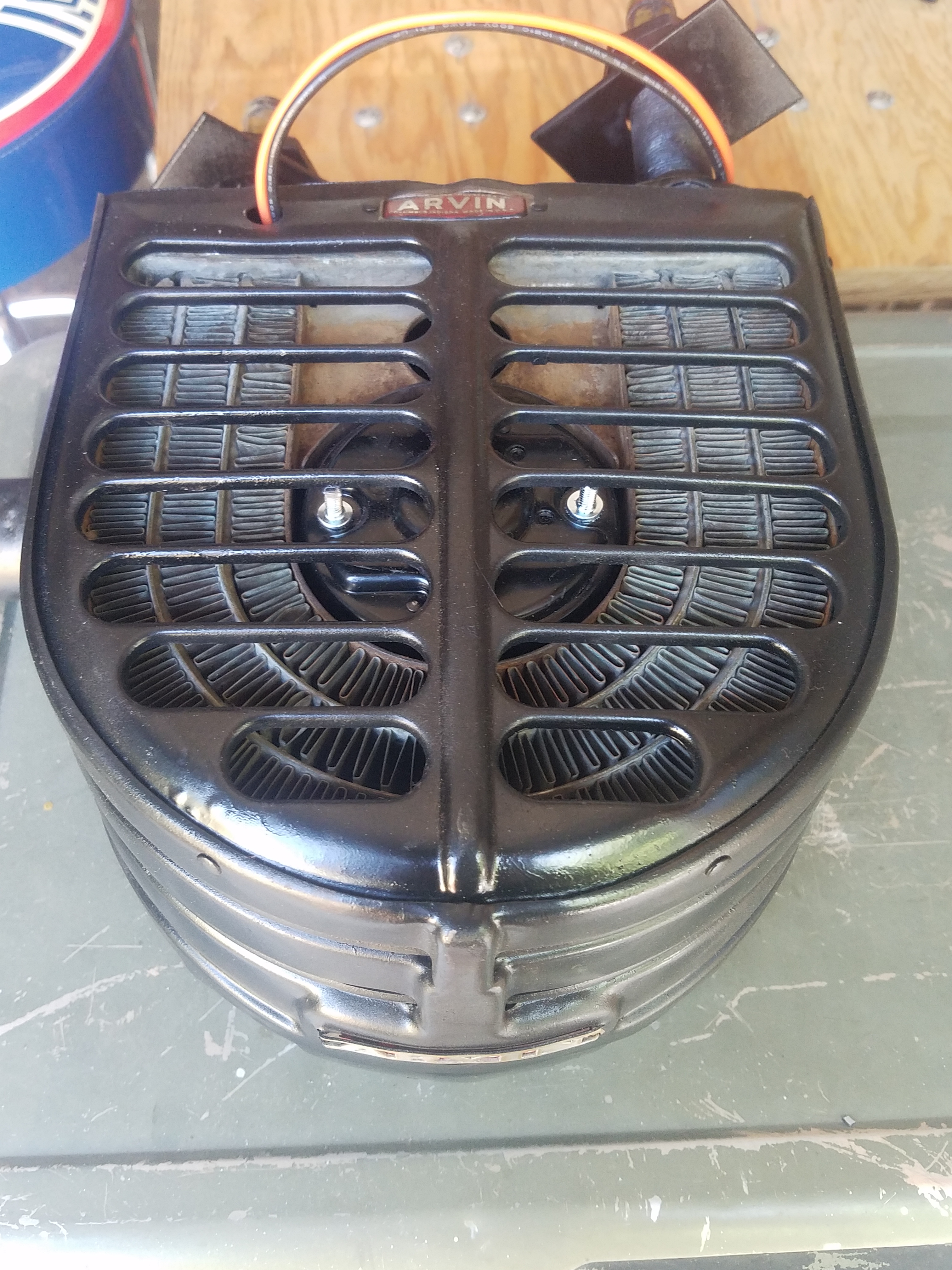

Ok... got the motor into the housing.. here are some before and after photos.. And before you ask why I didn't repaint the housing with hammer-tone paint as original, I had some left over high temp paint from a wheel hub project..

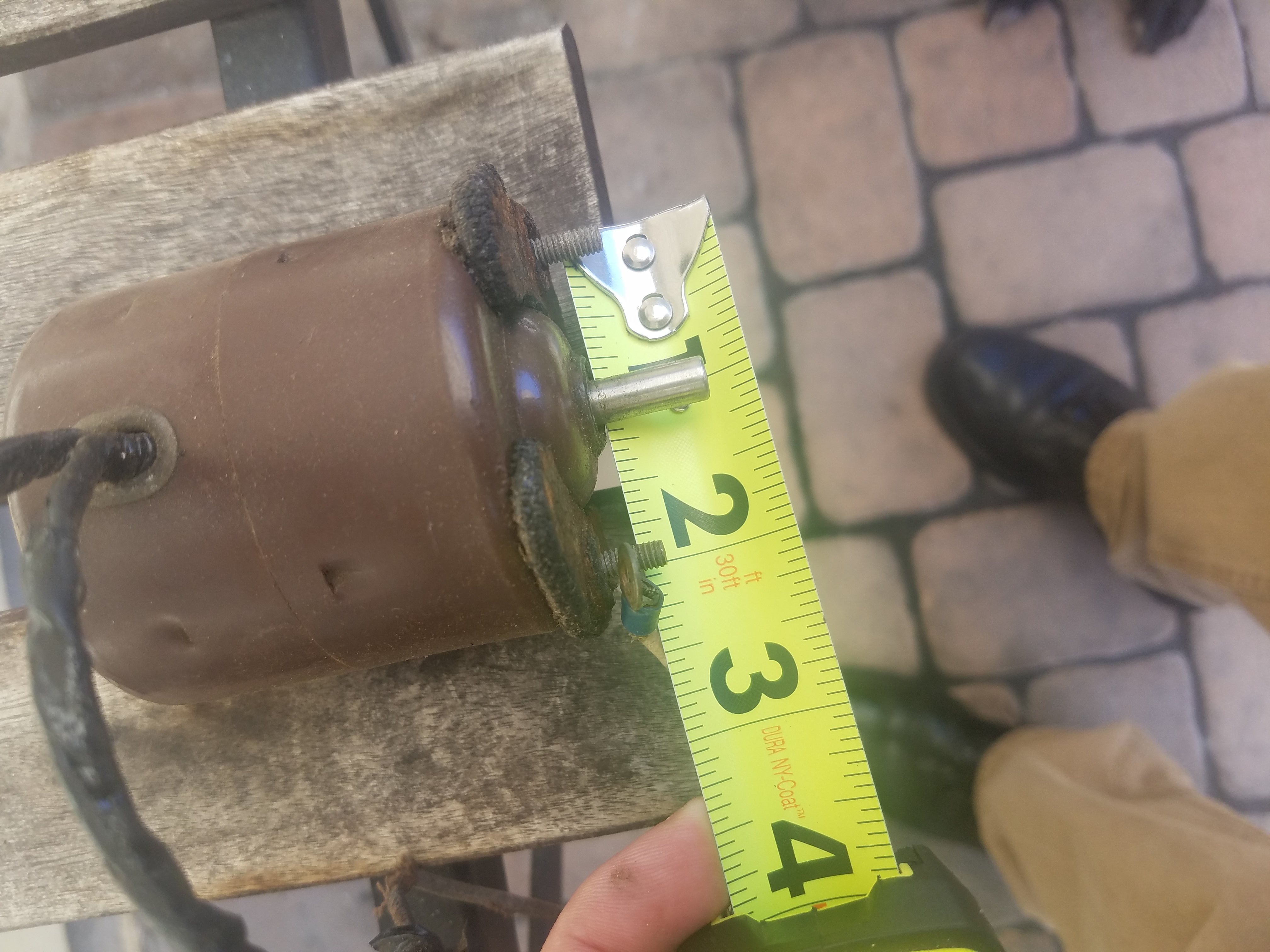

A generator repair shop wanted $400 minimum for the re-winding..
I took advice from my same post I made here.. on the Fordbarn.. And I got a motor that fit from NAPA part no. 655-1022.. 12volt.. however the distance between 1/8 inch mounting bolts is 2 5/16ths..and overall diameter of the body is three inches.. with 1/4 inch shaft.. luckily the heater core housing actually had two extra mounting holes for the wider 2 5/16th mount.. and the cavity was just over 3 1/4" inches.. so it fit.. but... just barely... $39.14 out the door at NAPA.. I will take photos of the R&R when I can..
