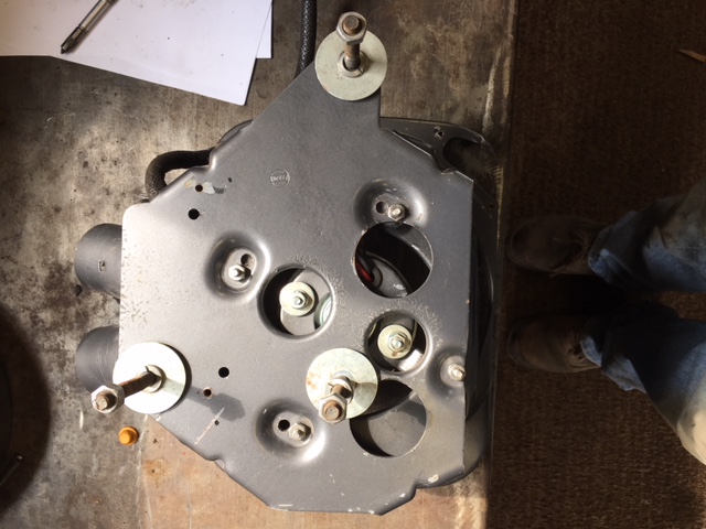

I just happens that I have the heater out of my '46 right now, and could take some measurements for you if you have not found anything so far. I don't know how many variations there were of Ford or aftermarket heaters are out there, but mine has EATON stamped in the backplate that mounts to the firewall. When I had the heater disassembled, I found a label on the fan motor (nonstock I believe) that identified it as made by Dayton Electric Mfg. Chicago, 6V, Model 2M196.

The heater in my 47 is an Arvin.. I have it out now.. repainted & cleaned up... but I can't seem to find a new 12 volt fan motor to replace the 6 volt one.. any suggestions? 1/4 inch shaft, 2 1/4 inch distance between each mounting bolt

12 volt fan motors are in most parts catologues I have,the 6 volt ones that are hard to find. Is your car converted to 12 volts??

Yes.. I found a motor from NAPA..
