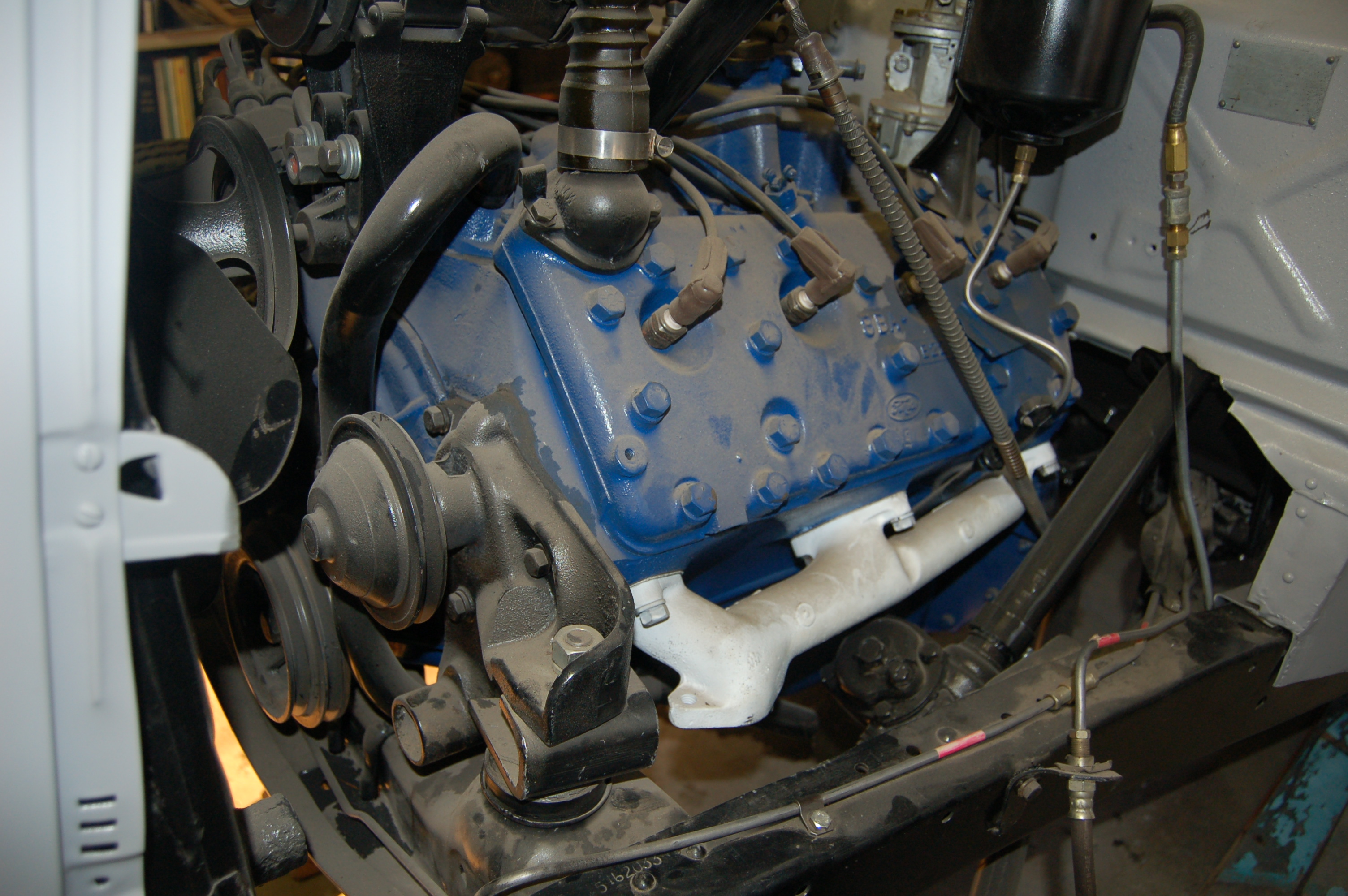

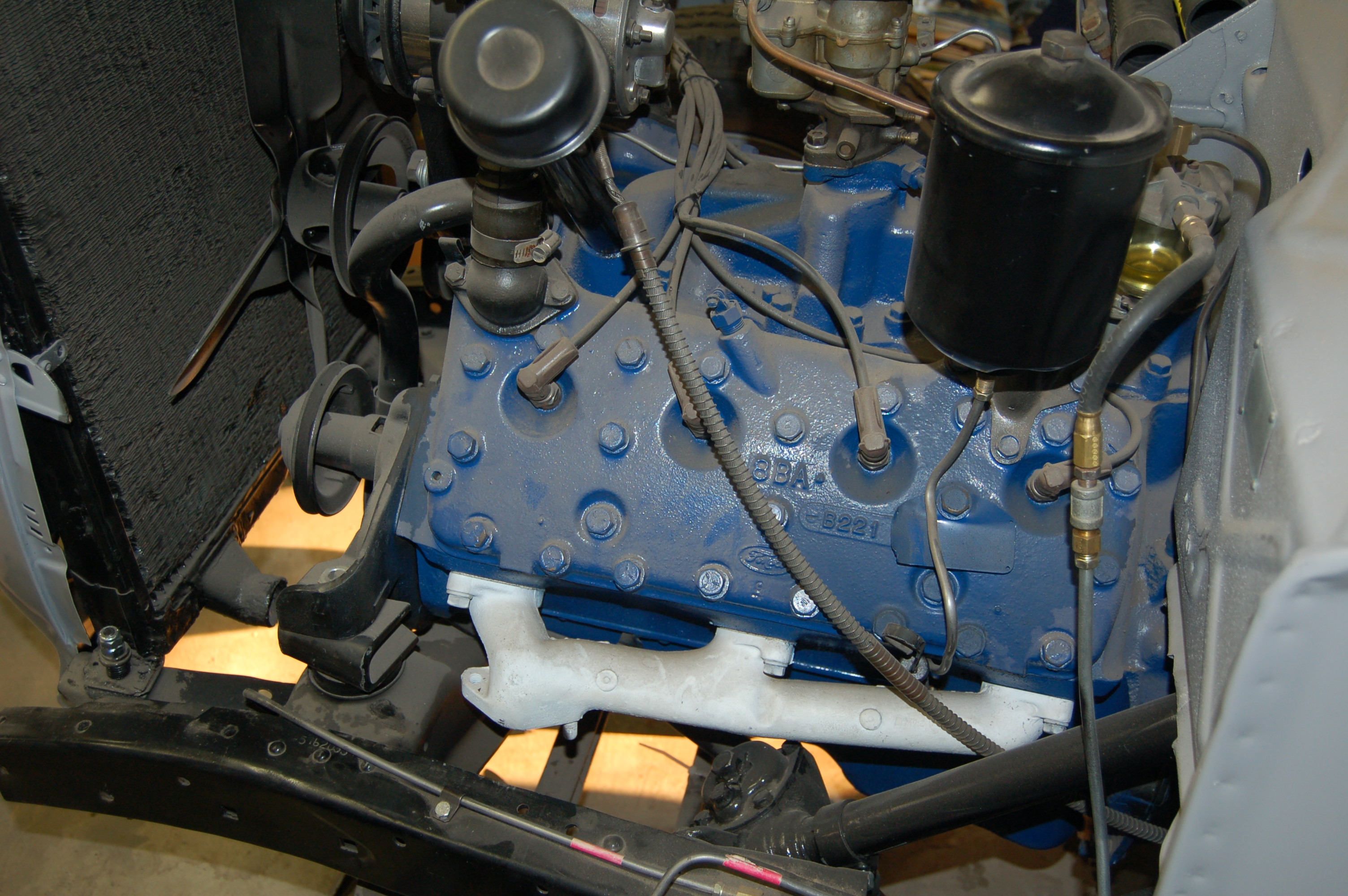

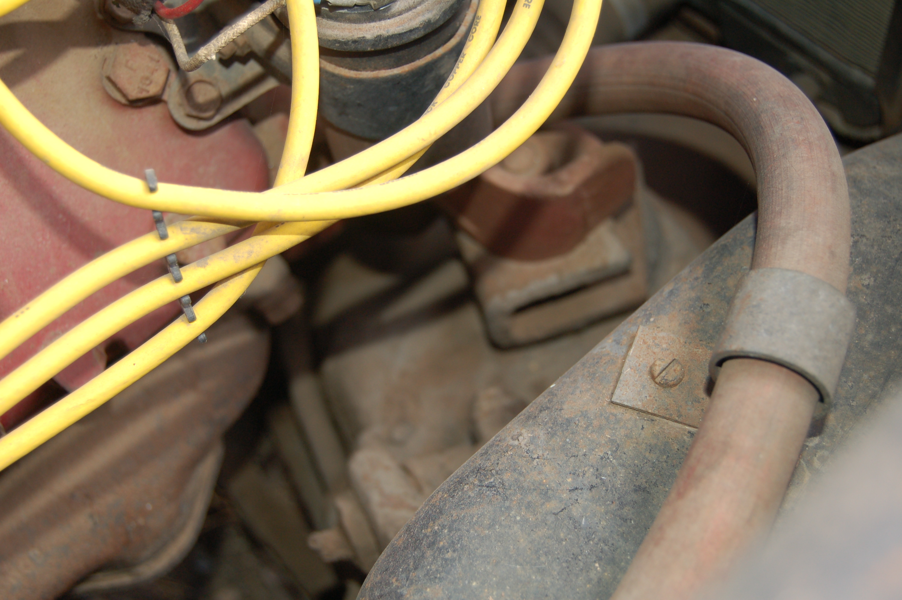

Many years ago I put an 8BA engine into a '36 Ford 1/2 ton pickup. We used the '49-50 Merc water pumps and merc motor mount spacer blocks. Had no trouble mounting the stock 8BA Fan. A friend of mine has an 8BA engine in his '37 Ford pickup, my friend used the same merc pumps and engine mounts, with the 8BA fan. Pix of my friends '37 w/8BA attached.
