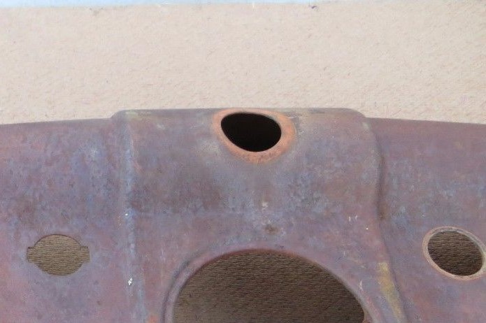

Thanks for the reply. Have done some more research and I may have identified the problem. Attached is the mounting area of my dash with a lip protruding outward where the windshield opening handle goes in. My next post will show a photo of a dash on Ebay with the lip missing
Sneezer |
02-16-2018 @ 8:12 AM
Posts: 63
Joined: Aug 2016
Here is the Ebay dash photo with the lip missing. The waterfall would probably fit flush on this dash

You may have a 36 WF trying to go on a 35 dash. The 35 WF may have a recessed area around the backside of the hole to allow for this bump on the dash you have. Or possibly someone installed the wrong dash on your car. ??? ken ct. I have a 36 for going on 30 yrs and know it pretty well. Mines not at my place so I cant check it easily.

That bezel or lip is used on standard model vehicles that did not get a waterfall in production. That piece needs to come off if you want to install a waterfall now. The 35 vs 36 waterfalls are slightly different as Ken already mentioned, but if you are not concerned about correctness, either one for a closed car will work.

I see said the blind man. Just took a good luck at my dash and I now can see that the circular protrusion is a separate piece. Appears that it will simply pop or pry off. will give it a go tomorrow. Thanks for all the help guys. Regards: Arnie
