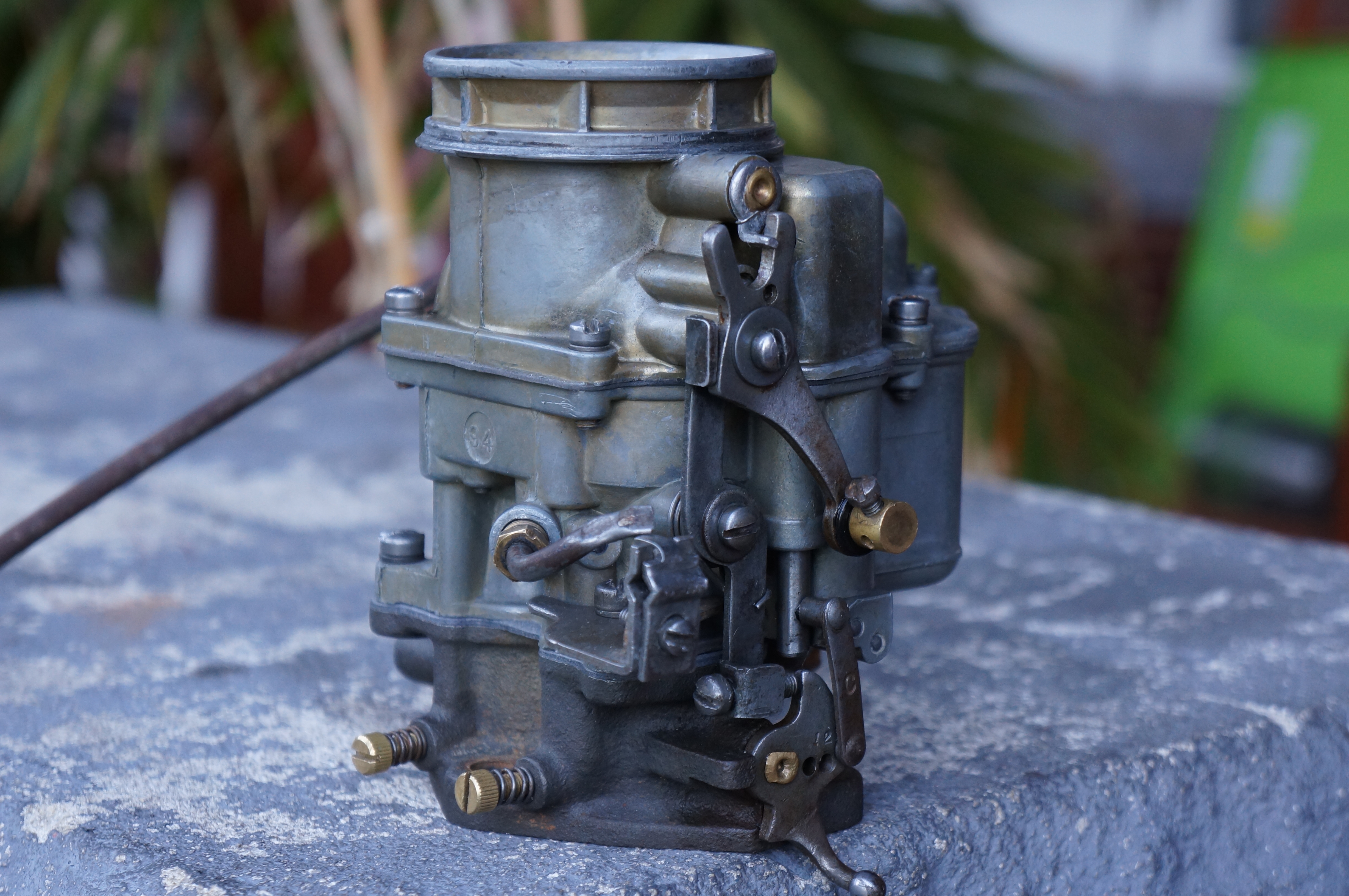

I use a carb cleaner I purchased at NAPA. I just looked but the label is illegible so I can't give you the name but it is the only one they sell in Canada and it cost about $40 a gallon. After 4 hours in the tank your parts will be very clean. Get some good gloves as it smells nasty will burn the heck out of your hands. Here is a picture of my carb after a dip in the tank. It can be reused many many times before the cleaner must be replaced.

01-05-2018 @ 7:14 AM
Posts: 1979
Thank you Matt. That is the way I want my carburetor to look!
