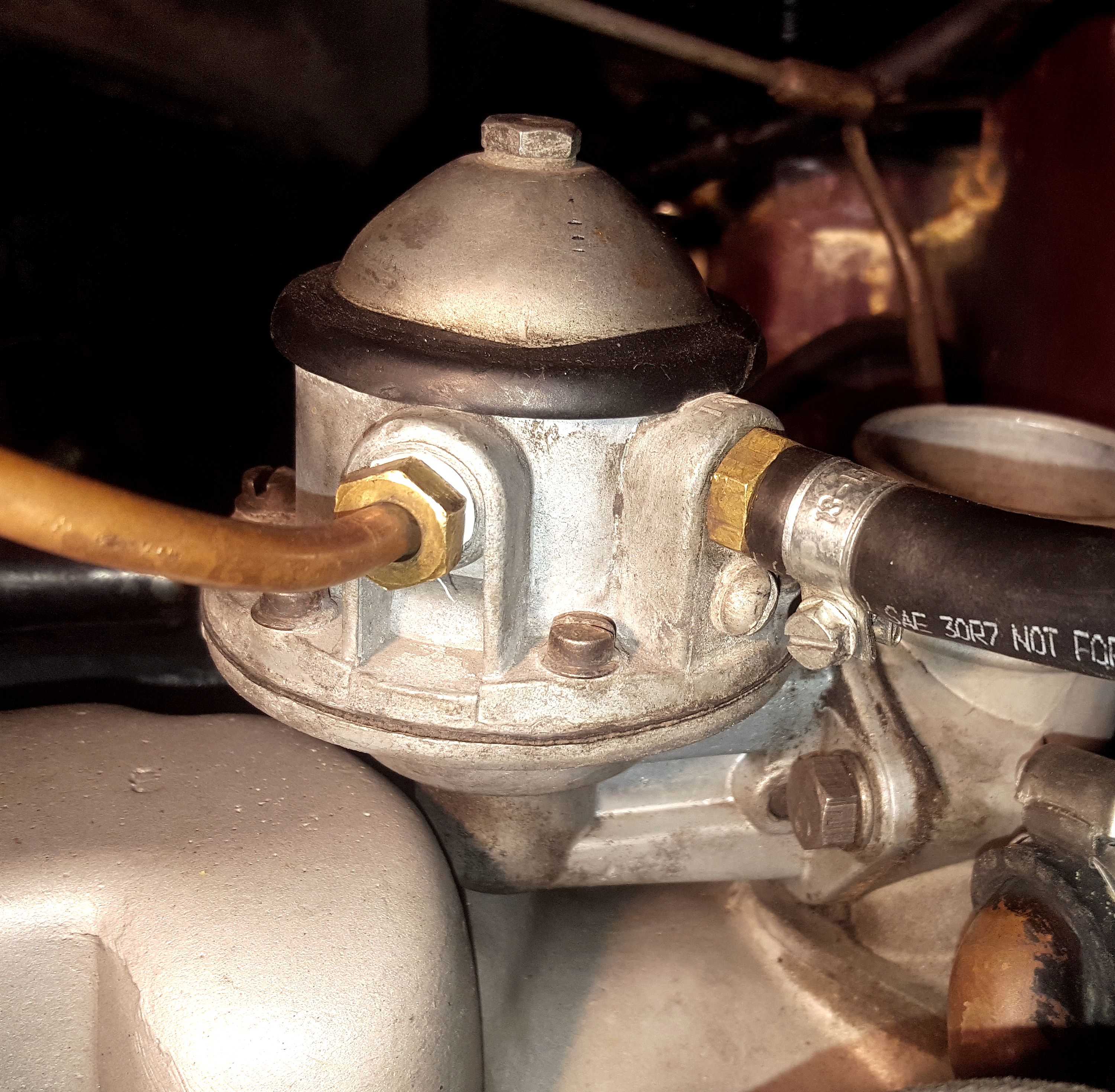

This is how it was when I bought the rig back in 10/17. I am in the process of eliminating the "Gerry Rigged" stuff as I find it. I recently ordered a OEM flex line from firewall to pump and OEM hard line from pump to carb. Hopefully whoever put that bottomed out fitting in the pump didn't damage the threads or the seat in the pump!

A big no on Teflon tape or silicone sealer.

That is not a correct pump for a 37 in the firstplace.Thats 41-46 pump. Another thing the gas line fittings look like their bottomed out against the body and will not seal,also get rid of what I think looks like Teflon tape on one of the connections,never use it on gasoline fittings. ken ct. email or cell 1-203-260-9780 // I can explain better on phone.
12-31-2017 @ 9:04 AM
If you want your car point judged, get the correct 1936-1940 fuel pump. If your car is going to be shown in Touring class, either the current pump or one with a glass bowl would work. In either case, I would replace the line coming into the fuel pump with the correct line.
Your pump has a sediment bowl, just remove the top cover to see the contents. Before you do this, order a couple of gaskets from Ken CT.

Yes that would be the way to go with a glass bowl pump, would not be correct for 37 but would solve your problems. I think I have 1 left in stock @ $50 plus $10 shipping. I am retired from rebuilding them but think I have 1 in stock. All USA made parts. Not like the cheap junk coming in from China as new pumps. ken ct.
