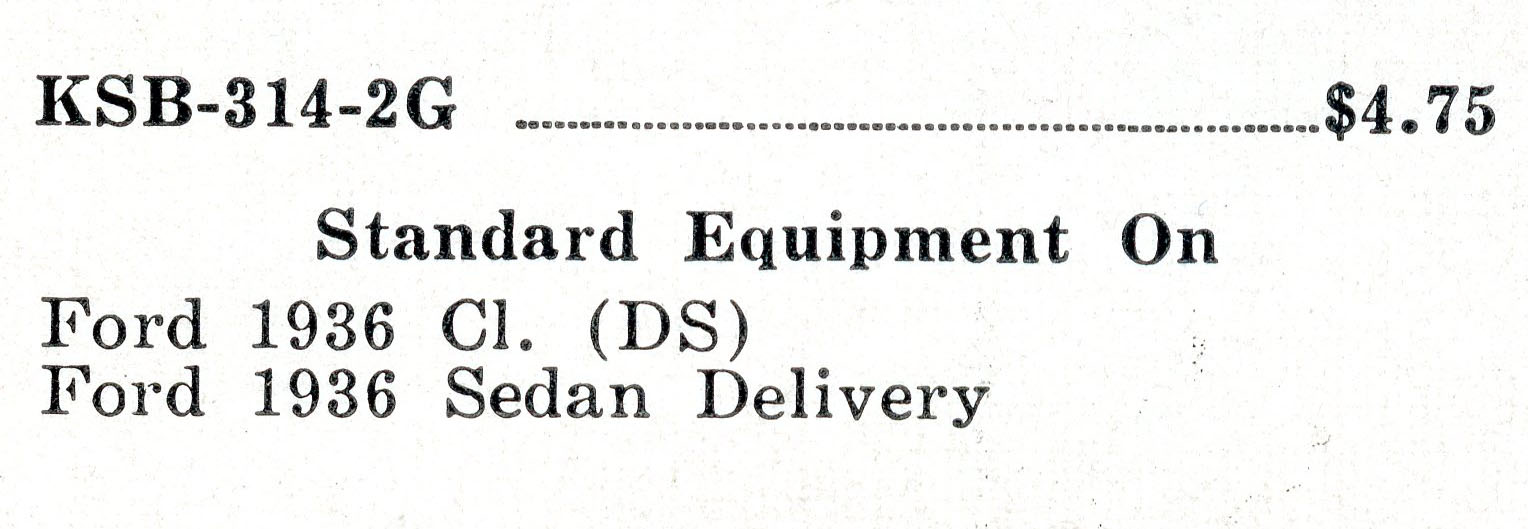

Don Rogers |
12-03-2017 @ 5:10 AM
Posts: 512
Tom, I have 3 sources that indicate KSB-314- 2 or 2G is correct for 1936 Ford closed cars. See next 3 images

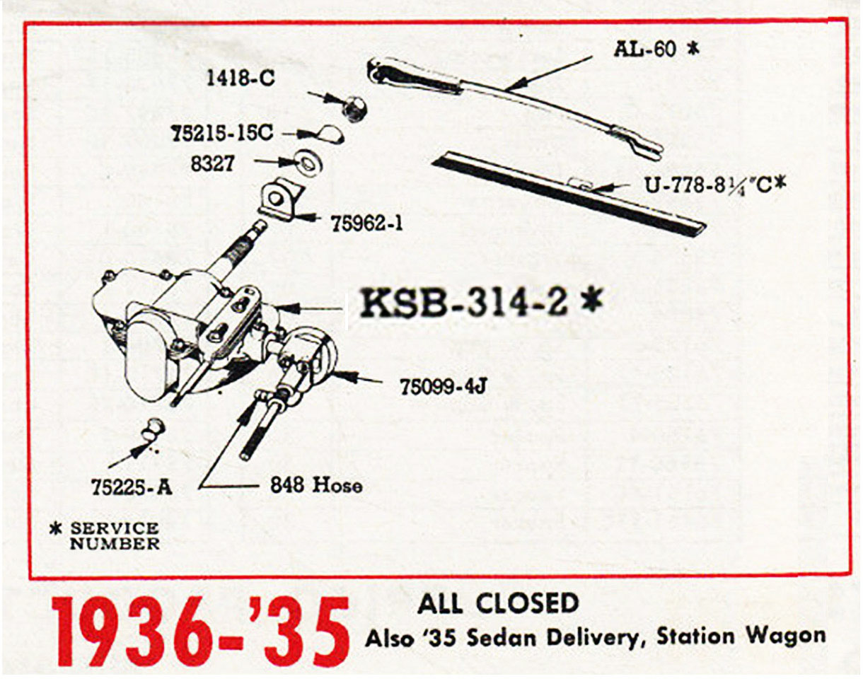

Don Rogers |
12-03-2017 @ 5:11 AM
Posts: 512
second image

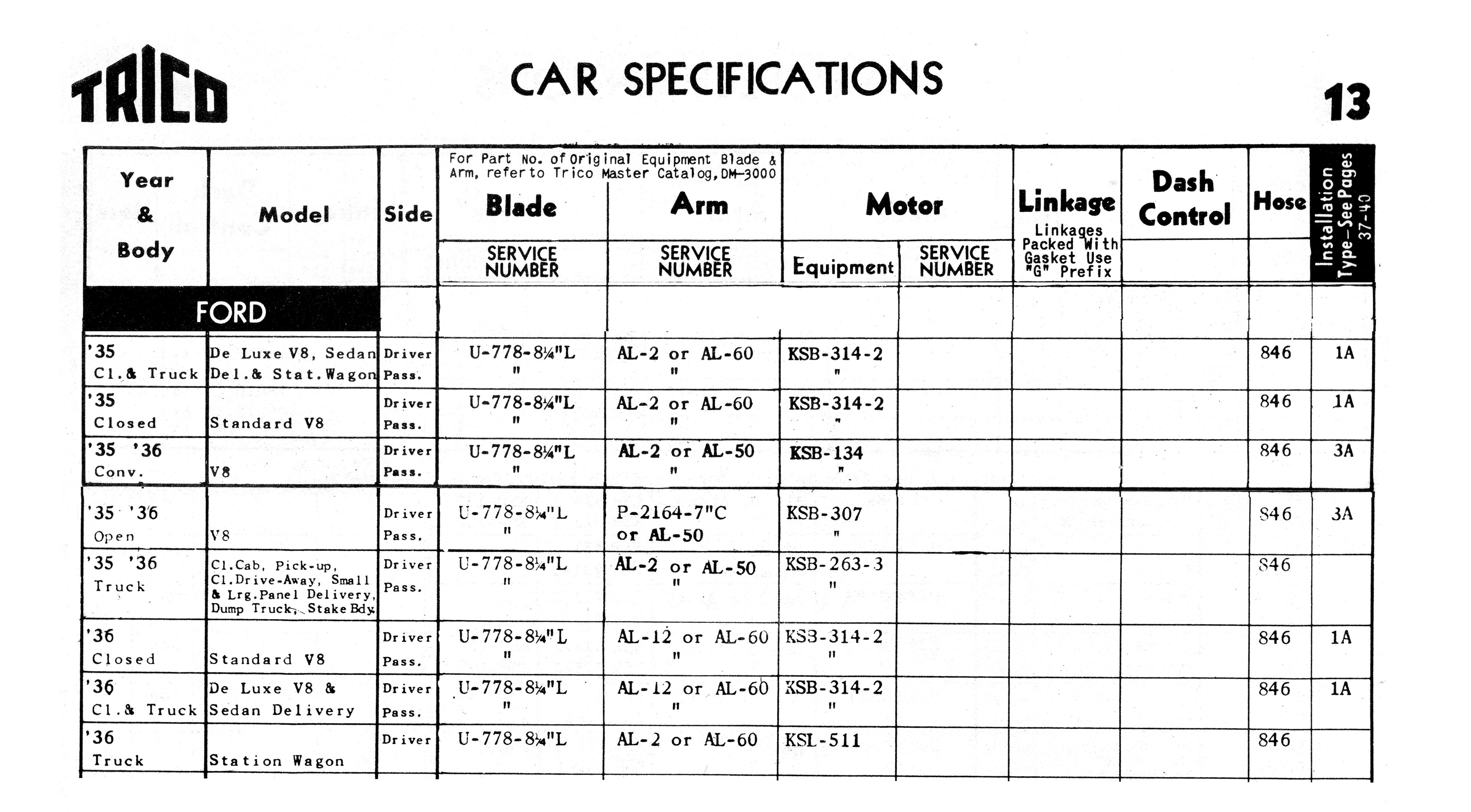

Don Rogers |
Posts: 512
Third image
flatheadfan |
12-03-2017 @ 7:26 AM
Posts: 450
Don- I have no disagreement with KSB-314-2G being the correct wiper motor for a '36 but in an earlier posting you said a KSB-312-2G was the correct one. Was this just a typo error or some sort of alternate wiper? Tom
Don Rogers |
12-03-2017 @ 9:07 AM
Posts: 512
Sorry Tom...My original mistake just blew by me and your correction did as well. I never realized that I had typed 312 instead of 314. My senior moments are getting closer together!!!!!!!!!!!
