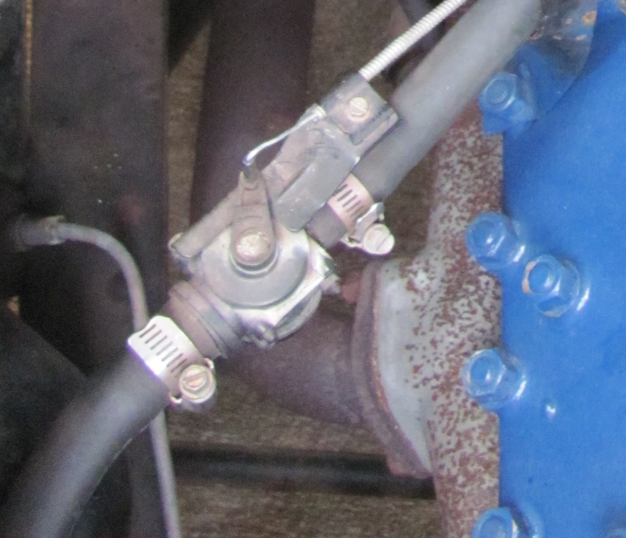

My '47 has the traditional manual on-off valve you talk about on the passenger side head but it also has an aftermarket flow control valve (photo) in the return heater hose between the heater core and lower radiator hose. It is operated by the choke cable with knob next to the heater switch. It permits reducing the coolant flow or turning it on or off. I understand this type control kit is still manufactured (don't remember who).
Personally, considering the relatively small quantity of fluid the heater circuit contains, I doubt whether having the heater flow circuit turned on or off affects engine performance. The engine-radiator coolant temperature should be unaffected and only in a minor way if the heater fan is running.
I usually leave the coolant circuit turned on, mostly because (1) I forget about it and (2) I don't notice any heat coming from it without the fan is running.
