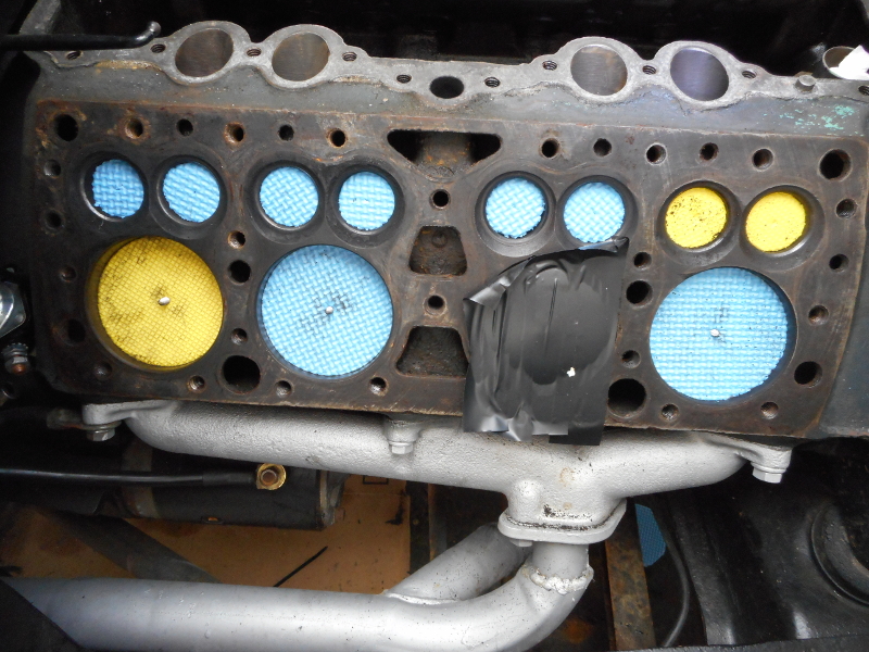

I forgot to mention something I did to prevent dirt from getting into the piston bores when cleaning the block face. I bought the 1/2" thick Foam Garden Kneeling Pads you can find in the Dollar stores and cut some over sized plugs (using a compass) to seal up the valve and piston holes. It worked really good keeping out all the scr*pings and when done you just vacuum the debris and lift the plugs out (starting with the valves) and any residual debris gets pulled out with the plug. The holes stayed nice and clean. Hopefully you won't tell me the foam will eat the block but maybe it will help others in the same situation as me. Attached is a picture. Note that one piston was taped but I later just moved the pistons so all 4 cylinders could hold a plug.

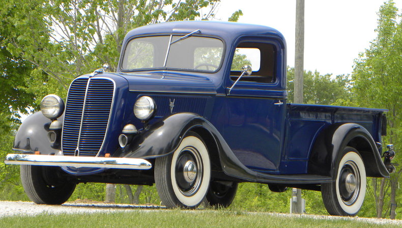

I don't think this old truck will be at the Nationals or any judging shows any time soon. As the saying goes "It looks good from afar but is far from good". Still needs lots of work to make it a reliable driver.

I don't think I ever attached a picture of the truck so I will do that. Maybe someone out there will recognize it and know some history. I think it last lived in New York State but I bought it from Illinois.

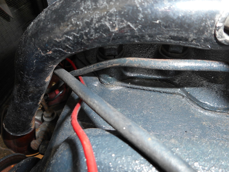

You do good work, Charlie. I am glad that the engine is working good now.
It may just be the angle of the photo, but the cable from the starter switch to the starter looks like it may be too small to carry the current needed to crank the engine. It should be either a 0 or 1 gauge and it looks like a 5ga or 6ga.

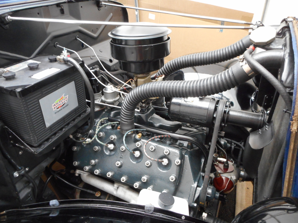

UPDATE: 7-31-17
Well guys, looks like problem solved thanks to the guys on this forum who responded to my questions including JayChicago, Coup, 40Cpe, and especially Pauls39Coupe and TomO. TomO called it in his post of 6/15 that the valve springs were the wrong ones! Thanks again for all your great help!
Here are some more things I found since my last post:
When I pulled the driver’s side head which had a mix of Grade 8 and Grade 2 bolts I found antifreeze between cylinders 6 & 7 on the head and head gasket. The bolts were very easy to remove so I think they were not properly torqued or the grade 2 bolts lost their torque.
The heads were not mounted on the correct side of the engine. Doing some research it looks like the 81A-6049 head has a combustion chamber of 79cc’s and should be on the passenger side and the 81A-6050 has a combustion chamber of 81cc’s and should be on the Driver’s side. I measured the depth of the recession for the intake valves on both heads and verified that they were indeed different. Also, when mounted correctly the P/N on the head should be next to the fuel pump stand. I installed them on the correct sides.
I replaced the bolts with studs and nuts from Roy Nacewicz and after much searching for NOS valve springs without any luck I went with new valve springs, keepers, and valve guide seals on the intake only (they were on both the intake and exhaust when removed) from Mac Van Pelt.
I modified the cooling to the heads per TomO’s recommendation on 6/20/17 and flushed the heads and block. Reassembled valves, adjusted valve to lifter gap to .011” intake and .015” exhaust. Used Best Head Gaskets (59A Type, P/N 511G) and Intake manifold gasket bought at Mac Van Pelts, installed the heads and torqued per Tom’s post of 6/20/17.

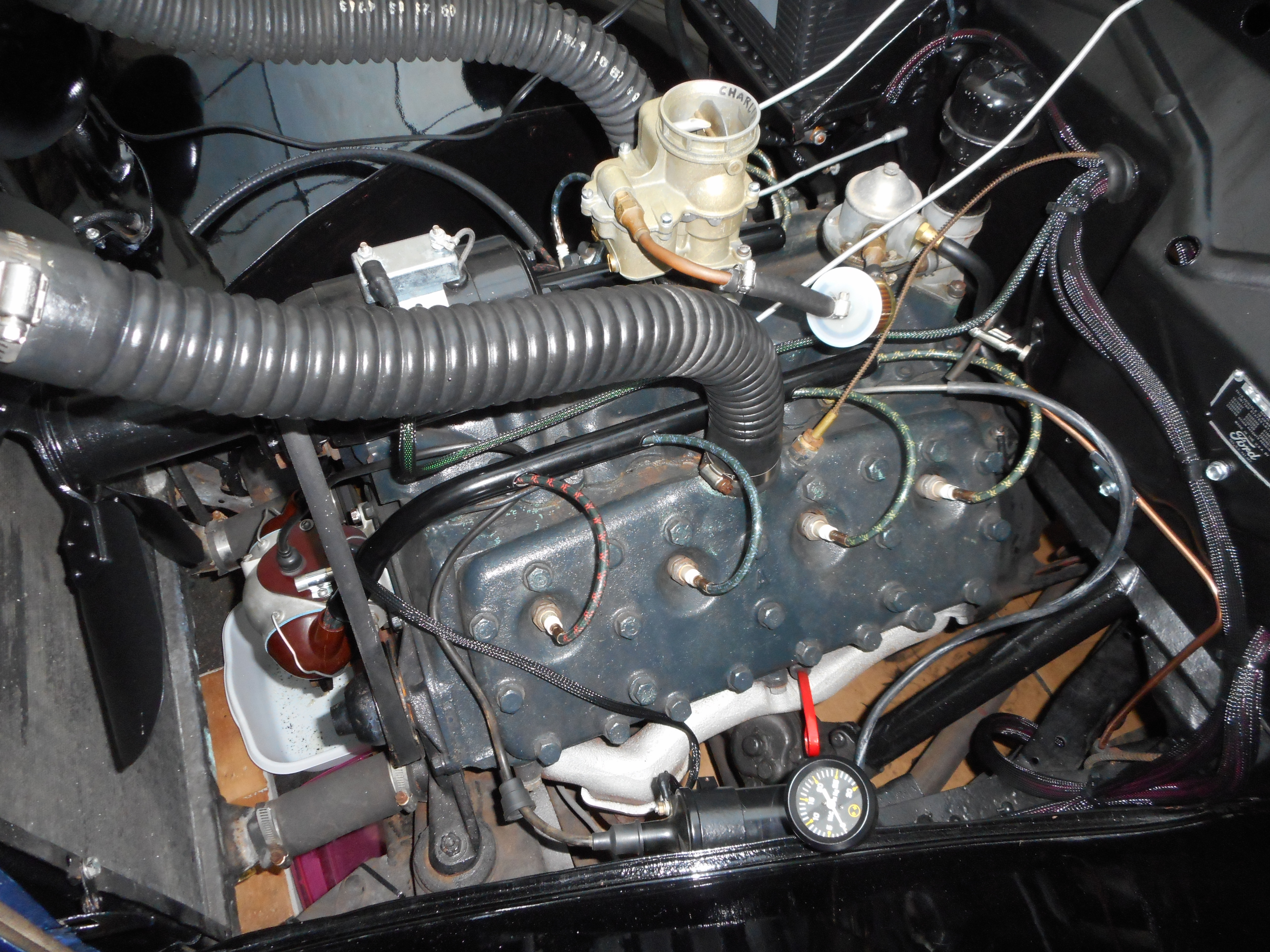

Reassembled the rest of the engine, changed the oil and antifreeze and started it up! Now runs smooth and quiet and starts on the first push of the starter. Checked the manifold vacuum and it reads exactly 20 inches Hg and is rock solid! Measured the temperatures of the heads (~166 Deg both sides) bottom radiator outlet (~128 Deg) and top Radiator inlet (~160 Deg) with an Infrared Thermometer just to make sure nothing got blocked.
Attached is a picture of the completed engine and if nothing else it looks pretty good.
So now that the engine runs, it's on to the brakes to make sure it stops. Someone changed the mechanical brakes to hydraulic brakes but left out the emergency brake and handle. Will have to figure that one out after pulling the rear drums to take a look.
Thanks again for all your help, for without it, there is no way I could have solved this problem. It’s been a great learning experience!! Stay tuned for brake questions!!
