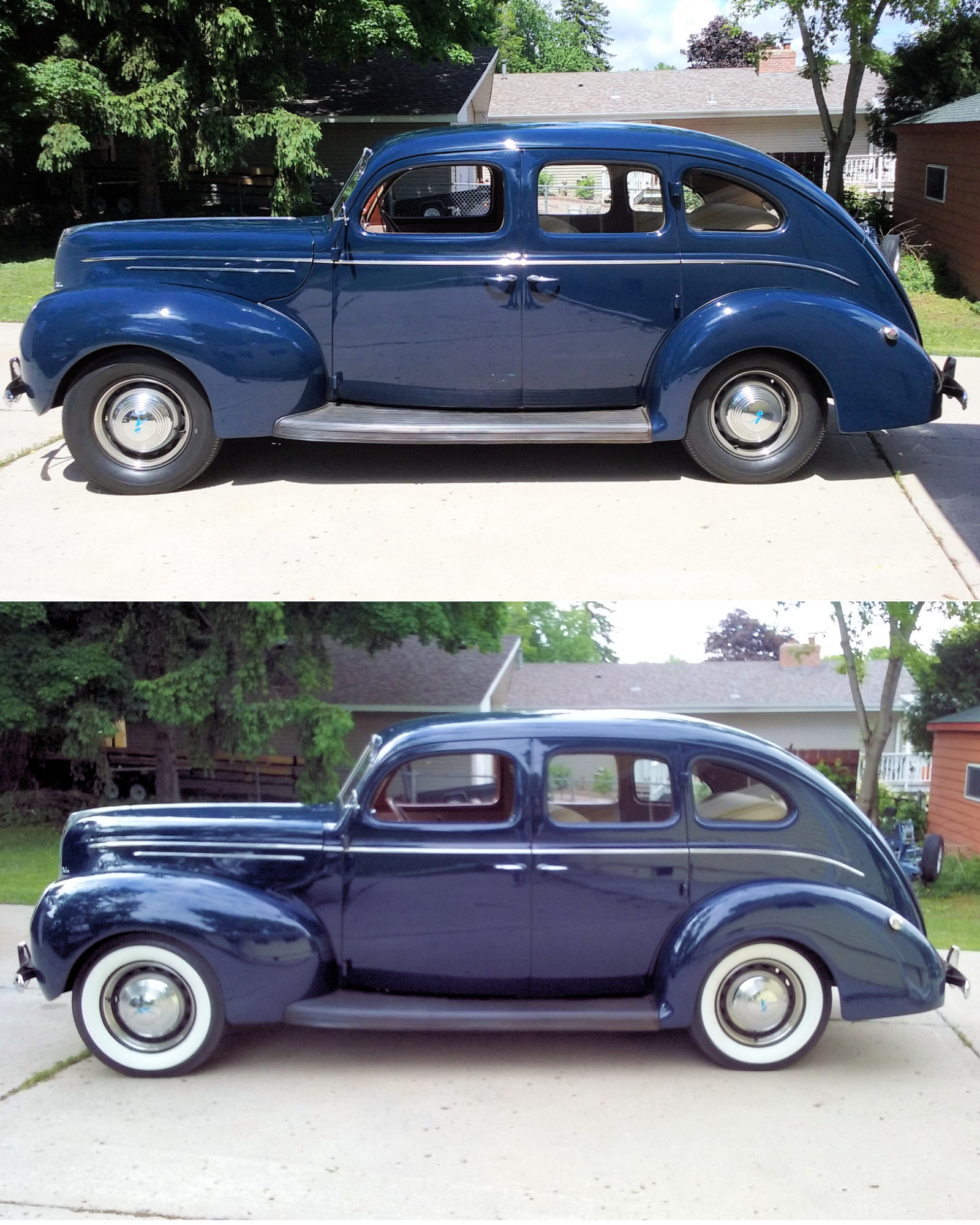

I have been running Bias Ply Firestone Tires on my '39 Deluxe and I am looking at purchasing a set of Diamondback Radial Tires. These tires are marketed as Auburn Radials with a "Piecrust" Shoulder designed to look like Bias Ply tires as opposed to the rounded radials that tend to give what I would call a "Rod" look. (See Picture Below.) Just wondering if anybody has tried them out yet and what your thoughts and opinions are on them? I haven't seen a counterpart from Coker, but wondered if people have opinions about them as well. Also wondered if there is anything I should know about converting to radials? Thanks!

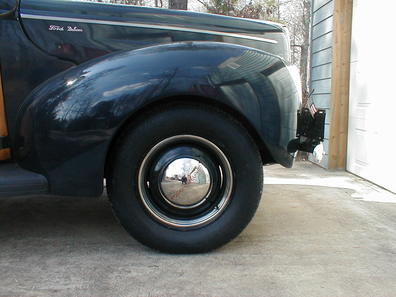

I have been running an Ecopia radial on my 40 wagon for close to 5 years. these are actually Firestone/Bridgestone tires 195R8016 I think. these are for an electric car and are high pressure 40 lbs tires.

Thanks for your replies Car Crazy and Alanwoodieman! I read a thread about those electric car tires. I think you are correct Alan, 6.00 X 16 Standard US equates to 195/80R16 metric, which is the size mine takes too. Sounds like they have been performing well for you. Thanks for sharing a picture of them! Car crazy - I certainly can appreciate the vast difference in performance between Bias Plys and Radials, I was hoping to get both the look of Bias Plys, but the ride and handling of Radials. I talked to a guy at Diamondback and he said even though these have the "Piecrust" shoulder and look of Bias Plys, they are radials. And they behave and perform like radials even though they look like Bias Plys. Are you saying even though these "Piecrust" tires are radials, the more rounded type radials will perform better? Thanks!
