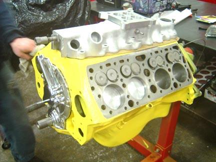

Sorry to be late with this info. The manifold shown is a vintage Edmunds piece. The carb is a 300cfm Holley with a mechanical secondary. You will note that the engine has the later "posthole" distributor, so vacuum for the advance is drawn from the carb. To fit the 4 bbl carb to the old manifold, we had to make an adapter. Flathead 4 bbl manifolds are available from a number of sources that will not require an adapter. The venturis in the 300 cfm carb are very small, allowing good low end performance. When at speed, the secondaries open when there is adequate manifold vacuum to to prevent swamping and loss of power as the carb capacity increases.

Here is another view.

I still haven't had time to look up the carb and manifold, but will do so ASAP. We have always used progressive linkage on multiple two barrel carbs to prevent too much intake all at once. I've attached a pic of the hot rod engine we built with the 4 barrel that works so well.
