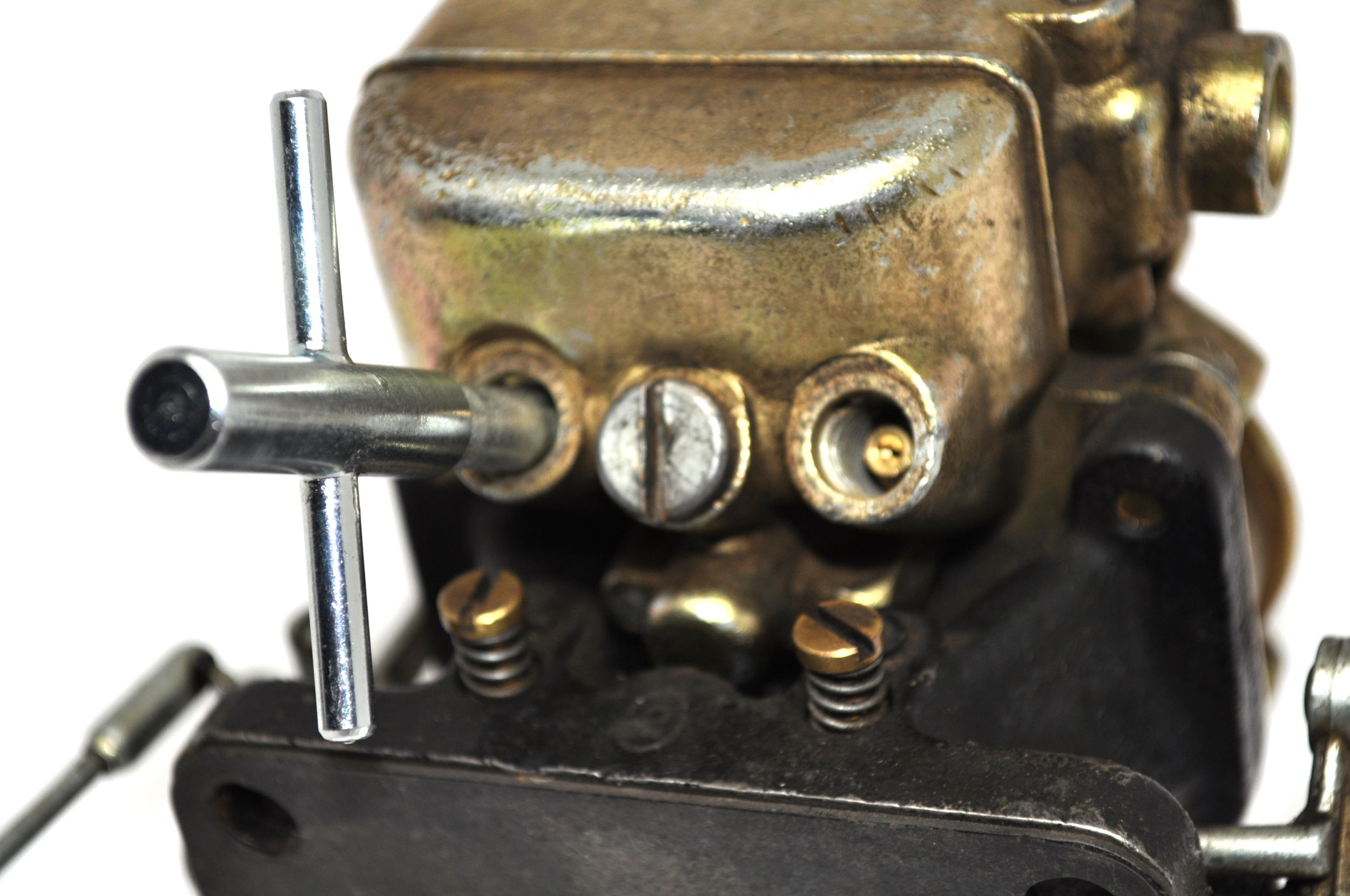

Another reason for the fondness of 97's on the part of Hot Rodder's, is the ease in re-jetting without having to "open-up" the carb. On modified multi-carb engines; the use of racing fuels and widely variable operating conditions often require frequent main-jet changes. A Stromberg can be re-jetted with just a "jet-wrench" through the access ports on the lower corner of the float bowl. In additon, replacing the float needle and seat can be done from "outside" the carb.
