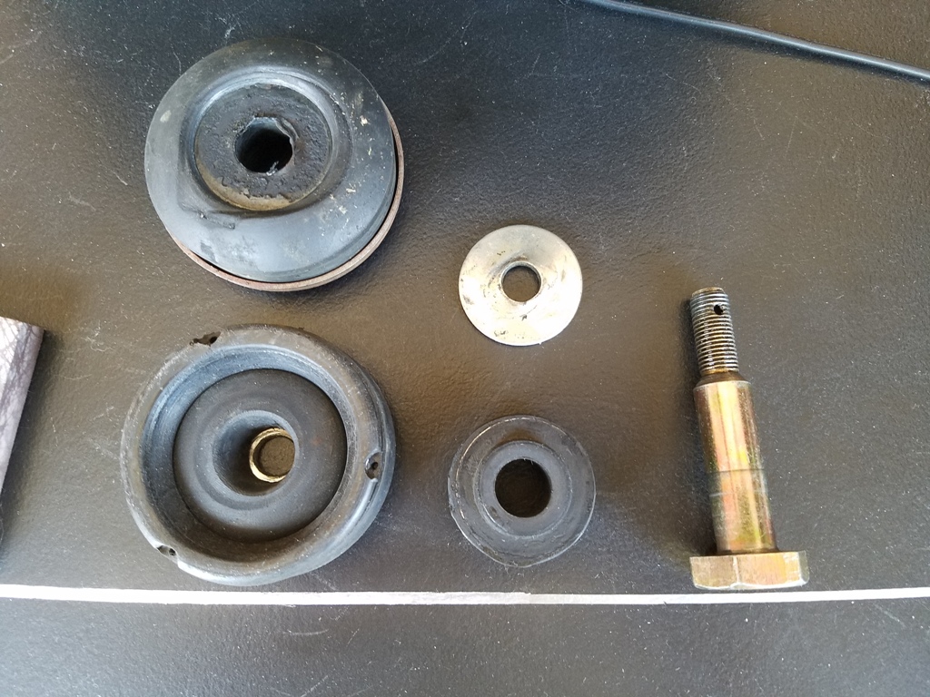

Ok guys - I've now confirmed that what's been on the car for 2 3/4 years or so is incorrect for the '47. The bolt shoulder length is off/too long by 1/4" and the thickness of the top bushing without the washer is shorter by 3/16", both versus what are currently available from all sources. Apparently some 'universal' part was pulled and shipped to me - I clearly never compared the pieces to the original but assumed they all were correct, freezer-bagged my old mounts for storage and inserted the new ones. This answers several questions that I've had for a while.
So - motor mounts. Carpenter or Drake? It appears Mac's cobbles theirs together from other sources. C&G appear to get theirs from Carpenter. None of them are completely identical to the originals. Thoughts on quality and your personal experiences on this part from either source appreciated.
Chase one problem and find 2 more...what were we talking about here originally anyway? Oh, yeah - clutch chatter. Back to that later...
Steve

alanwoodieman - a pic of all the mount parts is below, I removed them in their entirety today. I am talking with the supplier now. Thinking is twofold here - they supplied me the wrong mount all those years ago even though the paperwork shows the correct part number. Note the underside of the top bushing displayed - I cannot recall if it was like this originally. None of the current sources, nor the original bushing, are 'inverted' like this and if they did in fact 'pic' the wrong part it likely has failed over the miles and reduced the overall height of the top bushing which consumed, as it failed, the bolt distance necessary to compress the bottom bushing. Secondly, the shoulder length on the 'new' bolt is clearly longer than the original and longer than anything anyone has in stock for the correct motor mounts for the '47.
Update later.
Steve
alanwoodieman
02-20-2017 @ 9:14 AM
Posts: 873
mounts should be tight, but not to the point of taking all the "cushion" out of them. does you lower mount have the extra rubber ring that goes thru the hole in the frame? some of the new repro's do not have them, also they would be about 1/8" thick so they might not have been seated in the frame to begin with and have now moved around to create the sloppyness
