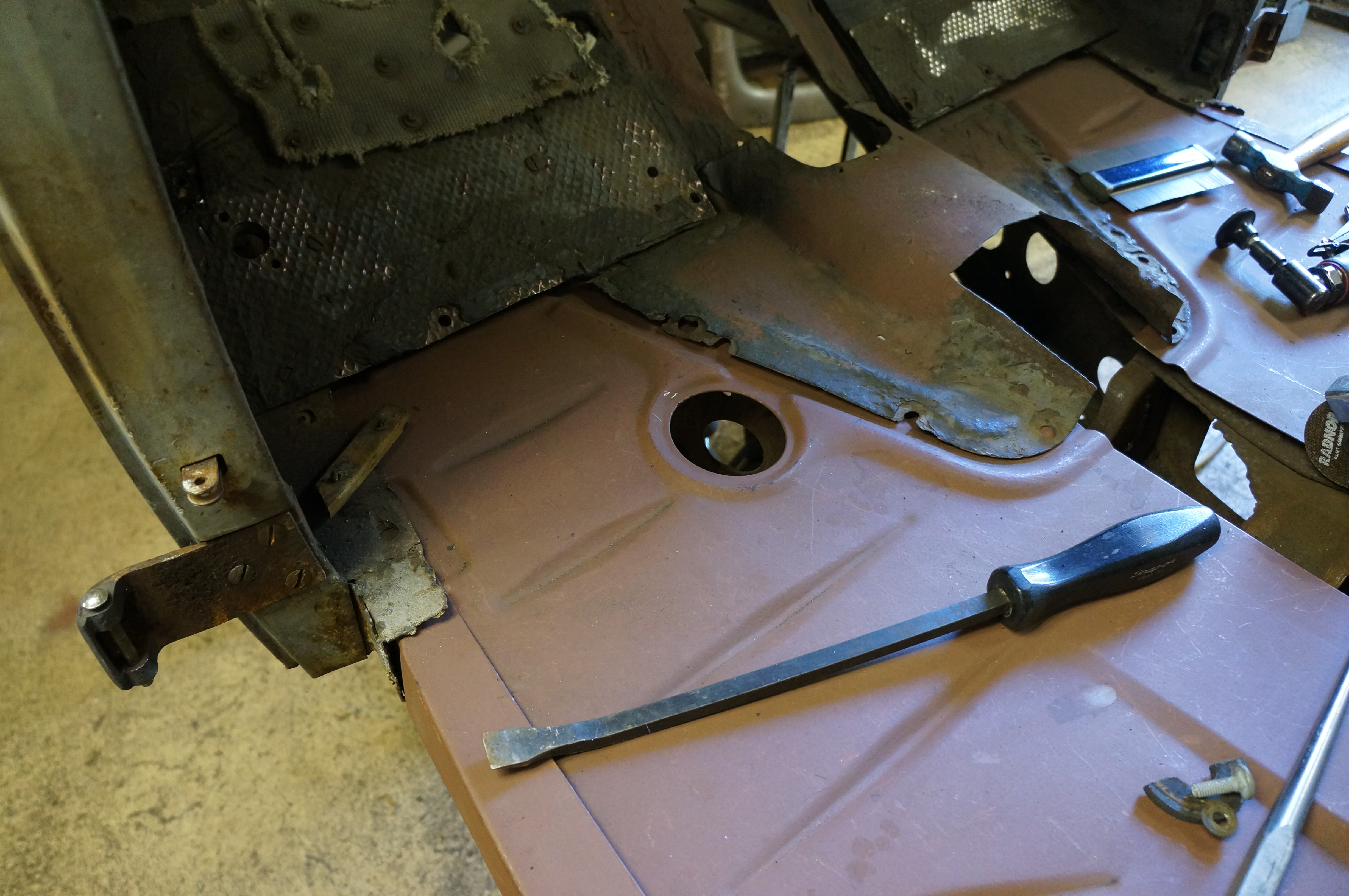

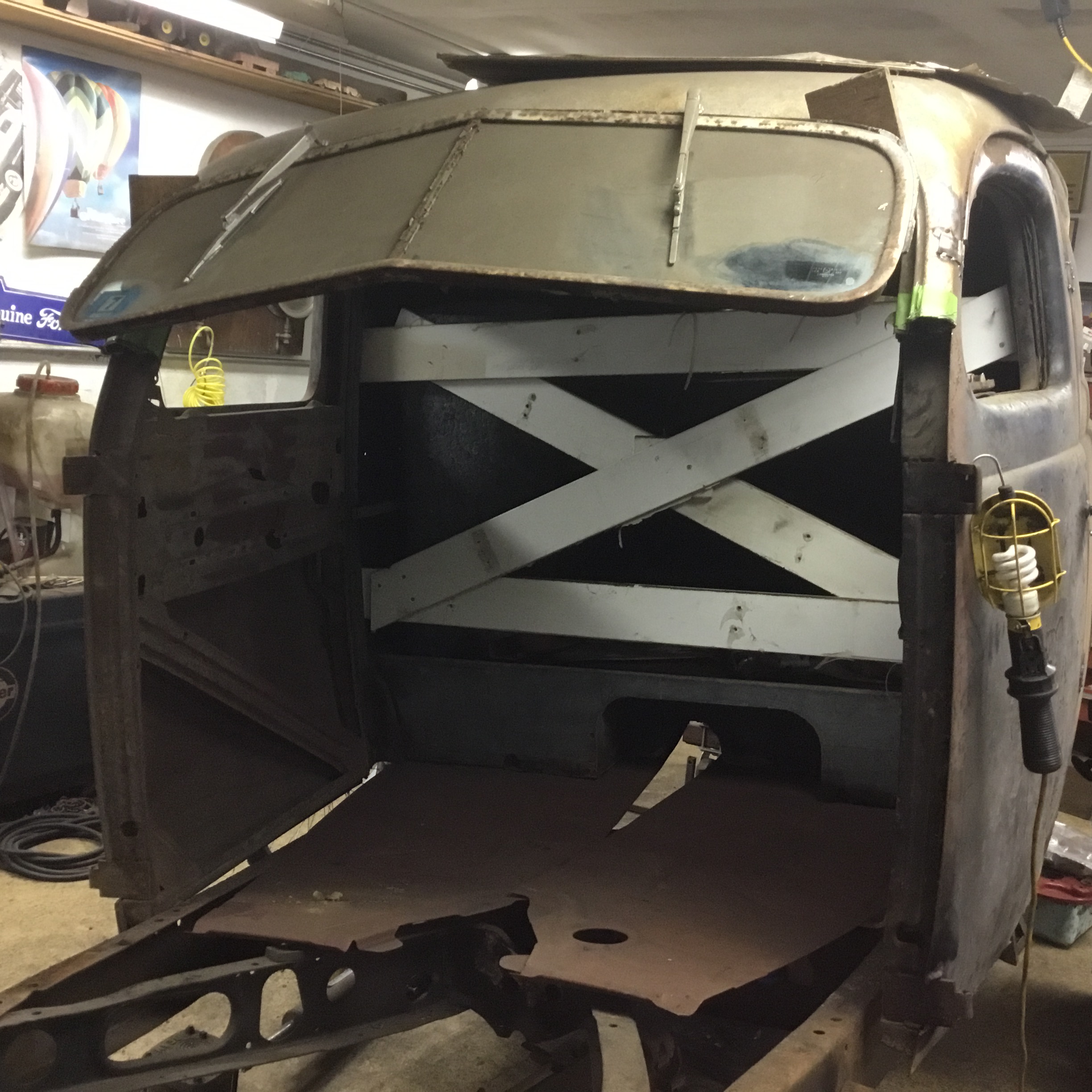

shogun1940
10-26-2016 @ 5:15 PM
Posts: 464
Joined: Feb 2010
This how i am doing it
MICHV8
10-27-2016 @ 4:53 AM
Posts: 500
Joined: Jul 2010
CharlieStephens:
My question is for 32-48 Fords in general, but the particular car is a 39 which Mike has addressed and I believe holds true for all the above years...
MICHV8
10-27-2016 @ 4:56 AM
Posts: 500
Joined: Jul 2010
Shogun1940
That is a nice looking floorpan...is it a Paul Bradley product?
