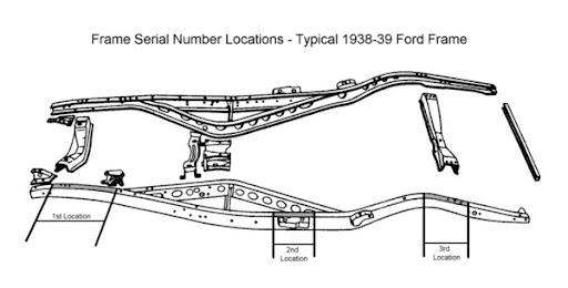

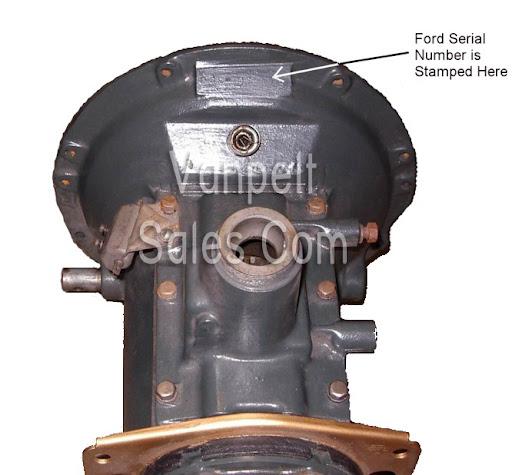

Your 1936 Ford pickup has no engine number. The transmission does, but may have been changed out. Where you'll find your number that should match your DMV Registration number is on the top surface of the left frame member between the radiator and the steering gear. It may have been lightly stamped, and may have corroded over the years, so be gentle when trying to clean it for better visibility.

No serial number on the engine. There should be a number stamped into the top front section of the bell housing portion of the trans. There should also be a number stamped on the driver's side frame in front of the steering box.

When I was young and told about the "LB" I looked and found it and showed it to the rebuilder in Houston. Now several decades later I can't find it and don't remember exactly where it was. So there's a wild card. I will look to see if the title matches the frame number, now located. It falls in line with the sequence suggested in my old old MOTOR manual, between first '36 and first '37.

Try this:
http://www.vanpeltsales.com/FH_web/flathead_serialnumbers.htm

Great News for me to share! With your help I found that the transmission does have a different number from the chassis. The Chassis does match the Vehicle registration. But most of all I found the "LB" It makes me feel better, having no reason to question the rebuilder.
