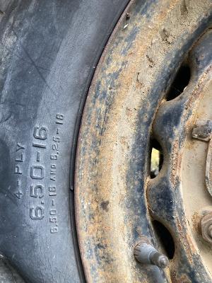

I would like to start by putting the correct size tires on it. The tires are all recaps and the fronts don't match the rears. All tire have tubes and don't stay inflated more than two weeks. MY FIRST QUESTION: Will tubeless tires stay inflated on the riveted artillery style wheels?

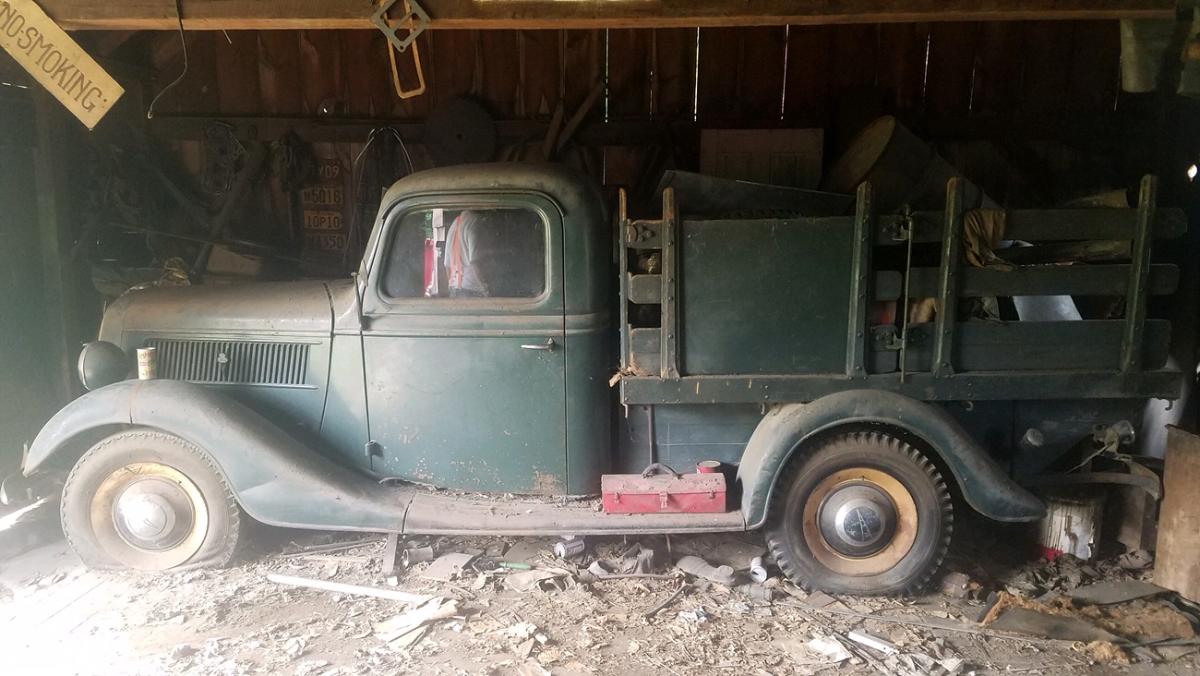

Nice 1937 Ford Stakebed
As you may know, it is a very unique body for the 112 inch wheel base 1/2 ton pickup.

nelsb01, I'm now assuming "Stake Bed" is the correct nomenclature for the truck. I'm just beginning to research the trucks.

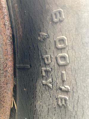

The first picture you show has your proper tire size 6.00 x 16
I have always used tubes with my 6.00 x 16 tires.
And yes, wide 5 if the 'nickname' that has been given for the rims for 1936, 1937, 1938 and 1939 112 inch wheel base Ford vehicles.
Once you remove the hubcaps you will see the bolt pattern and then it will make sense.

Commercials would have 6.50 x 16 tires. They were optional over the 6.00 x 16, and would have been on most commercials. You will likely find a wide rubber band inside each wheel to cushion the tube from abrasion from the rivets. If this is in decent condition, use it, find replacements, or just a layer of duct tape will do.
