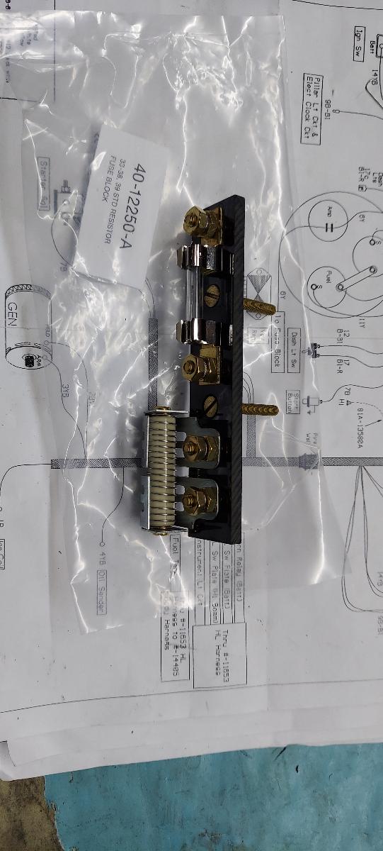

Anyone have a pic of where the fuse/resistor block mounts ? I just dont see where it mounts. Maybe im missing something ? In my defense im working with a 100% basket case.

do you have any photos of your fuse- resister block, ? has a 1 ignition coil resister and 1 30 amp fuse
If it is like a 37, you should see 2 small holes on the outside of firewall, on LS
the fuse resister block get mounted on the inside,
do you have any manuals on your truck ? they do help , even a owners manual for your truck,
hope this helps 37Ragtopman

I have this repro fuse/resistor block. There are no holes in the firewall that fit this.

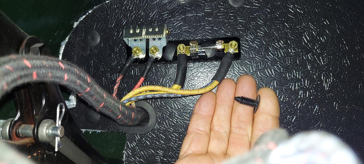

My solution for mounting the fuse block. I couldnt stand to drill through my fresh painted firewall. The push in fasteners hold it to the pad just fine
