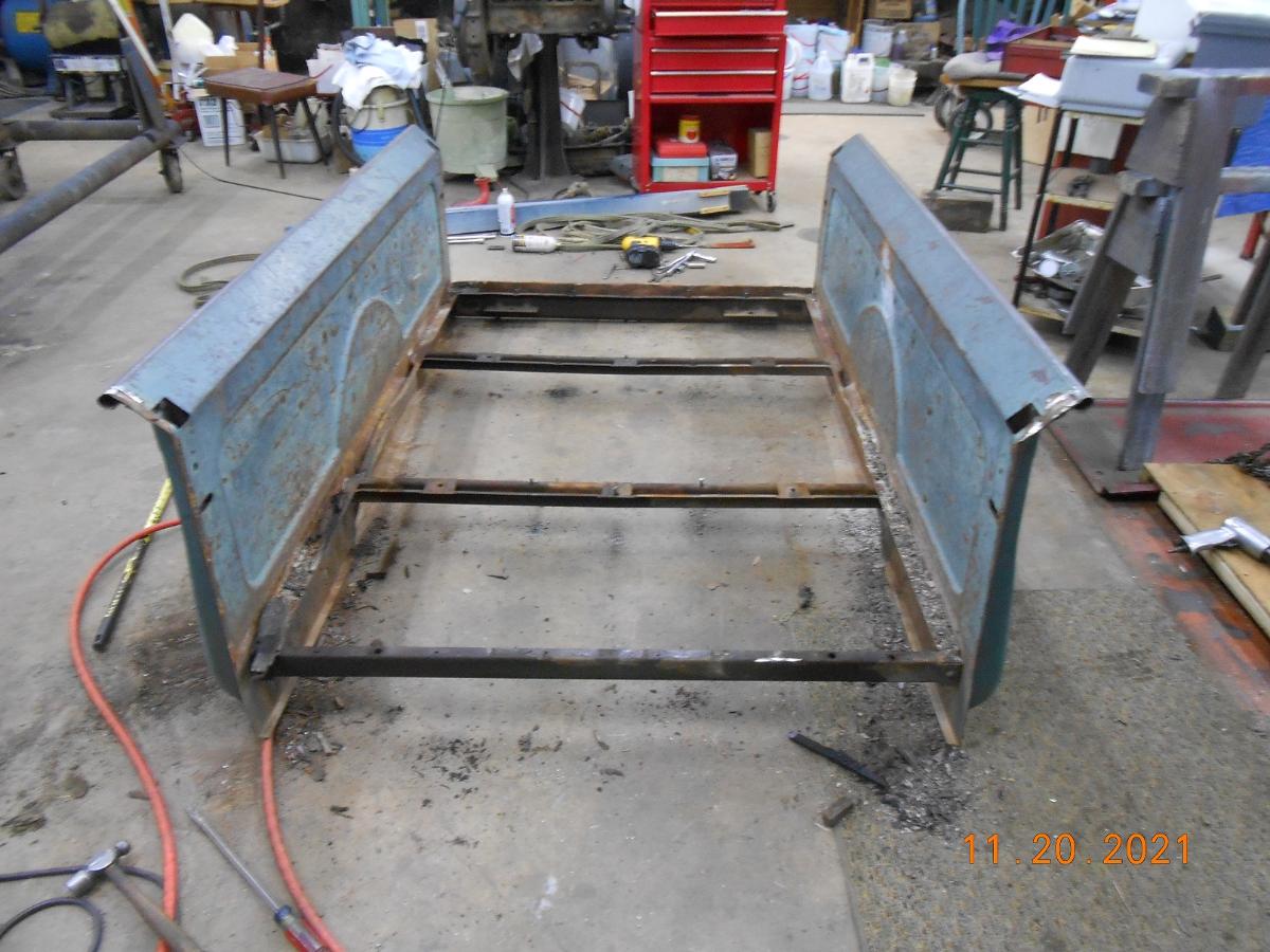

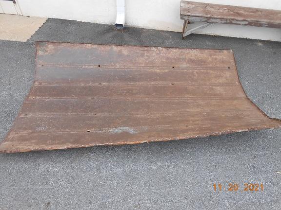

I am near paint time on my bed reconstruction. I am installing a new metal bed floor. I need to know if the ORIGINAL metal floor was painted body color? If not, what was it? My truck is Meadow Green, and I believe it is original paint. The bed floor doesn't show any sign of green paint. But, no signs of black and maybe a slight sign of silver. It does have a lot of wear but I doubt that it was NEVER painted. I would like an answer based on facts rather than preferences! THANKS. Don

I BELIEVE your bed color would have been body color. I BELIEVE 38/39 thru 1952 pickup boxes were the same depending on whether 1/2 ton or Tonner models. Rear fenders & tailgates changed in this period. I have seen many 1/2 tons over the years, never seen one that had what i thought was original any color that did not match. I have never seen any Ford written material which would lead to a different color. Tonners had body color skid strips that matched body color. My expertise is with 42 to 47 years. 48 & up MIGHT be different, I doubt it, check with EFV8 judges would be one place to check.

The beds were assembled completely with out fenders and painted completely including floor in body color.

Gentlemen, I have never owned a 1950 Ford pickup. But I did a little research online for you. My fellow members are correct. The 1950 pickup bed is/was all steel manufacture, including a metal floor, and the entire bed assembly was painted body color.
Things changed the following year. 1951 Ford pickups had a wood floor in the bed, but the rest of the assembly was painted body color.
