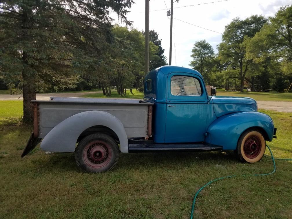

i am doing an amateur restoration on a 41 pickup and would appreciate any suggestions on how to proceed. I have kept it as original as possible with the addition of bolt on engine mods. I am uncertain how to proceed with the suspension. I rebuilt the kingpins and installed spring perches for tube shocks. Does it require a front sway bar? what about a steering dampener? same on rear suspension. I have made many mistakes over the years and prefer not to make anymore. Any help will be appreciated.
