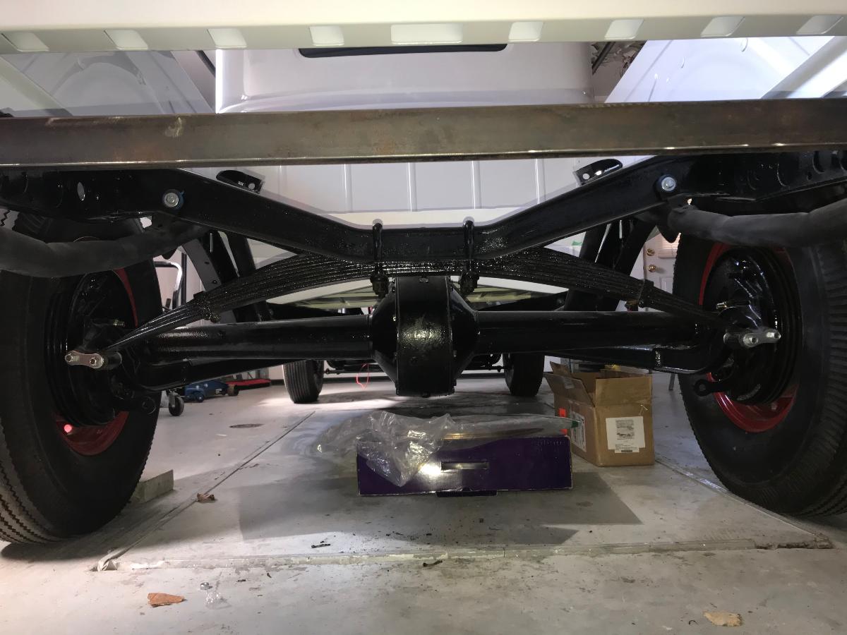

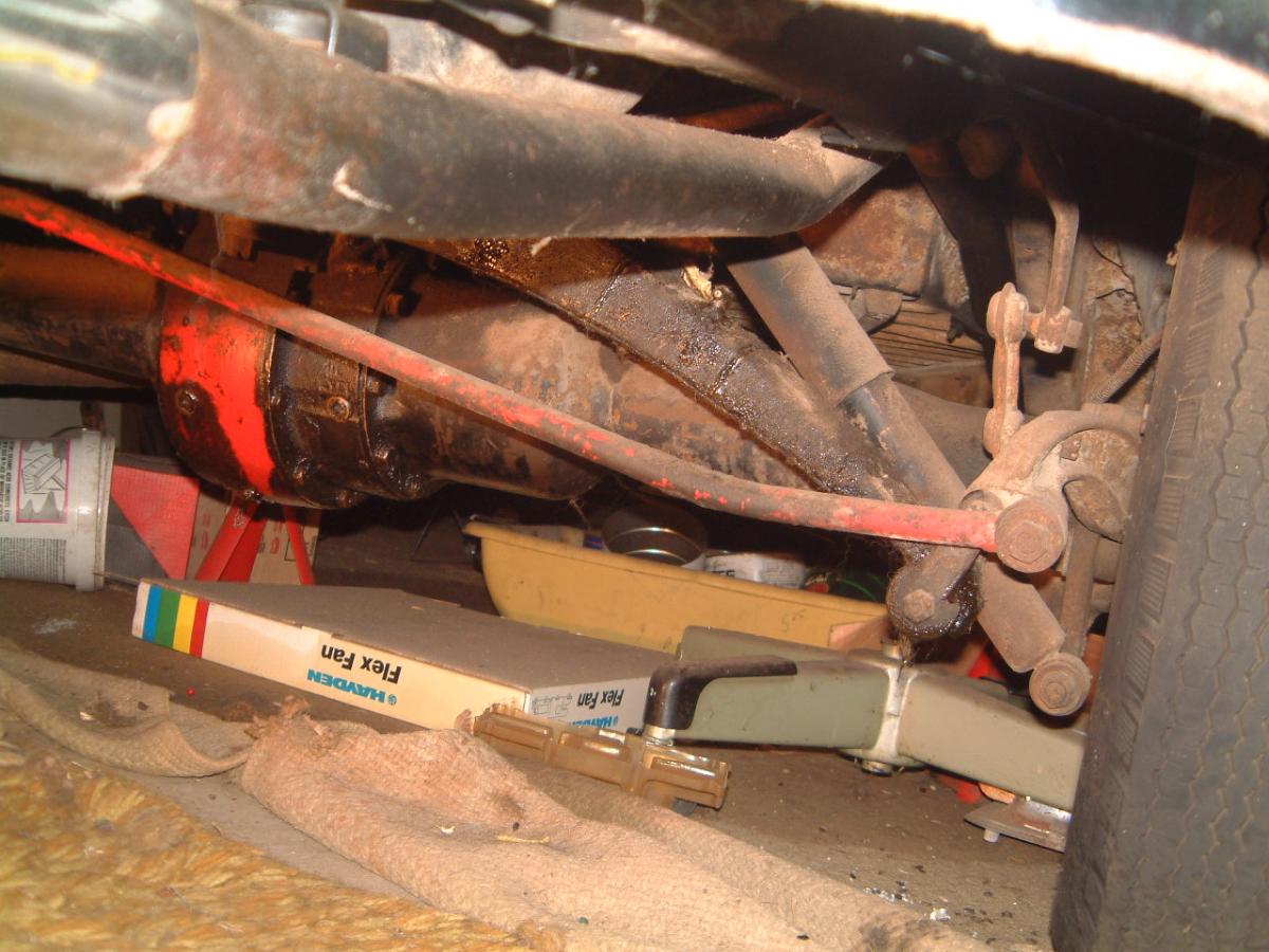

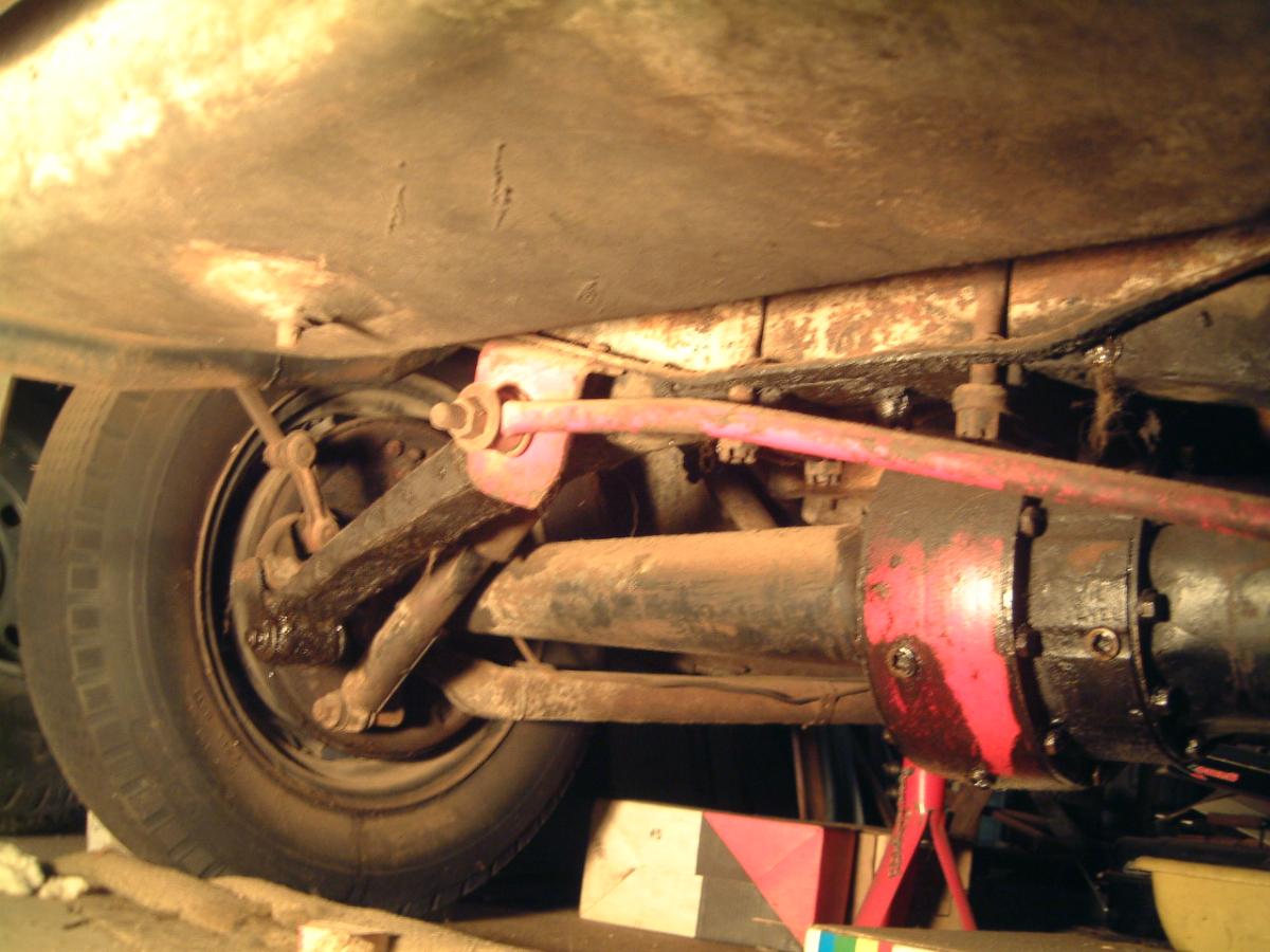

wmsteed
07-27-2020 @ 9:48 AM
Posts: 613
I wonder? why in the world would you want to keep the mechanical brakes?
In the following I'll describe how I lowered my '36 Ford coupe which is not the much different than a pickup.
I used a '41 front axle with a 2" drop with a '41 spring and stock short shackles. My steering gear box is a '40 with a '40 mass jacket, (column shift) '47-48 , 28 tooth trans,
pitman arm 21-A3590-3 o15. '40 Ford.. Tube shock conversion with short shocks to clear the '36 fenders, Everything a bolt together application.
Rear suspension: My car came with a Columbia two speed O/D.. Did not care for the early Columbia so I secured a '47-48 Columbia. I disassembled the rear end, used the '47-48 Columbia w/'47-48 axles and axle housings bolted to the '36 center section, used '37-38 radius bars on the '36 torque tube, '47-48 spring, sway bar, tube shocks on 47-48 mounts. The complete rear assembly is a bolt together application, no cutting or welding.
The car drives perfectly and has a very nice stance, as you can note from the attached pix.
Bill
