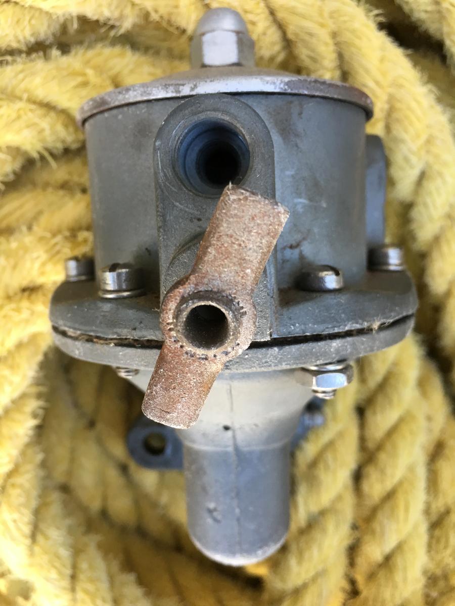

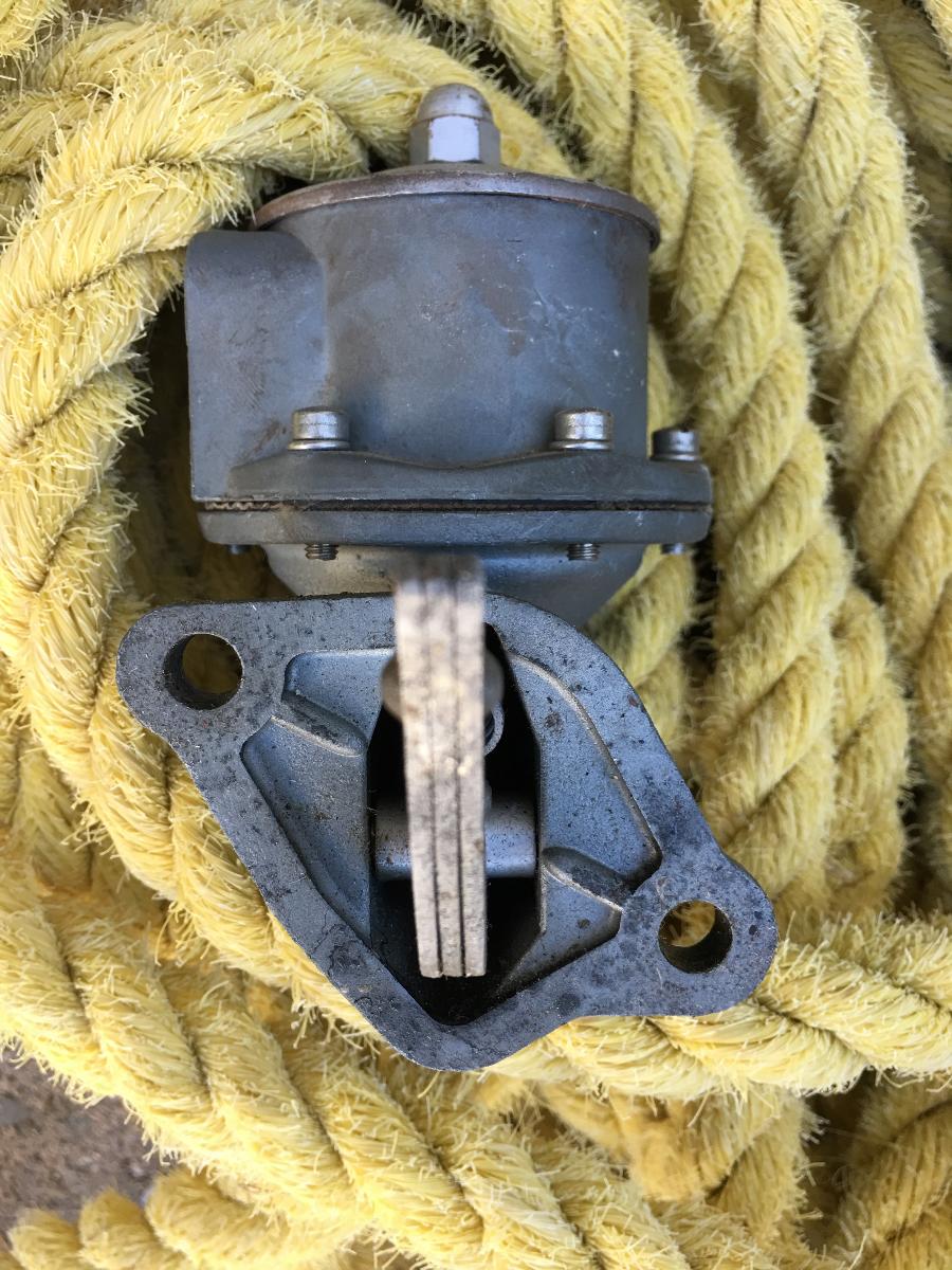

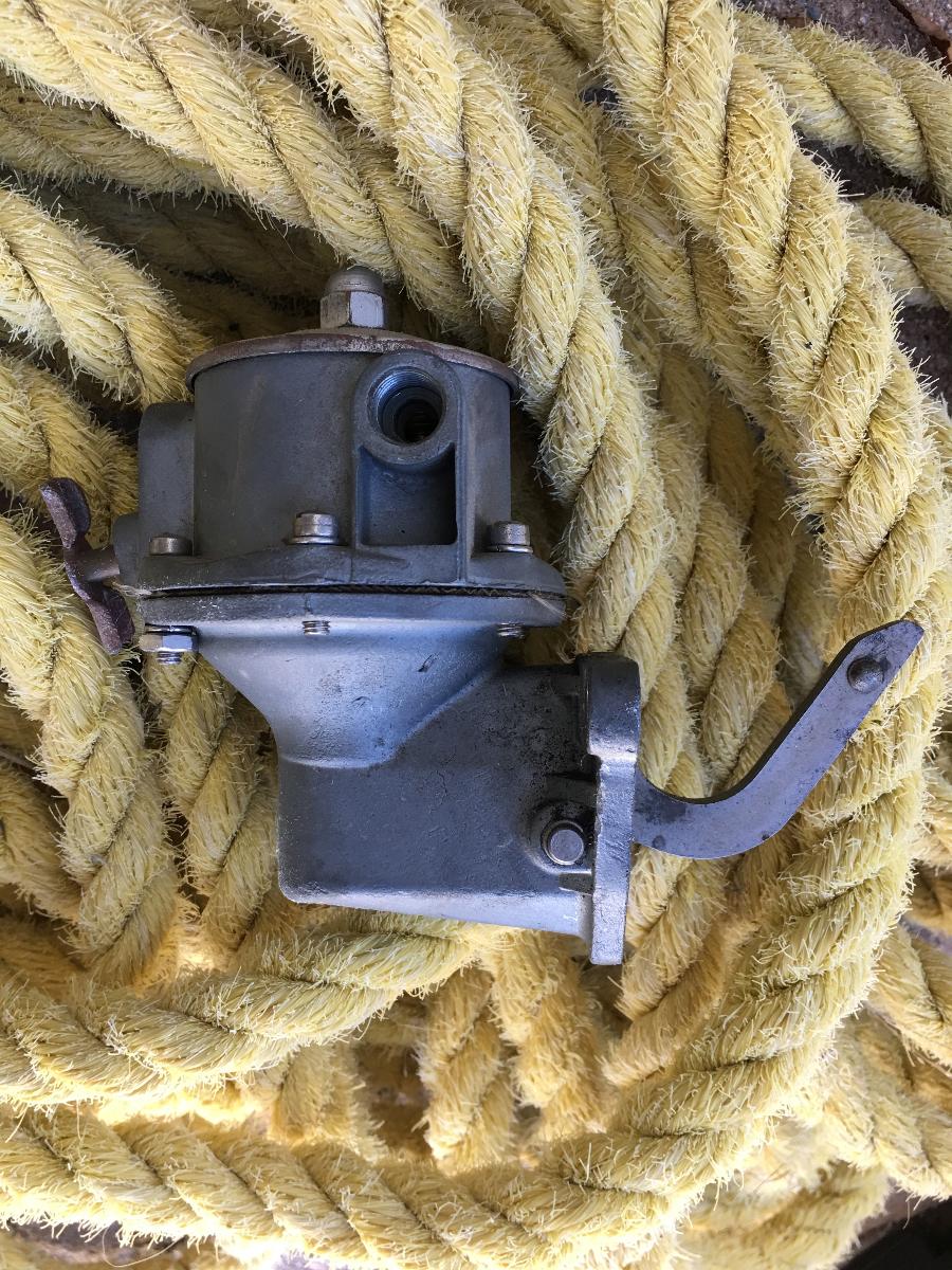

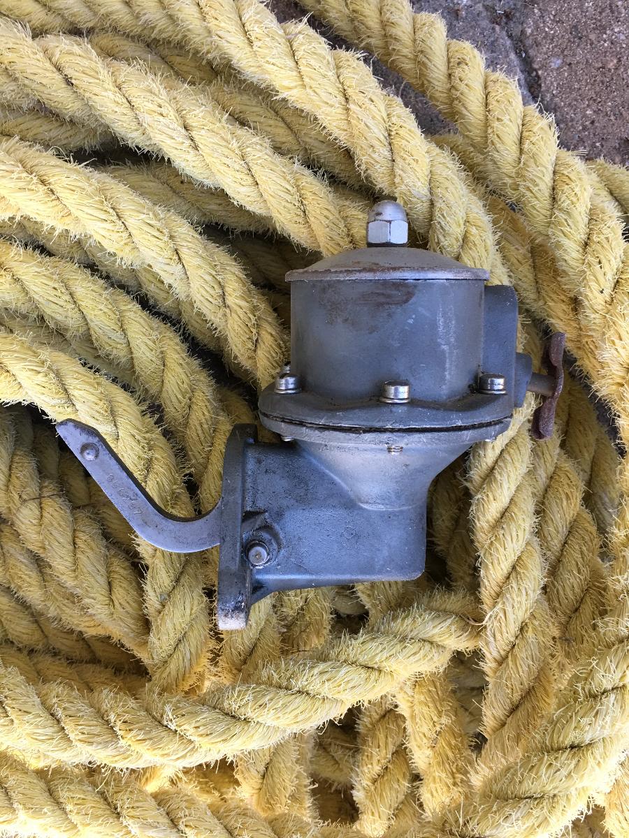

CharlieStephens |
03-06-2020 @ 10:42 AM
Posts: 878
I believe these pictures show the correct Model B fuel pump. If I am wrong comments, would be sincerely appreciated. First key is that the lever runs off of a cam and not with a pushrod like the V8. Charlie Stephens
ken ct. |
03-06-2020 @ 1:16 PM
Posts: 1513
Yes that's a "B" pump. JB weld will NOT hold up to todays gasoline. ken ct I have all the parts to rebuild them but must be hole free !!

Posts: 7243
Ken, the the sediment bowl in the photos looks similar to the small body V-8 pump used until 1937, is it interchangeable with the upper body of the 4 cylinder pump? Fixin 32, please measure the OD of the sediment bowl of your pump. I have some old pumps that may have the same size bowl.
ken ct. |
03-07-2020 @ 9:58 PM
Posts: 1513
