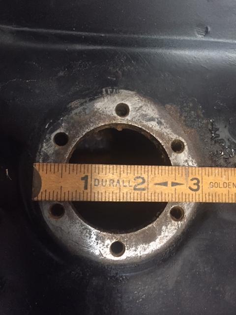

Does anyone have a source for a hydrostatic gasket for a 1935 model 51 Ford truck.? This is mounted on the bottom of the tank and drips constantly. Advice on a good gasket material to use would be helpful as well as dimensions and drawing of this gasket.

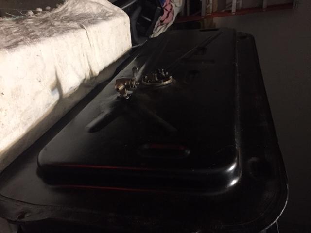

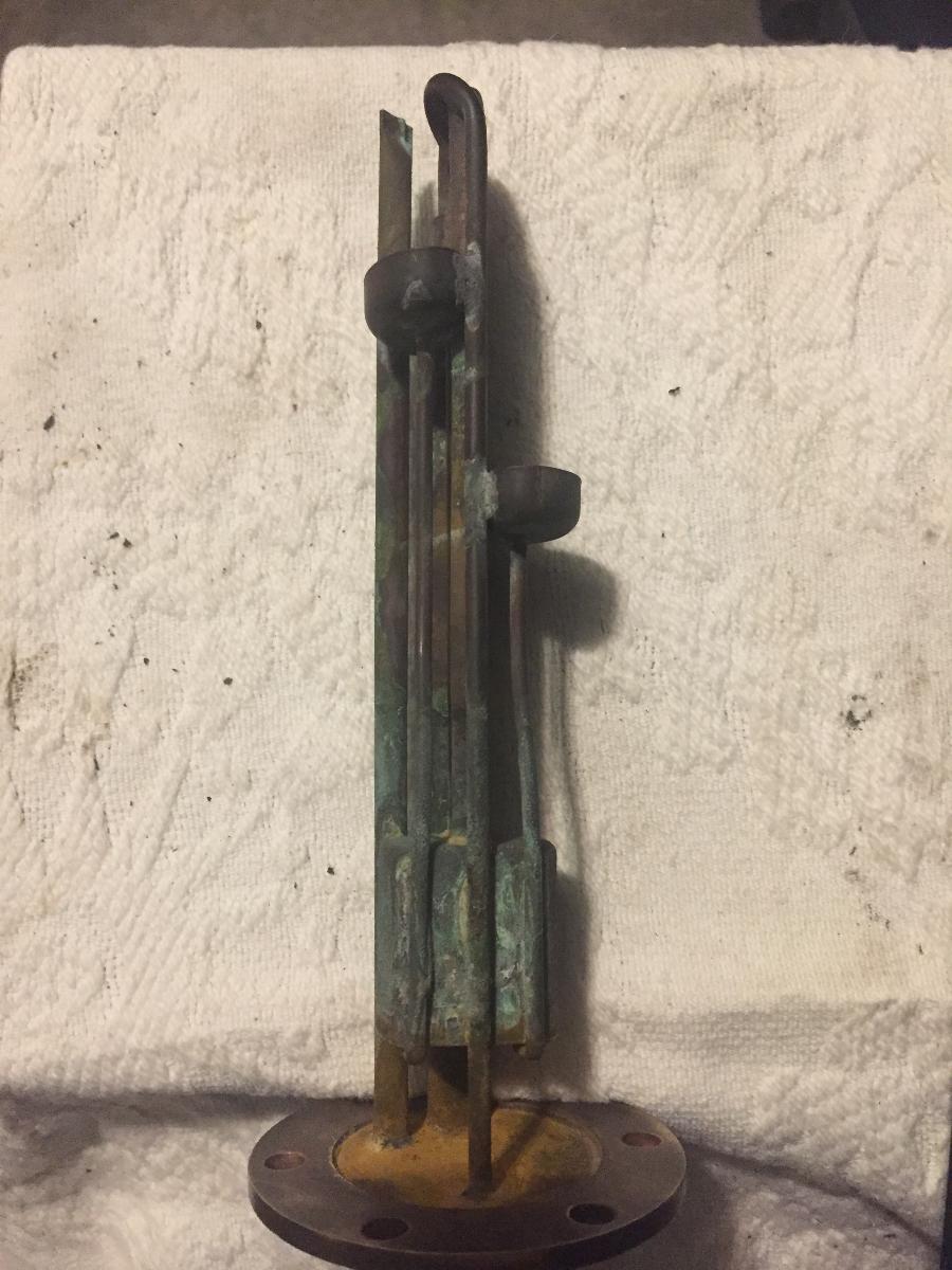

Thanks for your reply 37Ragtopman. My '35 is a 1 1/2 ton and the fuel tank is under the seat. Both the shut off valve and sending unit are mounted on the bottom of the tank. I've had no luck locating a vendor with the needed gasket. The ones I ordered are too small and are probably for a top mounted hydrostatic unit. I made gaskets out of gasket paper and they leak. What gasket material and or sealant would you recommend to use as they will be exposed to gas directly?

I found sheets of neoprene gasket material at auto zone--they did not even know they had it , that will work on gas

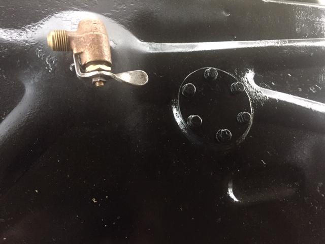

Thanks for all your suggestions. I made gaskets from Auto Zone gasket paper and neoprene materials with leaks from both. I did not use a sealant with either. I decided to not use the hydrostatic sending unit and made a 1/4" steel plate instead. I used Permatex Gasket Maker sealant with the plate and am letting the sealant cure prior to adding gas to the tank. I'm hoping this will solve the leaking fuel problem.

The gasket should be made from a cork based material that is available in the Felpro Gasket Material Part # 3060. This package is available in most auto parts stores. If they do not have it in stock, they can order it. I noticed that your mounting screws go all the way through the bottom of the tank. You will have to use a good sealer on the threads or they will leak. The newer formulations of gas find leaks where the mid 20th Century gas would not leak.

After letting the gasket maker cure for a couple of days, I added gas to check for leaks. The bolt hole bores do not seem to be open ended but somehow gas did seep around the brass washers and gasket. This time I did used the sealant (gasket maker) on the threads and washers to hopefully seal. I will let you know the results and thanks again for the help.

02-06-2020 @ 10:35 AM
Posts: 7243
I have seen 2 types of sending unit flanges on the gas tanks. The most common one has a flange soldered to the tank with the holes only in the flange. To make sure that you get a good seal with that type, the solder must be around the bottom inside of the flange, to keep the fuel from reaching the screw threads. To seal it without soldering, you can put a fuel safe sealer like Seal All or Pematex type 1 RTV around the inner lip of the opening and let it cure before installing the sending unit. Then put a small dab of Permatex #2 in each of the screw holes with a toothpick, install the unit with Permatx #2 on the screw threads. If you have the other type where the mounting is directly to the tank and the threads of the holes go through to the tank, you will have to find a way to seal the bottom of the holes.
