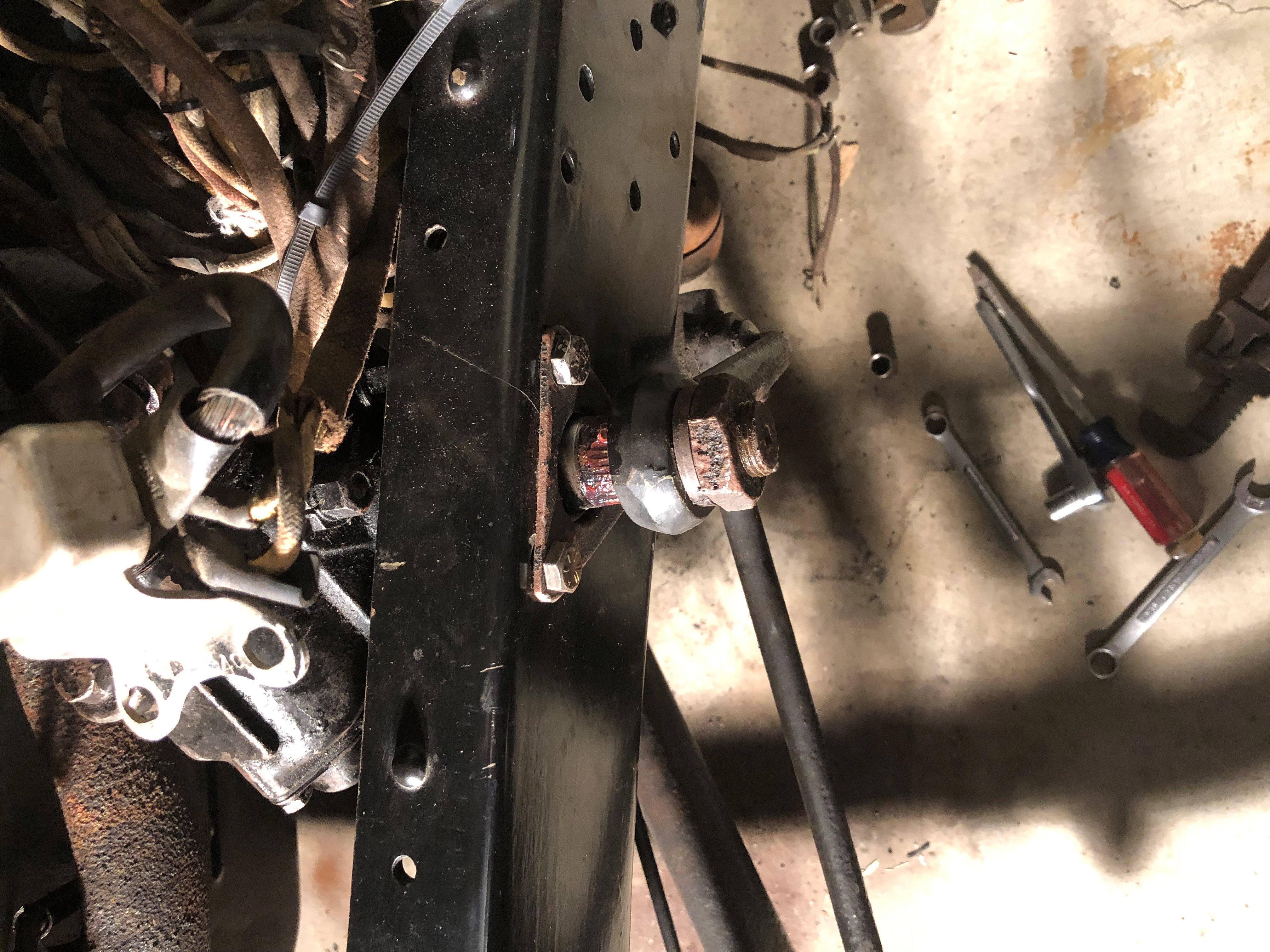

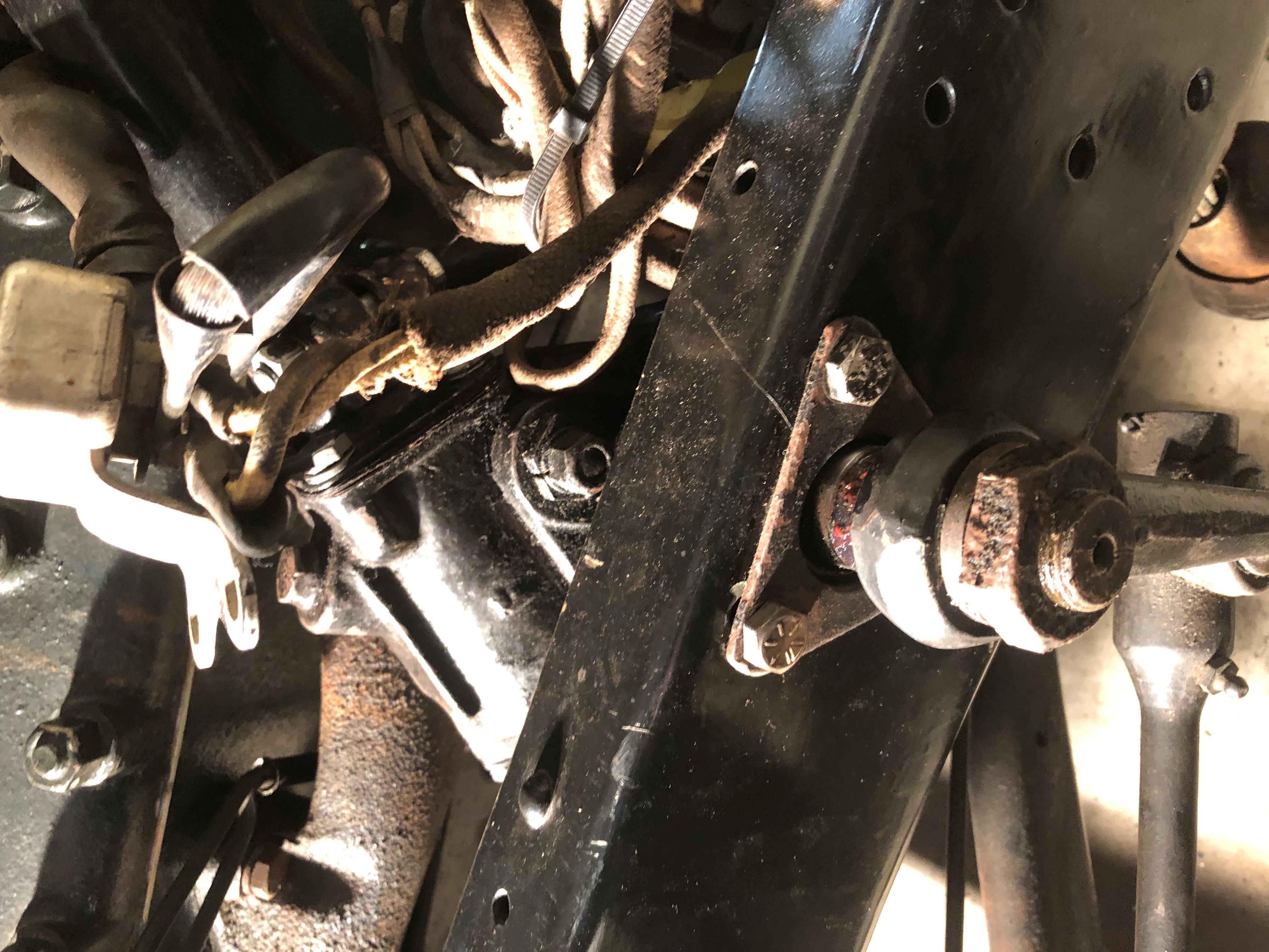

attached is a pic of the steering box and how I mounted it. It seems like the linkage is not sliding on the spline all the way. does it look correct to you?

It looks like you have a V-8 as your engine, if so, you have a model 46 not a model B. The model B was a 4 cylinder. Any way, your mounting looks right. I have '34 pickup I restored and a photo of my pickup in the Galleries.
