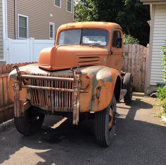

New here, I have a 1942 Ford M-H it has original gears, 6?? Something. It cruise's around 30mph. I looking to get it up to 45-50 mph. Does anyone know if there are any overdrive units made for a 42 flathead v8? Anyone sell ring and pinion gears that would fit this rear? Any other Marmon Herrington info would be appreciated. Thanks Donn
