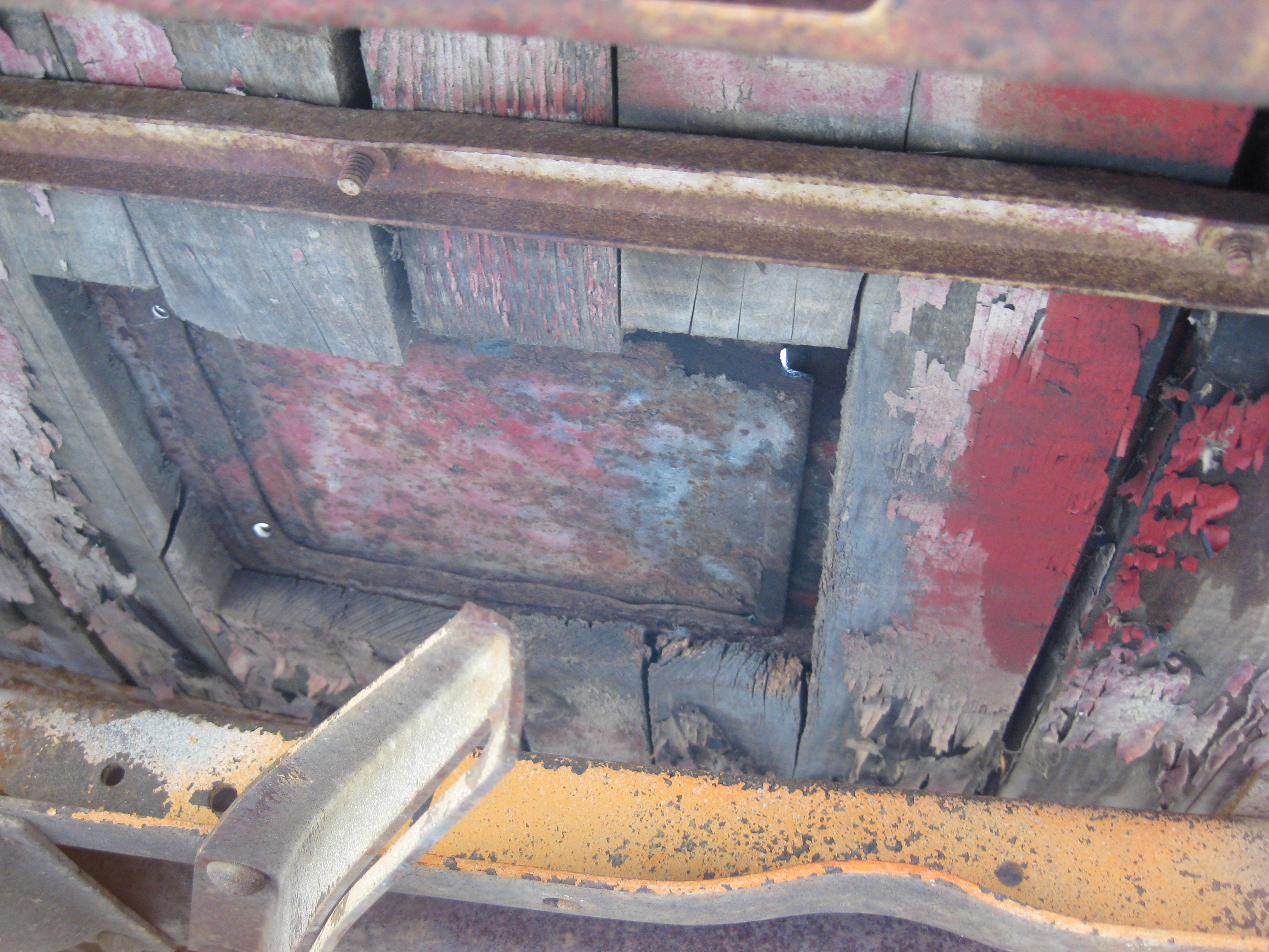

What color(s) would be seen from UNDER the 37 Ford Pickup? Is the bottom of the cab the same as the entire cab? Is the bottom of the bed the same as the bed color or black?

I have taken 2 1936 Pickups apart. Bottom had body color on the underside of the cab. Attached is a photo of the bottom of an original 1936 Ford Pickup box. The pickup was painted vermillion red. Although faded, you can see that the wood was at one time red.

Be glad to help if I can. On the one that I am restoring, research was found that said that all the wood was treated with wood preservative. (a dark color) So, when we painted the bottom of the bed, we made sure all the metal areas were color painted and then did a "over-spray" on to the wood.

The picture I attached is a good example of my research. If you are thinking that there was a actual factory letter-- no, I do not have one. I would defer to Don Rogers if you are looking for factory information. He may have found something as he has been doing 1935-1936 research for many years.
