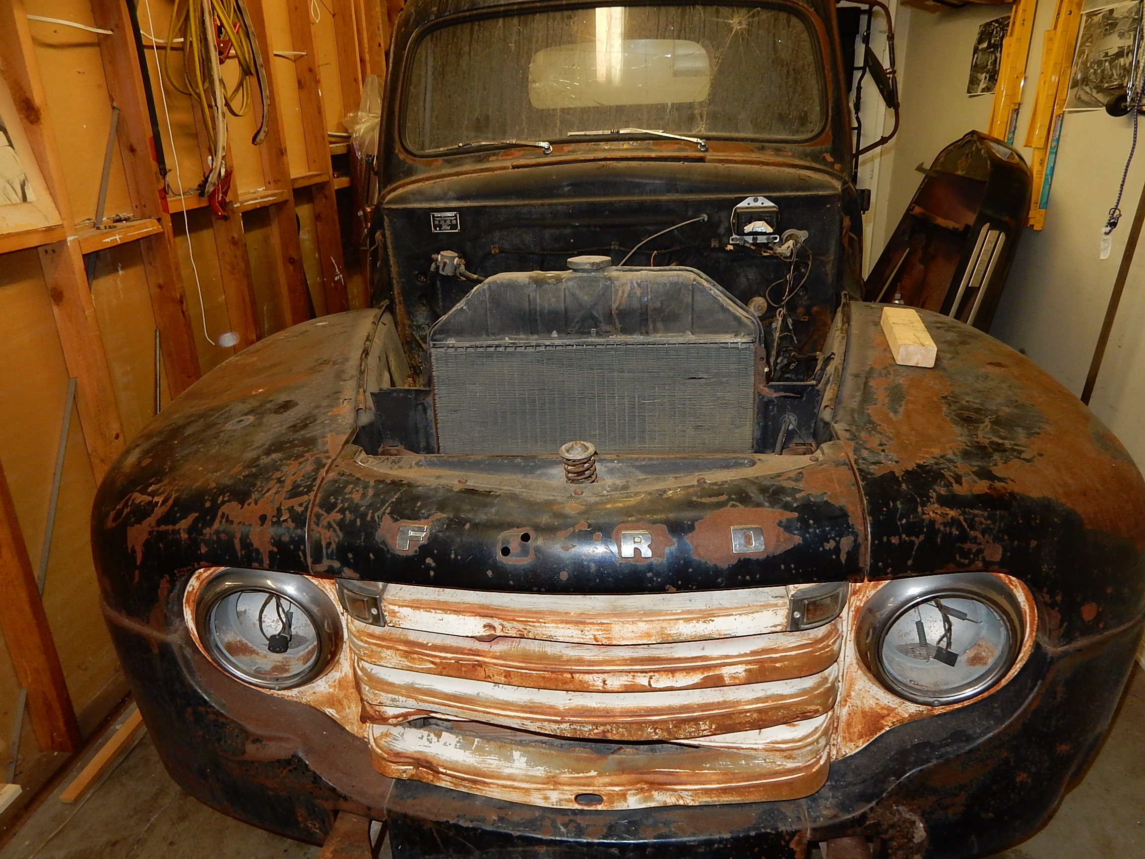

Tom-one more point-imaged attached shows grille as I started restoration. I would appear that not only the surrounds, but the grille bars as well were painted the tan color. Although I don't recall seeing any mounting holes for the stainless grille bars, I intend to install them.
Thanks again for all you help on this
