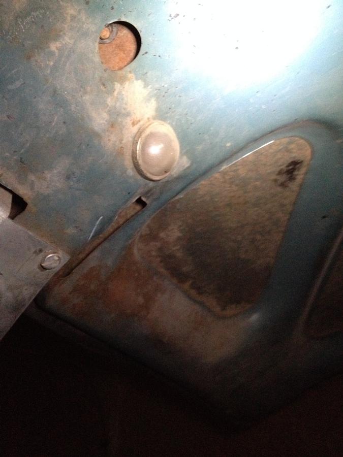

I have a 1950 Sport Sedan with the factory OEM white bubble trunk light and it always was connected to the park/tail light wiring. If the tail lights are lit it is on. I didn't realize this little white bubble light was factory until I got an accessory brochure.

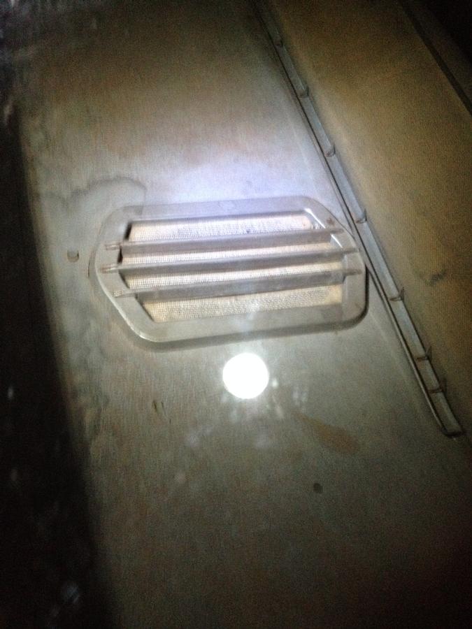

If you have somthing prehistoric looking on your rear package tray that is a factory rear speaker. Your trunk light should look like this.
