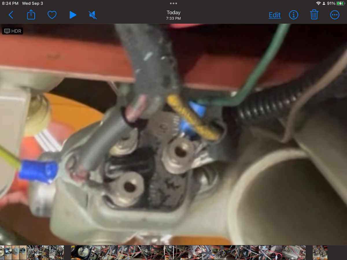

Does anyone have a picture or drawings of what an early ‘47 Mercury on/off lever switch assembly look like?
I am looking to understand what is inside the Bakelite box, before opening it up.
I suspect that something is corroded or wore out inside, as the engine sometimes shuts off, and if I flip the switch a few times, I can stop the shutdown.

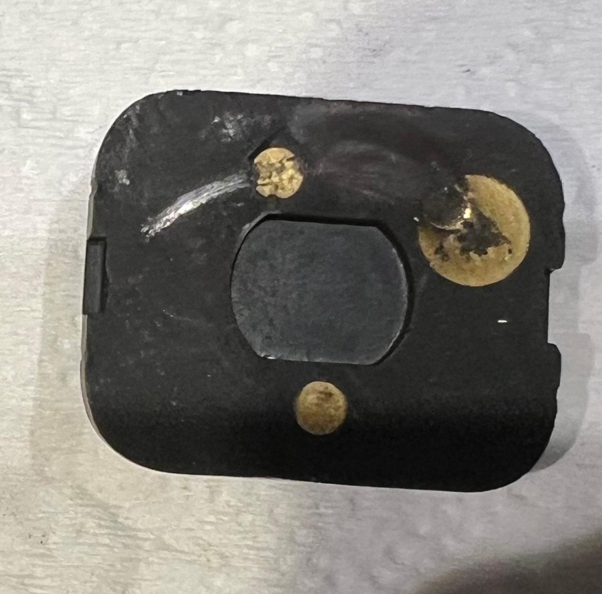

I got it off, and am happy to report that after years of chasing random shut offs, and occasional hard starting, that I believe I’ve found the cause!
Now, I just need to reassemble it with new parts…
