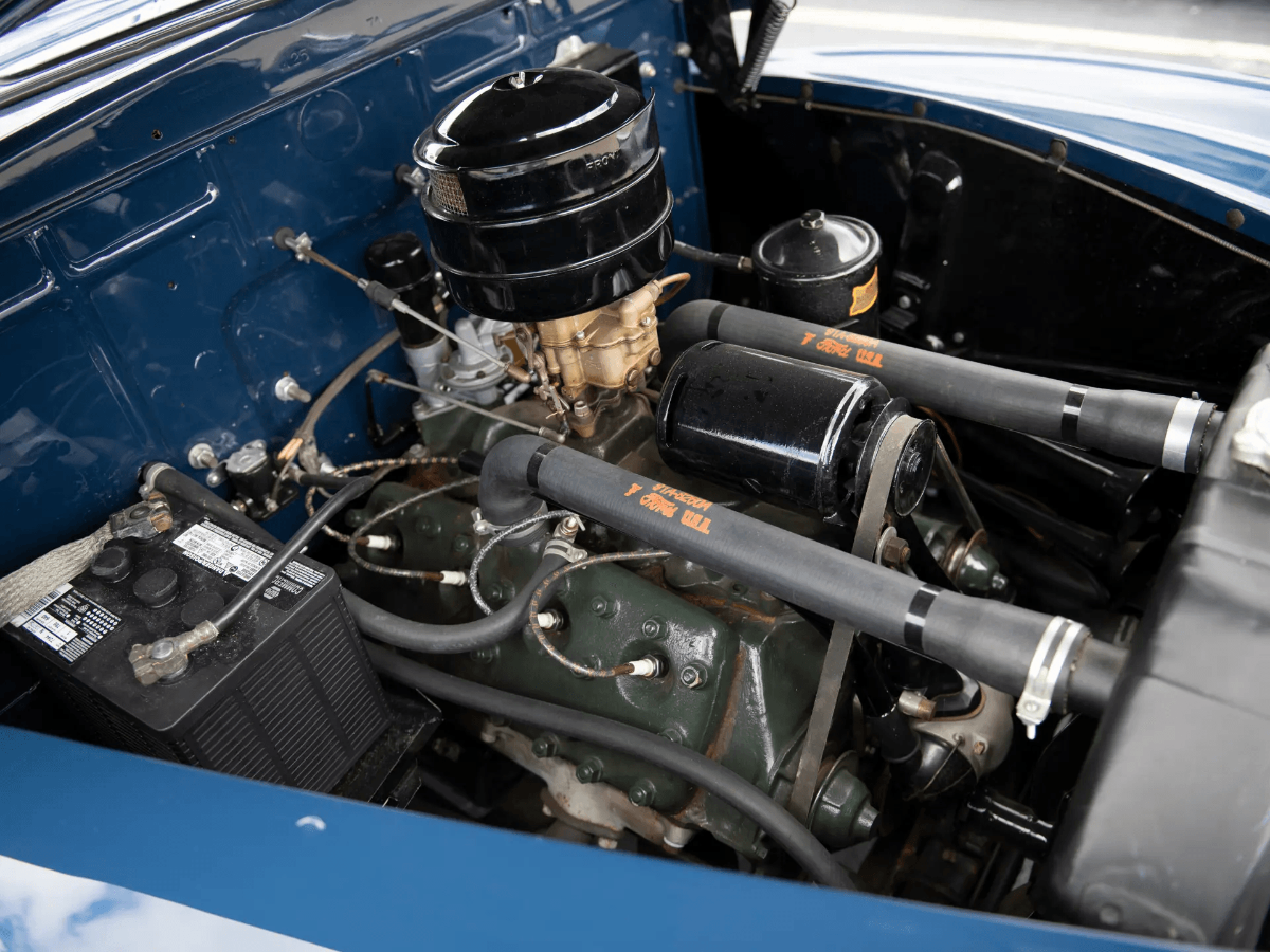

Chris, if I read your post correctly, you only needed the starting fluid during the period where you could not get it started and now it starts fine.
In looking at the photo of the driver's side of the engine, I noticed that you have hose clamps on the flex line going to the carburetor. If that is still the case, it may be the cause of your hard starting after the car sat for a few days. What I think happened is that the fuel in the carburetor evaporated or leaked out, when you tried to start it, the fuel pump started sucking air through the flex hose connections and could not prime the carburetor. The needle valve at the inlet of the carburetor was also stuck, so the weak fuel delivery could not over come it and the engine ran only while it had starting fluid. Once you have the engine running, the rapid operation of the fuel pump overcomes these deficiencies.
The fuel lines from the tank to the fuel pump should be air tight. The fuel pump has to lift the fuel about 10" and any vacuum leak will make that harder to accomplish.
If it were my car, I would replace the flex hose, spark plugs and flush the inlet of the carburetor with carburetor cleaner, I would also add a can of Sea Foam to the gas tank to clean some of the varnish from the fuel system. Your fuel pump looks like one that has been manufactured in tis century, so it is most likely Ethanol resistant.
When starting my Mercury while warm, I don't give it any gas until it catches. You may want to try that with yours. To clear a flooded engine, press the accelerator pedal to the floor and crank the engine for about 15 seconds.
