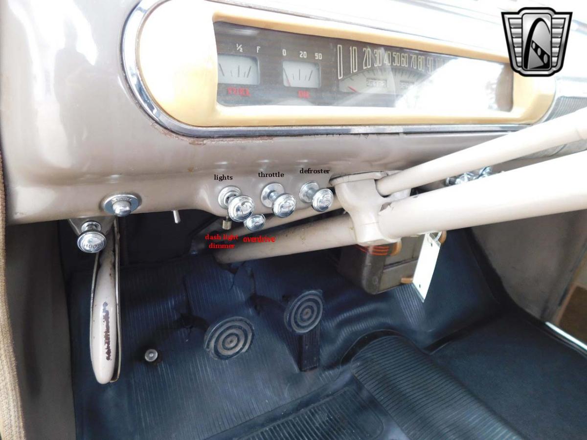

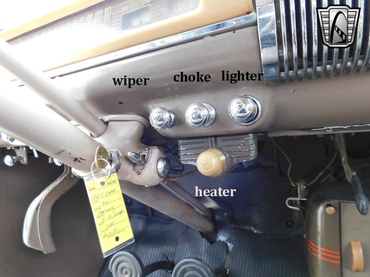

07-16-2025 @ 1:21 PM
Here are 2 photos with the descriptions, but you will find better descriptions in the Owner's Manual. Original ones and reproductions can be found on Ebay, reproductions can be found at some of the supplier to the hobby,shown in the Vendors category found by clicking on LINKS on theleft side of your screen.

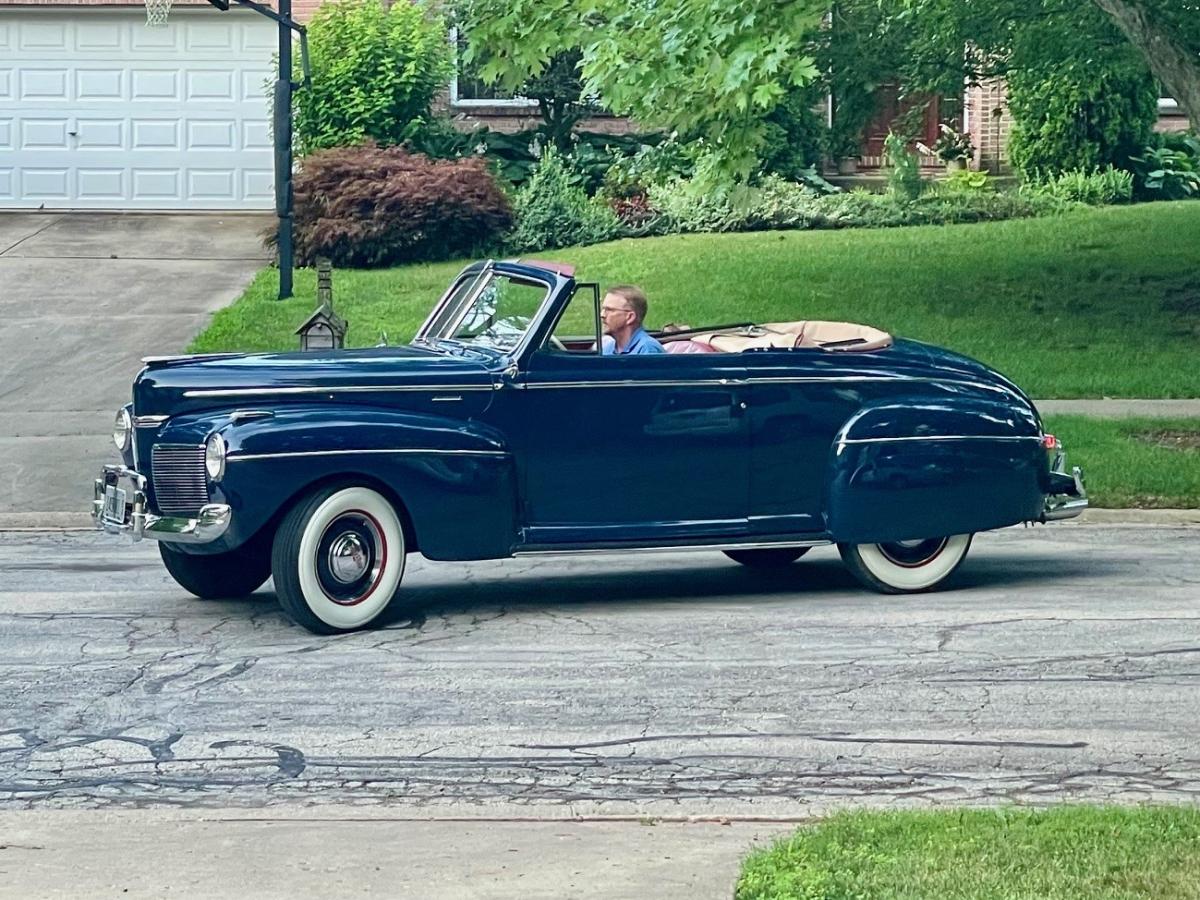

Again, thanks for the info everyone. In the meantime, I'll add a picture of it with me at the wheel this morning...

TomO...
Last night when I got home, I went over to check out my 41 with your information you provided on the two pictures. There are two differences for me...
On the first picture in red text you have two items:
- Dash light dimmer (for me this seems to be the "trip" for the odometer - turning it turns the numbers on the right side of the speedometer.
- Overdrive (for me, this is my button to operate the convertible top)
You mention the dash light dimmer, but in fact, at the moment, I don't have any dash lights - If I pull the lights, first stop pulling outward turns on the parking lights, and second stop pulling out are the headlights - with the floor push button for high/low beams. When should the dash lights come on? is there more than one bulb? I'm thinking that perhaps I have a bad bulb (or two?).
