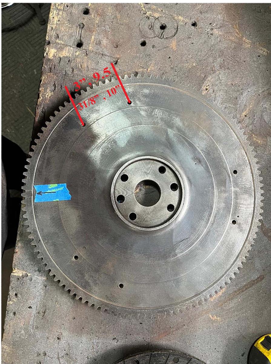

Let me say that I don't know much about fords prior to 1954 and almost nothing about flat heads. I picked up a 1948 mercury from a barn where it had been since 1961. After reading about possible cracks in the blocks, I pulled the engine and set it aside for later. I then heard about a guy who built flatheads for hot rods. I went to talk to him only to find he had passed away. I purchased a 8BA engine cheap from his widow, and she gave me his notes on the engine.
It has a 4" crank, bored to 3 3/8 and has 7" rods. The crank and rods have been polished and balanced. It has a high volume oil pump. It has 8RT water pumps. It has a ISKY 400 JR cam with solid adjustable lifters, and Ross racing pistons. His notes state that the engine was never in a car but was run 3 hours on the test stand. It had no heads or intake when I purchased it. Now my problem.

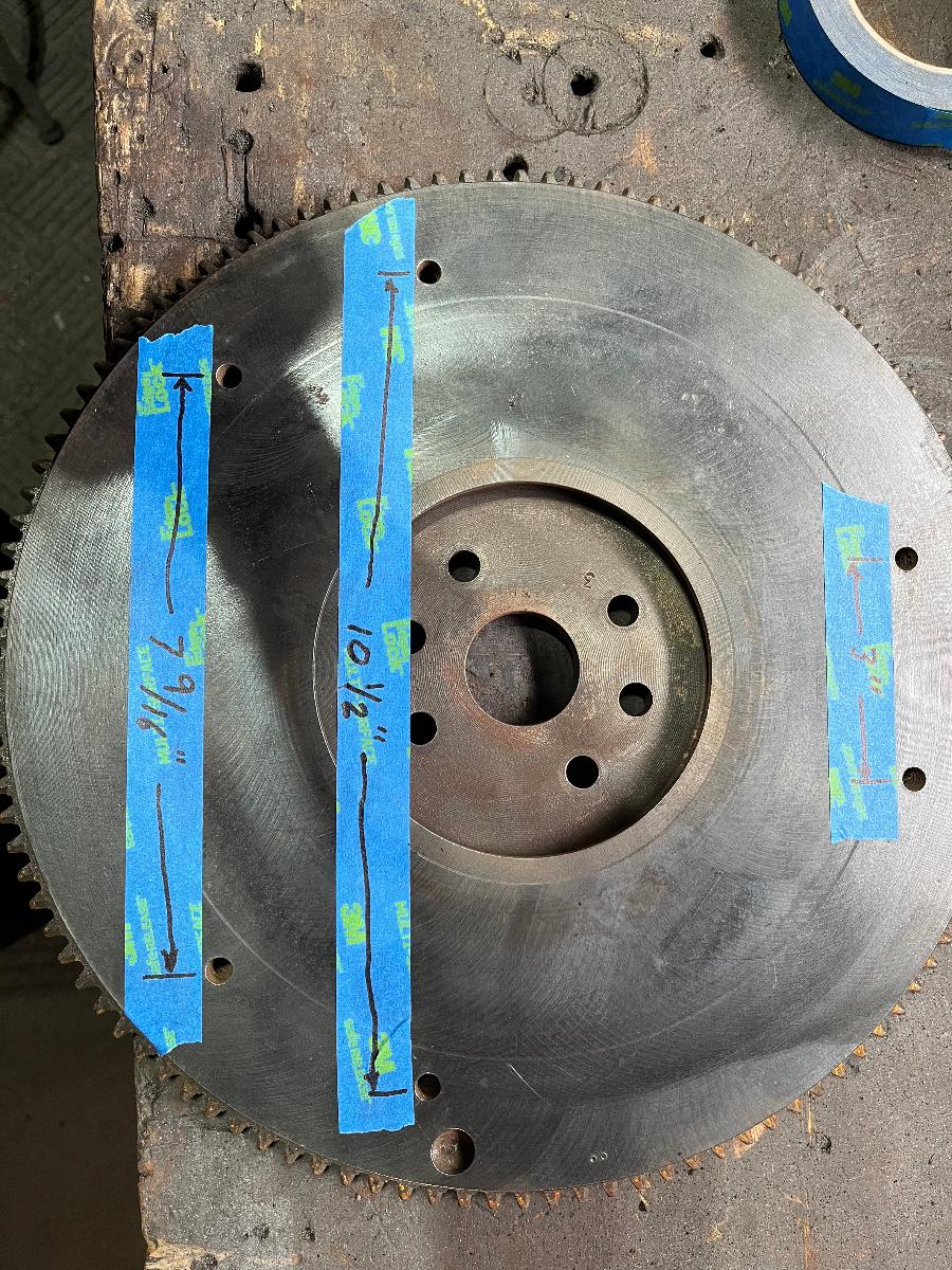

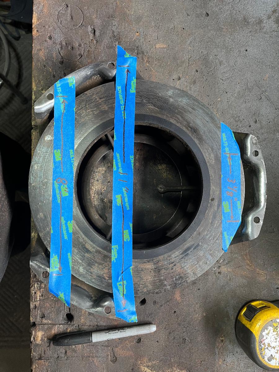

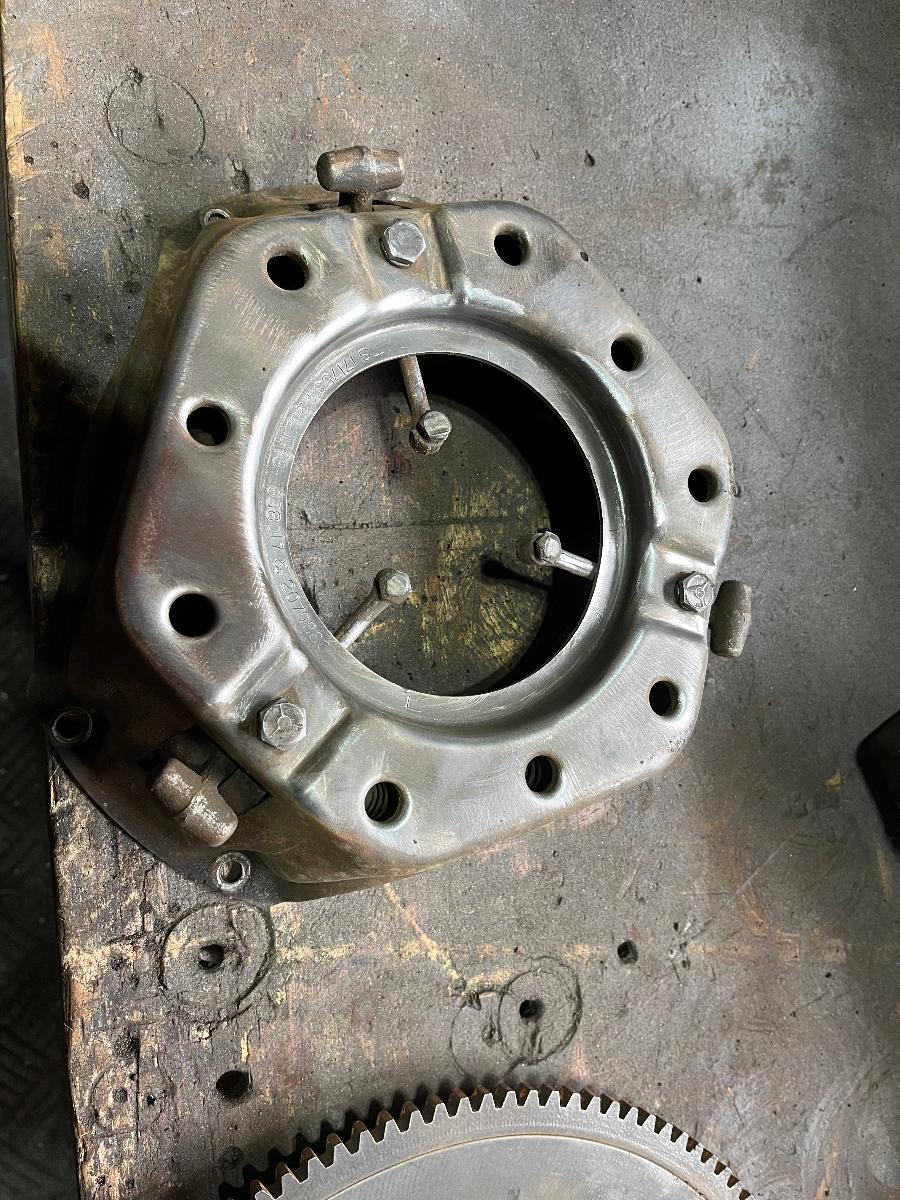

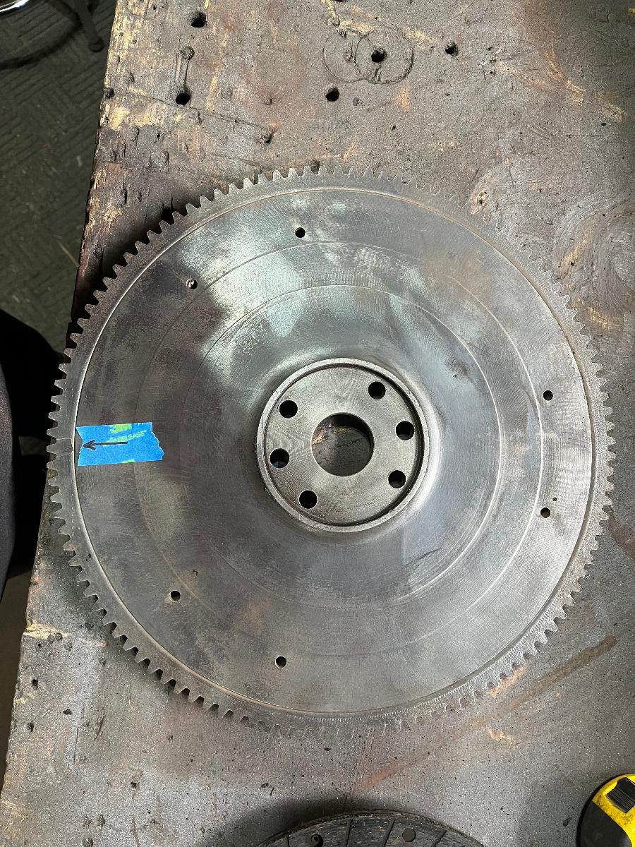

I want to put this in my merc and use the existing 3 speed trans and running gear. I purchased a cast bell housing and starter plate on this forum so that should work. The wear on the 8BA flywheel measures 10" but I think the flywheel bolt holes are for a 91/2 in PP. I am attaching some pictures ot the flywheel and of the PP from my original engine. My original engine has a 10" clutch disk but different hole spacing. Can you help me get a clutch and PP to work with my existing 3 speed. I have a 13/8 10 spline input shaft. Notice the one tooth on the engine side of the flywheel. It looks like some kind of a timing or line up mark.

An 8BA 9 ½” clutch flywheel measures 3" C/C between the paired holes and 7 ½ "
apart. An 8BA 10” clutch flywheel measures 3 1/8” C/C between the paired holes and 7 7/8” apart.
They're close, so be careful with measuring.
It looks like your flywheel is drilled for the 9 1/2" clutch.
