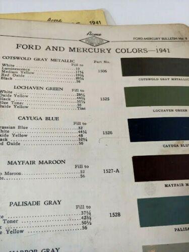

Rockfla
10-07-2022 @ 9:26 AM
Posts: 60
Joined: Mar 2019
Here is another one that has the actual colors/mixture!!!! Ebay "1941 Ford Colors"
115546026242
