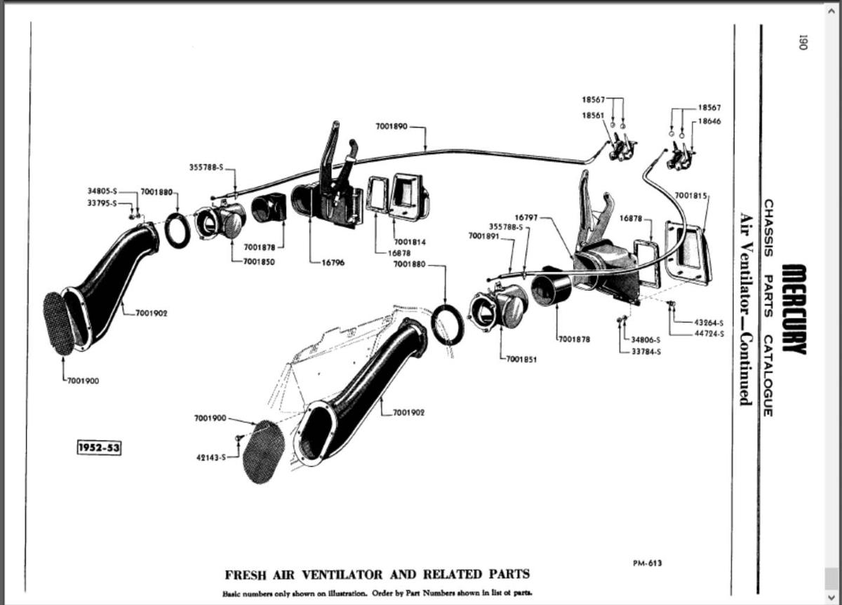

On the '52-'54 Fords there are two "Air Duct Ventilator Connector Rubbers" Part No. BA-7001878-C that connect the ducts from the front of the car to the ducts leading into the passenger compartment. These rubber connectors are located inside of each front fender, just below the top of the fender. They deteriorate rather quickly so it is quite likely that they are allowing under hood air into the passenger compartment.
06-13-2021 @ 10:14 AM
Here is the diagram of the 1952-1953 Mercury Ventilating system. You should be able to find the leak by examining the parts in the diagram.

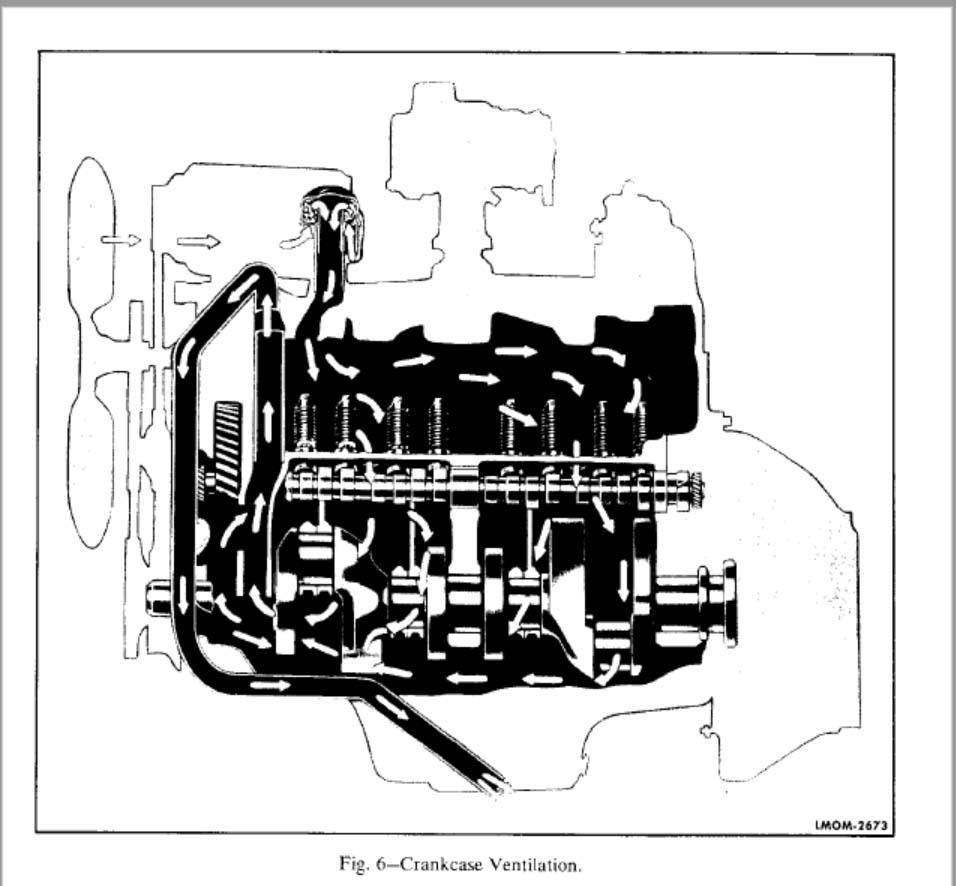

You should also check the breather cap on the fill tube and the the road draft tube that comes from the intake manifold. Make sure that all of the parts are in place and that they are clean and are not obstructed in any manner.
Here is a diagram of the oil ventilating system
