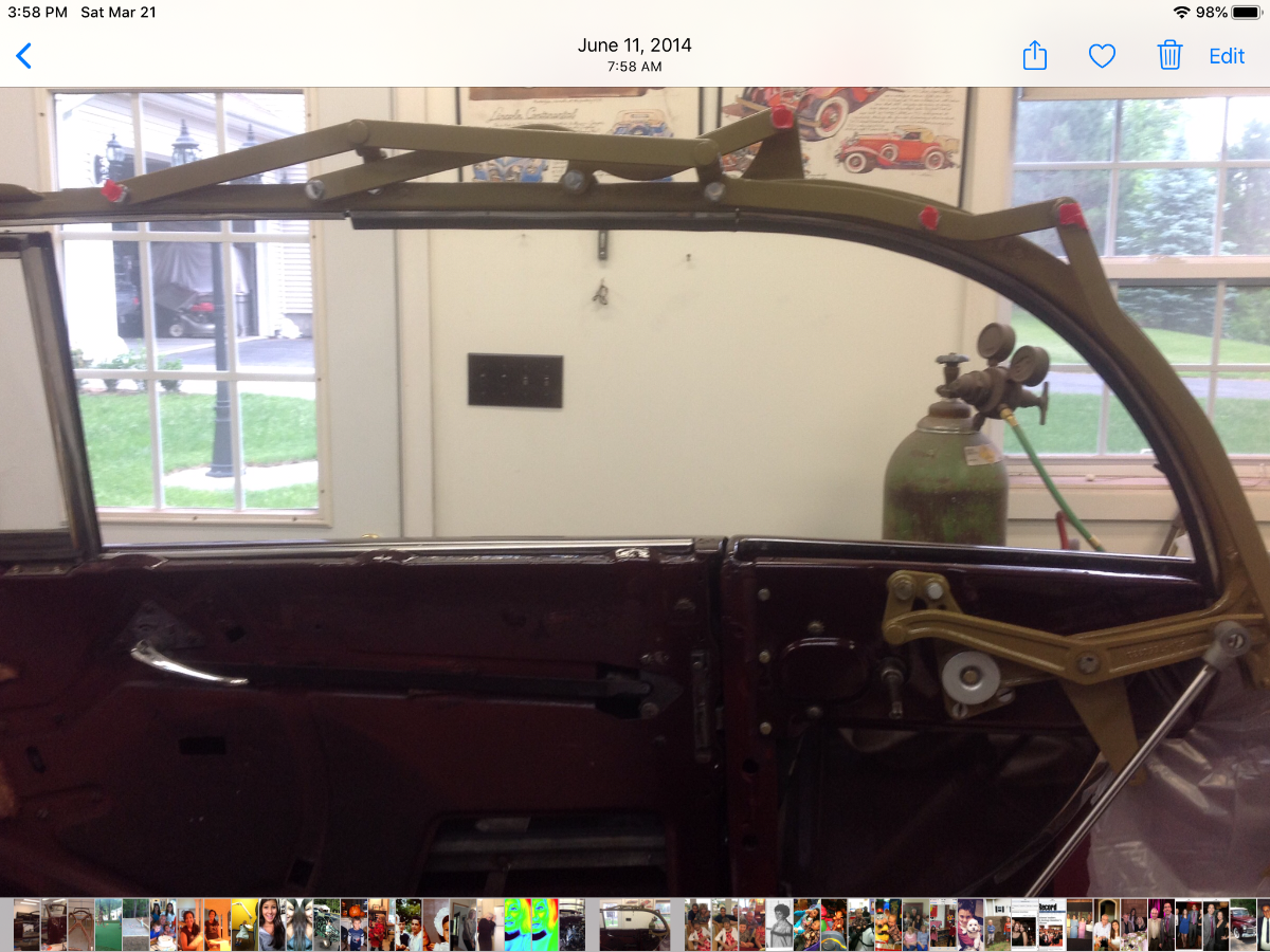

Here is picture of my 48 Ford which is the same, red tape show the bolts that do the
Adjusting. Also there is movement where it bolts do the mounting plate. Hope this helps

Thanks Tom that is a big help
