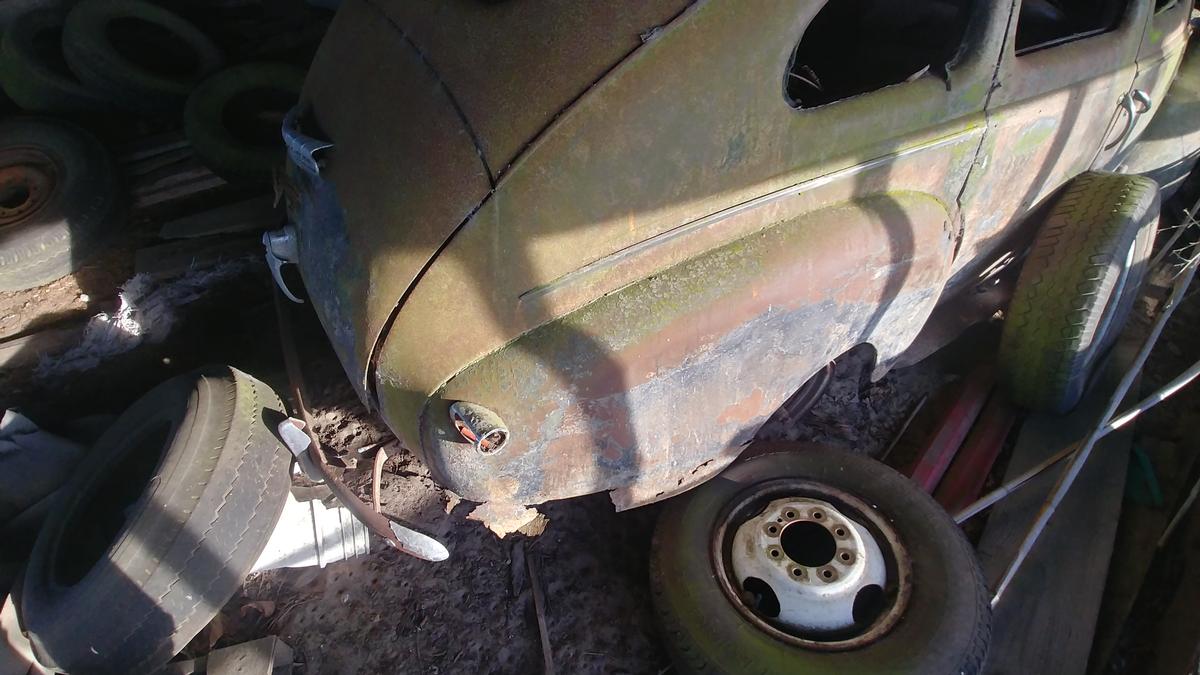

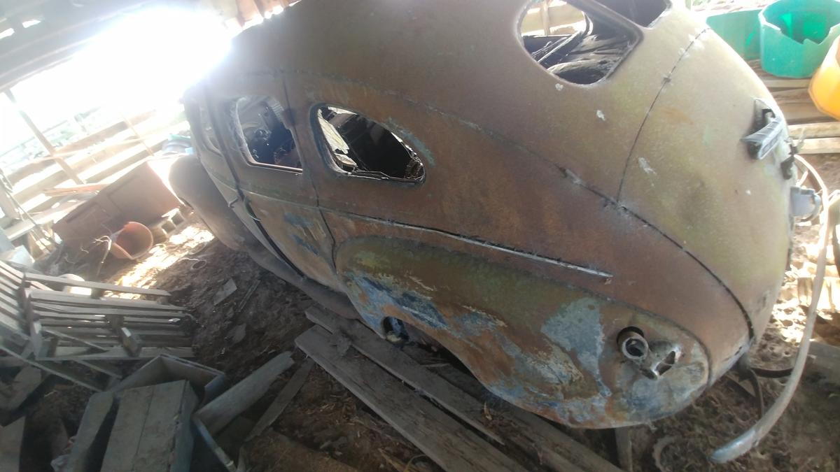

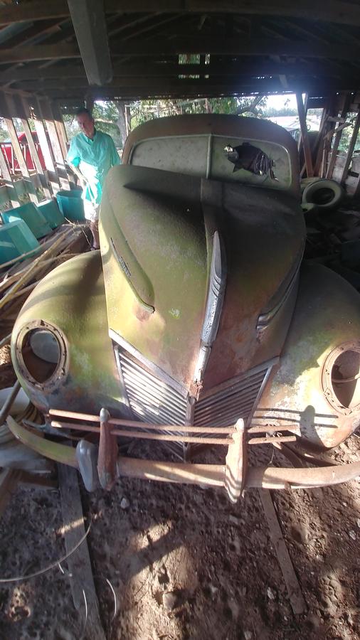

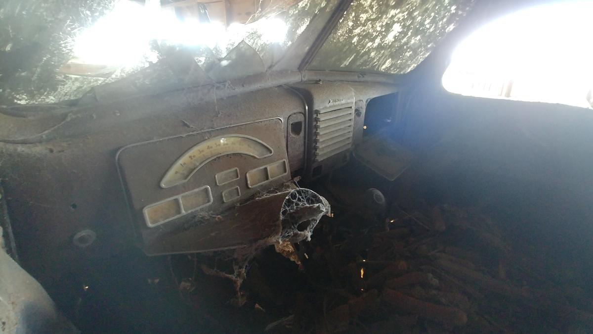

I havent got the car yet I want to see if a steering wheel I have will work so I can steer it onto the trailer. Ive been working and need my dad to help me load it on the trailer but here are the pictures I do have. It isnt in the best of shape but its 80 and how many people get the chance to buy a vehicle of their grandpas. It was here when I was little and it left not long after he died i always thought the old car was cool and am ready for it to come back home!
10-03-2019 @ 6:14 PM
Thanks for the photos. It looks like most of the car is there and could be restored. It will take a lot of work and time to do it. Make sure that you are up to the task and can learn the skills needed to restore it. Join a Regional Group of the Early Ford V-8 Club for moral support and help with getting the car back on the road.
