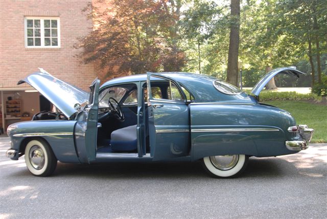

Well, it is amazing what a bad ground does to you! All fixed.
While I was at it, I replaced the front turn signals with LEDs lights. Much better.
As I suspected, I couldn't replace the rear ones with LEDs as the blinker became too dim. I guess there is not enough draw for the relay with rear LEDs.
In any case, thank you. Picture of my favorite car is attached.
06-22-2018 @ 7:06 AM
I like your car. Four door cars are a lot of fun as you get older. People can actually get in the back seat. I was looking for one when I bought my Lincoln, but when the low mileage unrestored Lincoln Capri Coupe showed up in the classified section of this website, I couldn't pass it up.

Hi DJ,
That is a beautiful car! I have a '49 coupe and I love that car, it just drives and runs so good!! TomO is right tho, the 4 doors are very user friendly. I have a '41 Caddy that is 4 doors and is great for riders. Continue to upgrade and enjoy your great ride.
I'm also going to try the LED's.
