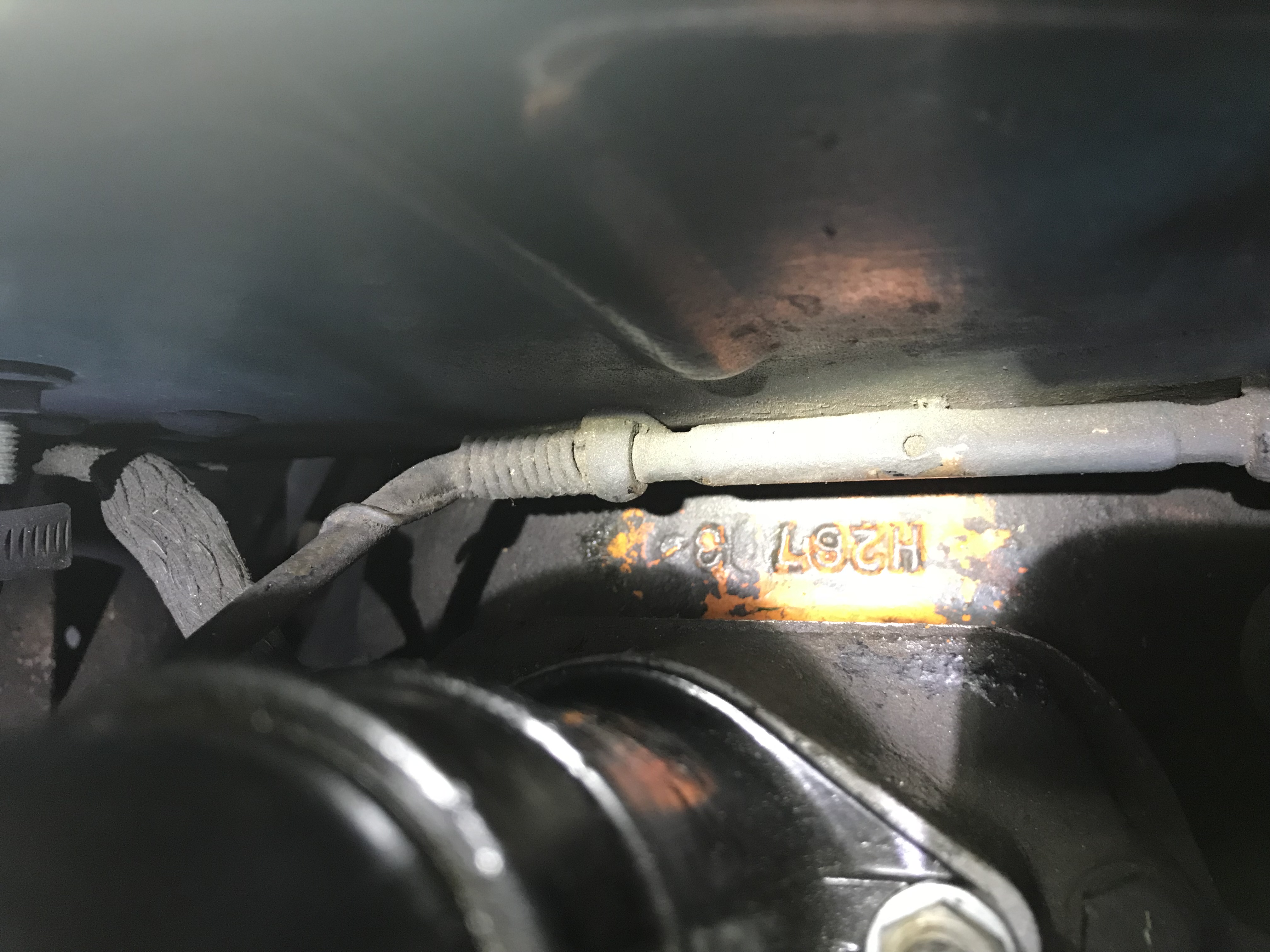

Ken, The only number I could find after a ton of degreasing is below. Does it look like this could be it? H267 0 or 9 3. ?

If the number placement is like the Ford, and I think it is, look along the top of left hand frame rail. The number should be located close to the front cross member in the area of the big rivet head and back toward the steering box. Some times the number is very faint and care must be taken to clean that area so as to not destroy it. The number you have pictured is probably a foundry number and has no association with the serial number

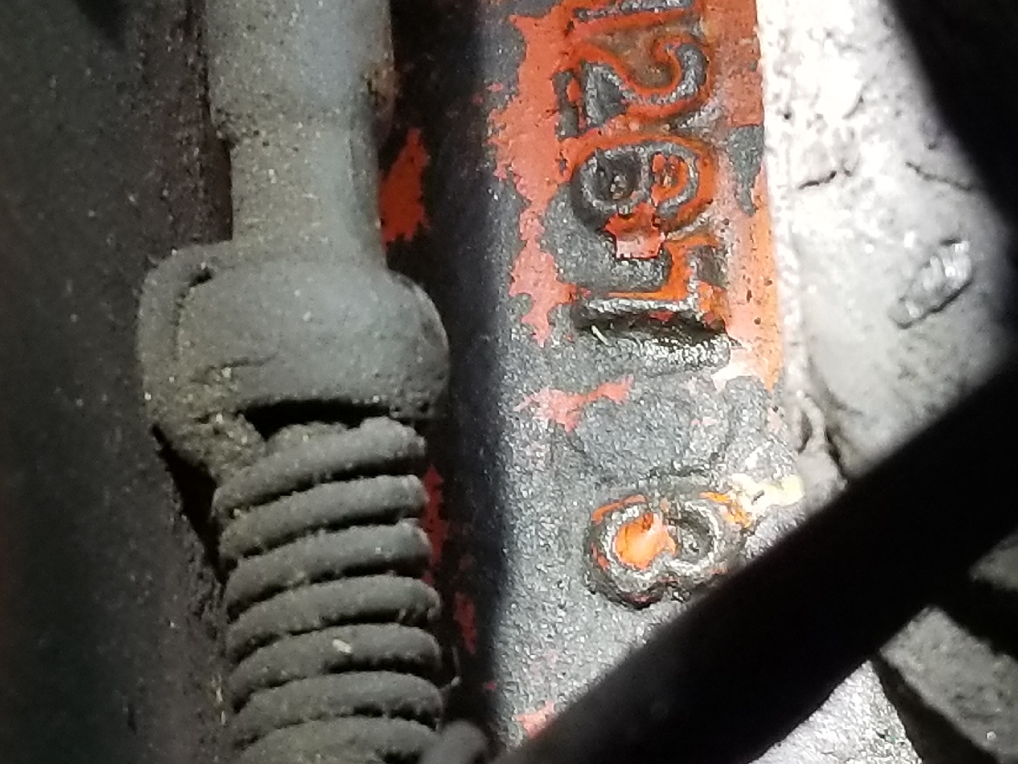

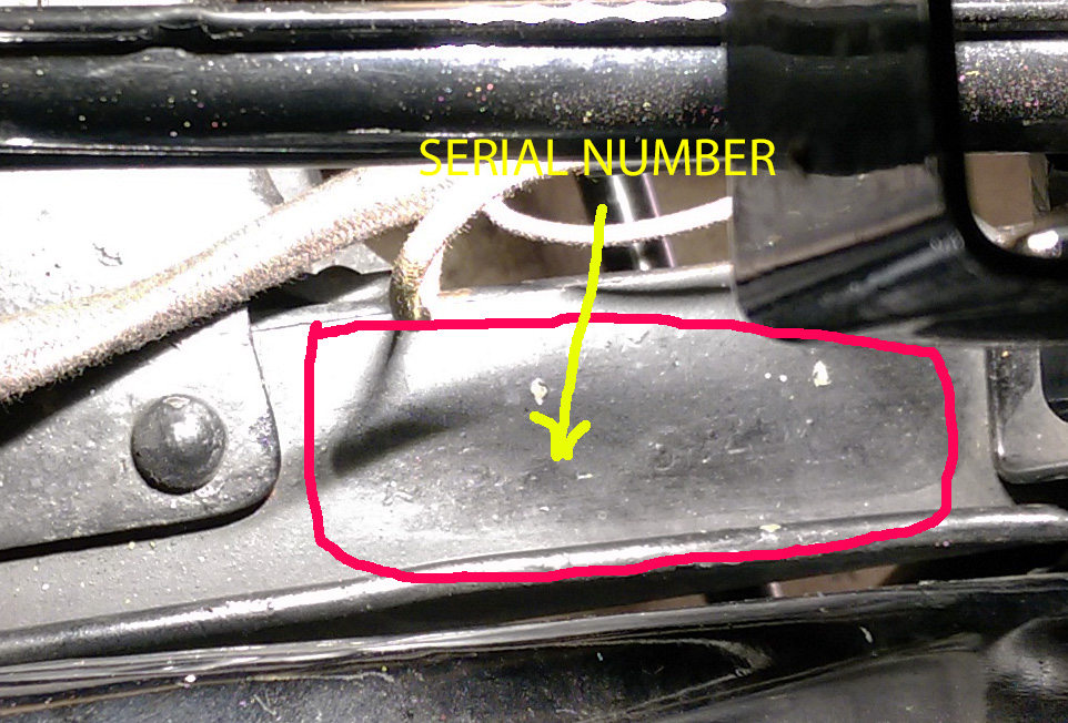

The numbers that you are showing are on the engine block. The serial number is stamped, not cast, on the left frame member between the front cross-member and the front body mount. The one on my 40 Mercury is stamped between the front cross-member and the horn mounting bracket. There is enough paint on my chassis so that you really have to look hard to see the starting * 99. To see the rest of the number would require removing the paint. Here is a photo of it, you can barely see the numbers

Your looking in the wrong place. Its on the frame itself and as Tom said their stamped in ,NOT raised #'s like you show.

Hi Tom, I found it, and took it back to the DMV, and this time it failed inspection because the headlights aren't working. I assume its the fuse or the bulbs are just burned out, but that's the next thing to figure out. Thank you for your picture, it helped to locate my id #
