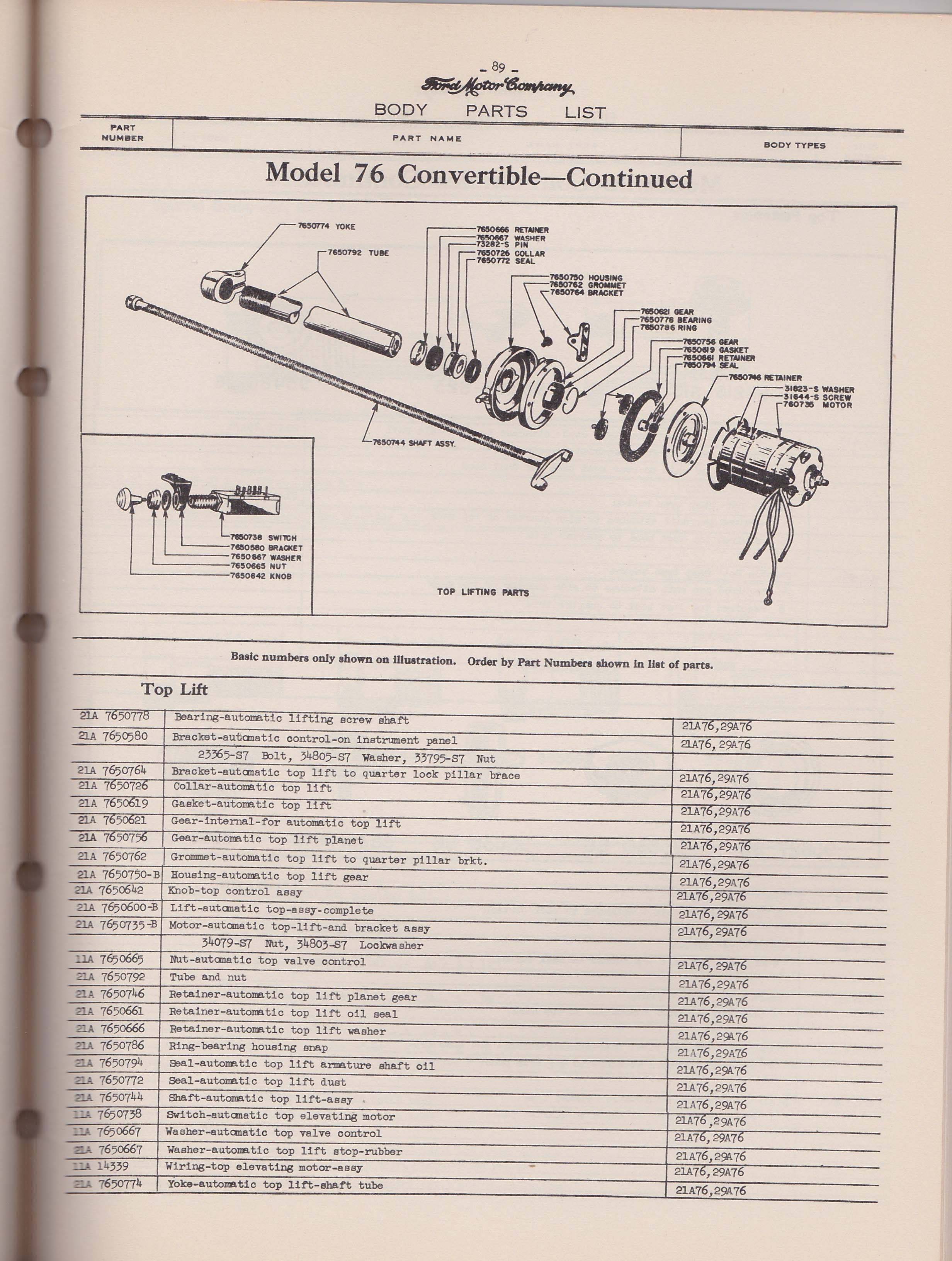

Thanks Tom, Brought the car home over the weekend. Got it running via iv and am really pleased thus far. When thru the owners barn and located all trim (good shape). Went over,around, and under= very solid with only surface rust here and there. Believe it or not.... located a nos front header wood bow. Looks like I am missing connecting parts from the motors to the top>> need to research as I have no idea what they look like. Purchased service manul, parts manual and will take it from there. Jim

Posts: 7384
I looked in the 1942 Body Parts catalog and they do not have a good drawing of the lift mechanism. The 41 and 42 Convertibles used a jackscrew type of lift mechanism, the 1940 used vacuum cylinders and 46-48 cars used hydraulic. I have attached the drawing of the 1942 lift mechanism, it is different but similar to the 1941 lift mechanism. If you want to stay all original, check with the 39-41 and the 42-48 Mercury advisors for drawings or photos of the lift mechanism. Another source would be the 41-42 Ford advisor. Their contact information can be found in the current edition of the Early Ford V-8 Club publication of the V-8 Times. Their advice is free to all Club members. If you do not intend to restore the car to original, you can convert it it the later hydraulic system.
