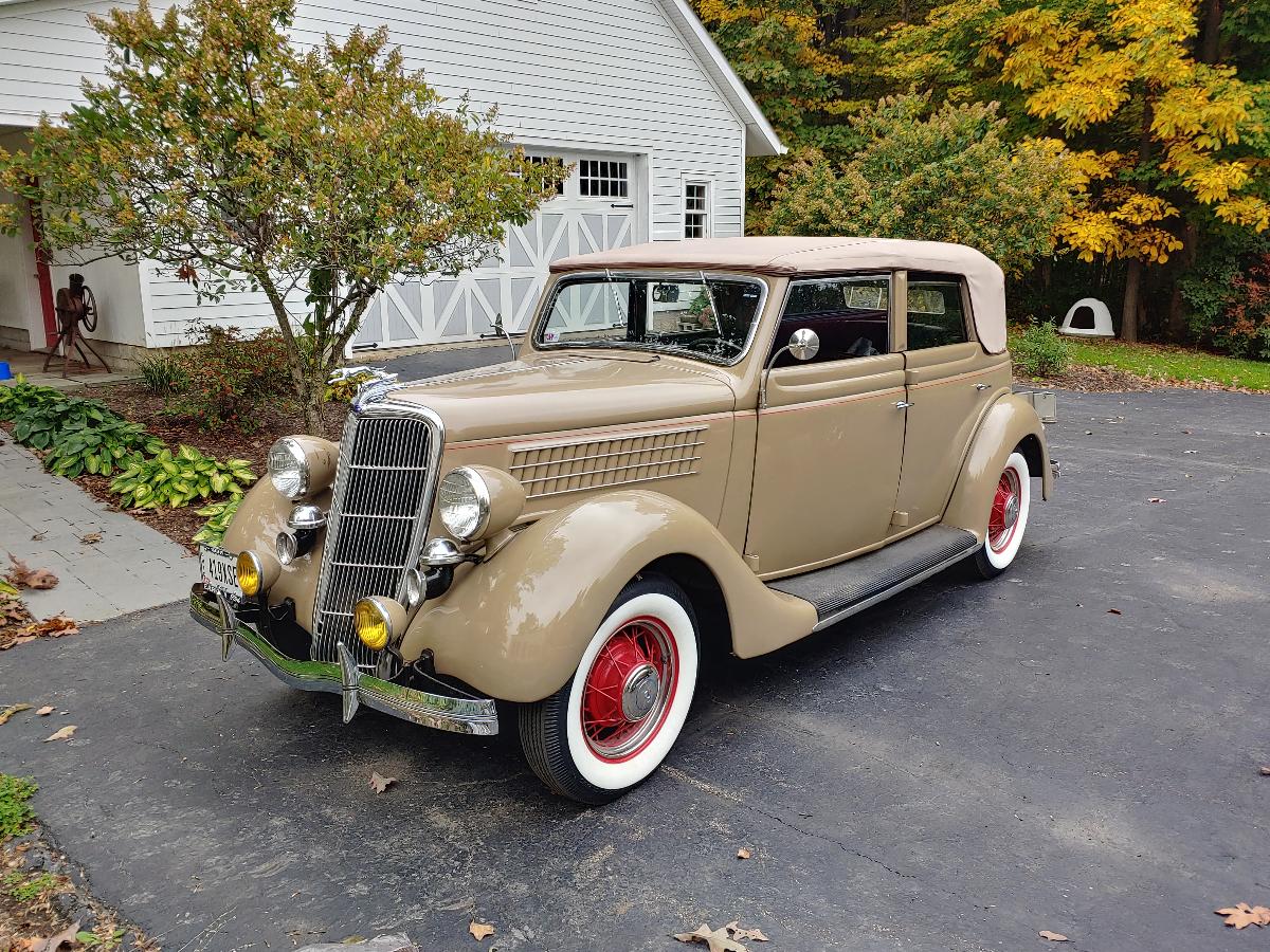

eli33 |
10-27-2021 @ 5:49 PM
Posts: 19
Joined: Nov 2013
Dad's car (I lost him in '06) is back on the road. We put about 100 miles on it today in cool, Ohio weather. I am now the age dad was when he bought it, then about 75% restored. He eloped in 1944 in his Marine brother's 35 Ford 4-door. He wanted a an early V8 for 50 years before he broke down and bought this one. I have tried to be a good steward of it.
