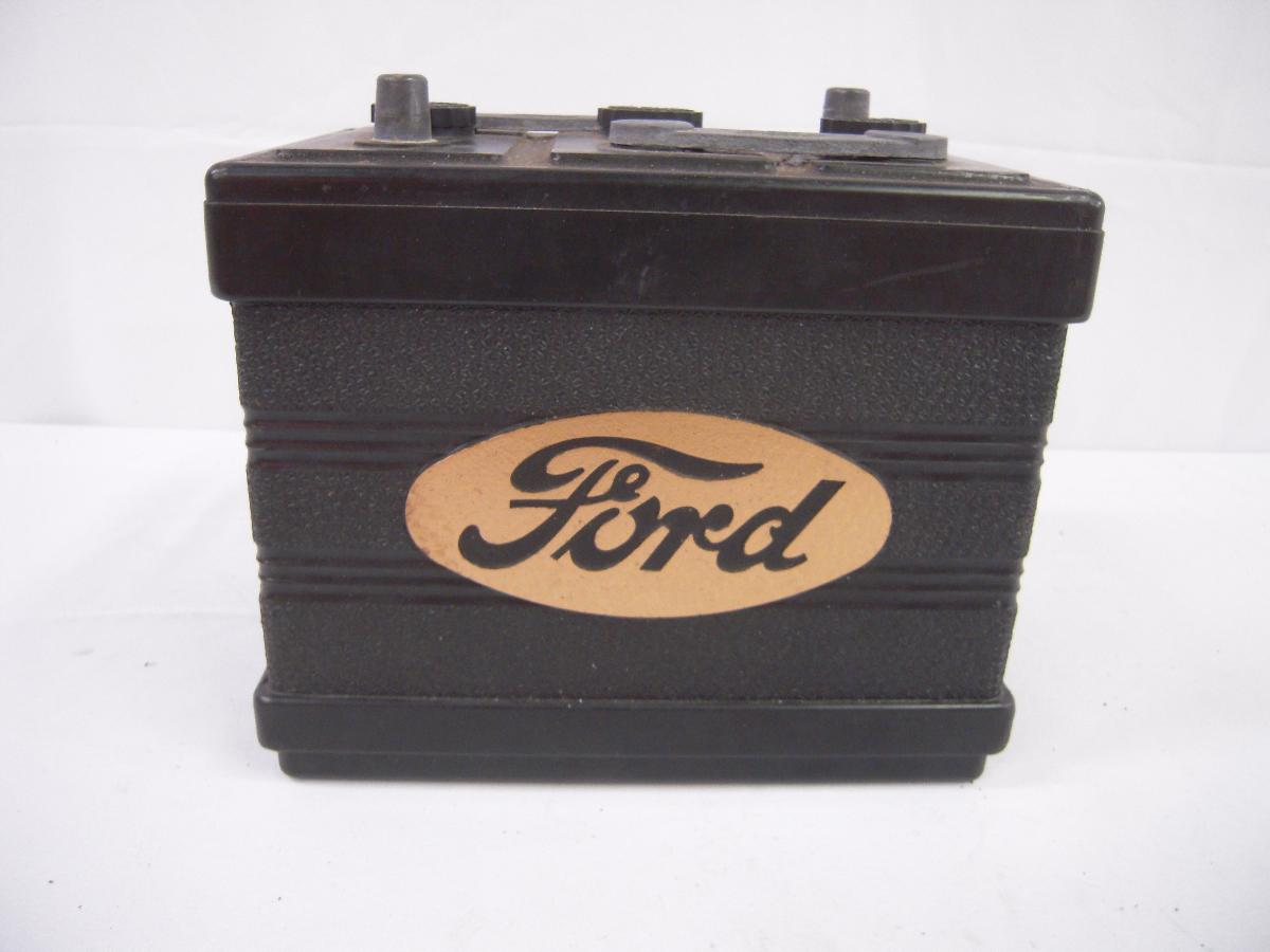

Is an Optima based Ford script battery considered correct for Concourse judging? I bought one from Restoration Battery.

Be certain it has the correct vent caps and you have painted the area surrounding the Ford script and you'll be fine.

The area surrounding the Ford script was gold on the "standard" issued battery. Mike "Kube" Kubarth

I have painted the oval area shown in the photo. Since the battery case is polypropylene, which is notoriously difficult to paint, I used an adhesion promoter, then a two part primer. These are the same products used on TPO (thermoplastic olefin) bumpers. TPO is a pp/thermoplastic rubber compound and is also difficult to get paint to bond. Thanks for all your help.

Hmmm.... I have never had an issue with adhesion. I typically rough the surface up with 400 grit and wipe it with lacquer thinner. I then apply the gold, no primer. Even after numerous years, they have all held up quite well.

Hi Mike, On the caps, I do not know the correct answer so.... Mine have in a vertical set "Plug Most Be Tight". Circumference says, "Do Not Remove While Charging". There is the small U.S.A. as well. I think that is correct because there was no Ford script on the 40 battery caps. I Think! Thanks Ken

Hey Ken, Those are the correct caps for 1940.

Mike what paint brand and color gold are you using? Tom.

std1940, Believe it or not, I use Testers paint, Gold. It holds up very well and is quite easy to apply. I clean the area with lacquer thinner, no primer necessary.
