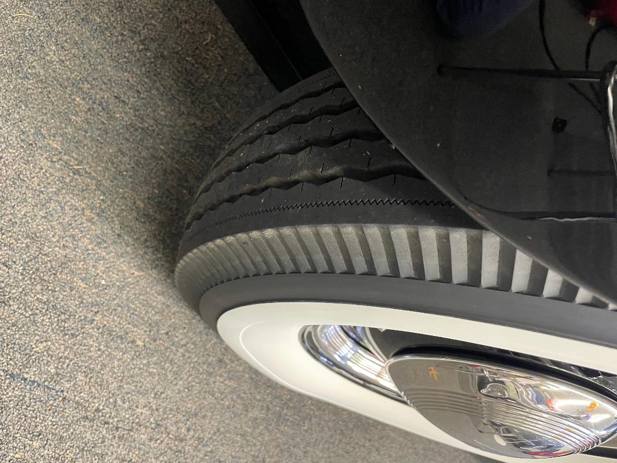

Have you noticed any front fender rubbing with the next step up size of 650 - 16 ? I spoke with Corky Coker's daughter, Casey at a recent car event. She warned that the 650 might rub. I'd rather have the 650 since it offers more rubber on the road.

I have a 1940 Fordor with Firestone 6.50 - 16 from Coker. The fronts rub very slightly if turning a 90 degree corner a bit too fast. It's really not an issue; can't see evidence on the tires. I'd go for the 6.50s.

Thanks to both of you for your emails. The answer is "Yes". I do hear a LITTLE rubbing on the front tires, just like Barney mentioned. OK, Gene and I agree - more rubber on the road with the 6.50s. I see no damage to the front tires either. Just take it easy on the turns.
My car is in semi-retirement and only gets driven short distances around the neighborhood. I'll just be a little bit more cautious about making real sharp turns, so we can all keep safe.

No problem of rubbing at all.
My car has stock suspension.
The 6:50x 16 is listed as an option in 1940.

Gene, 6:50 x 16" was an authorized option from Ford in 1940. I have installed them on each and every one of my restorations. In my opinion they appear much nicer than the (too small) 6:00's.
Fender rubbing? Never.
If someone has an issue with rubbing, there's something askew within the geometry of their car. My initial thought would be a worn-out spring.
