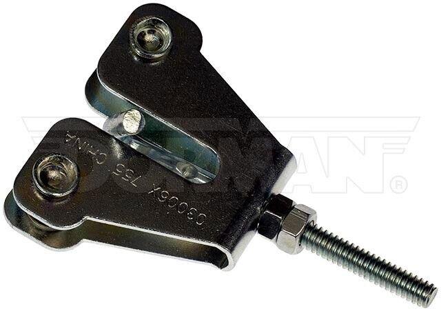

Or, if you can find one, a cable shortener. Hard to describe, but it goes on cable with a threaded hook with a nut on the end. The cable goes around another part of the device. Wish I had a pic!

One of these?

what a clever idea ! thank u. i suppose I can aquire 1 at my local auto parts store.
