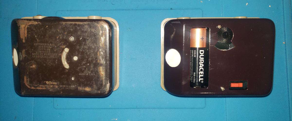

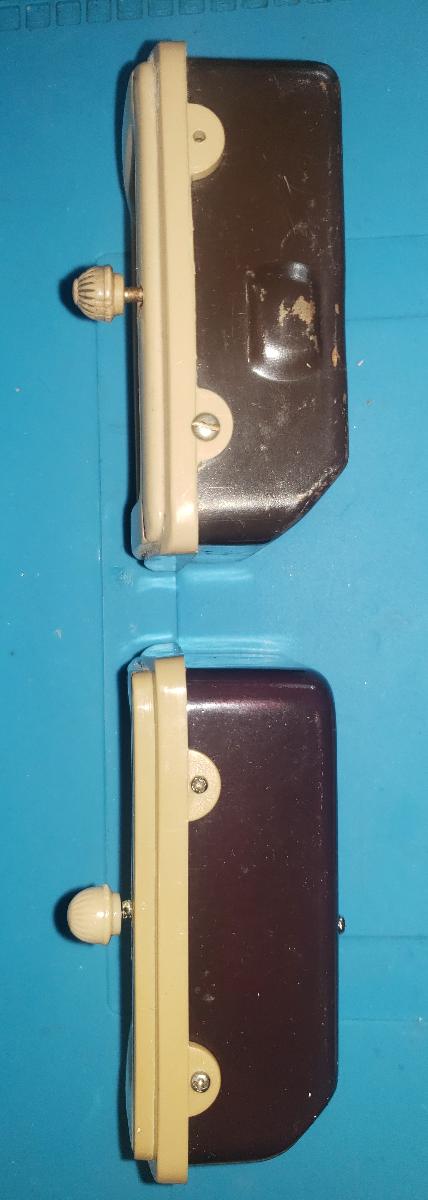

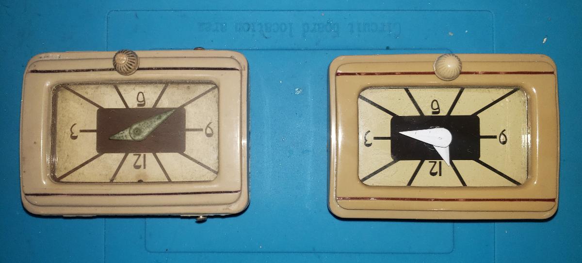

the quartz clock made its appearance in the early 90's...I would strongly suggest that the original clock be sent out to a qualified vendor for general cleaning and repair. I have used Clockwork with good results.
