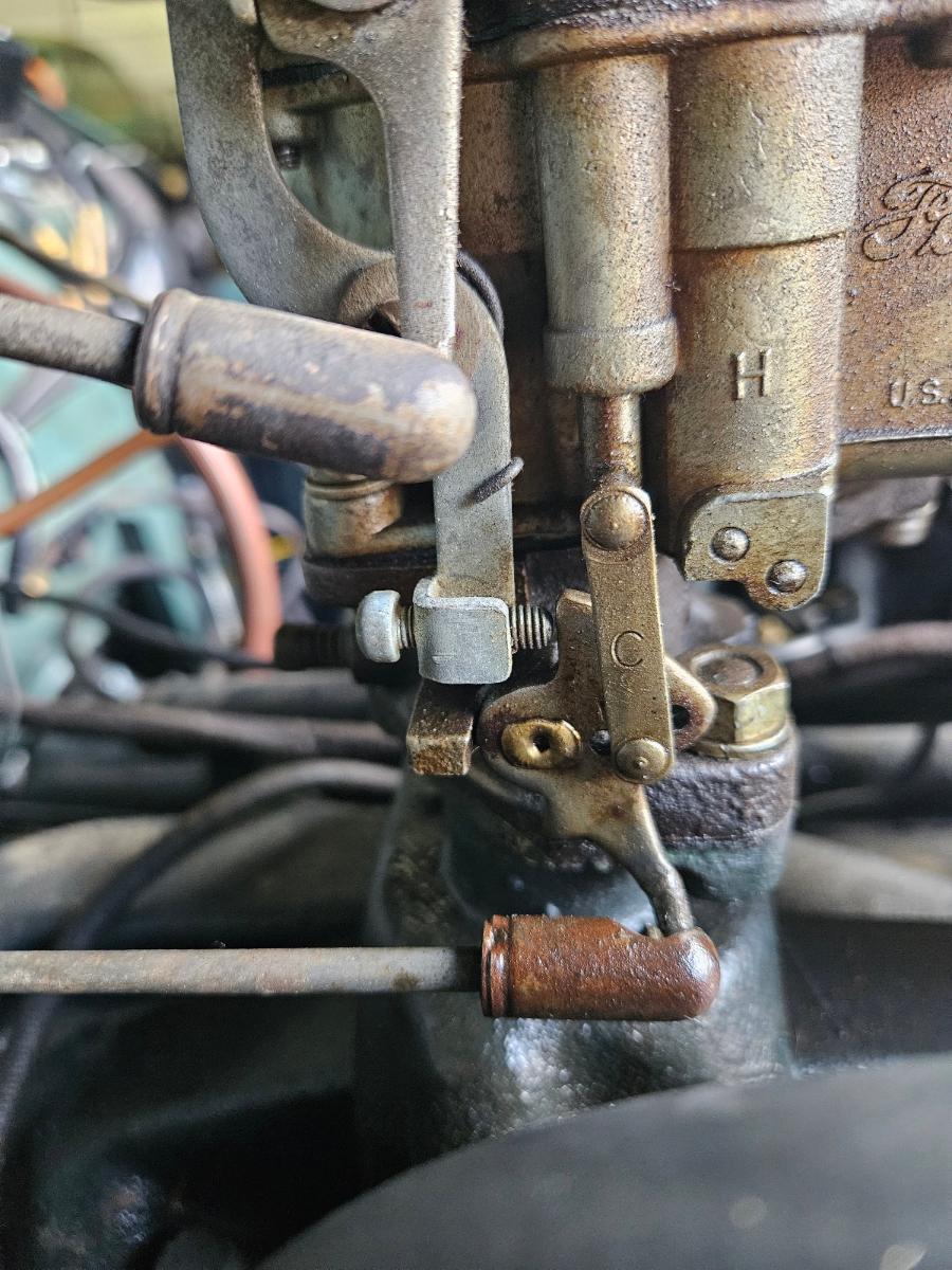

The car is a 1940 Fordor Deluxe with a 59A engine...
It has been running great... I've been checking the plugs to keep an eye on how rich or lean it is running.
I've just finished cleaning the cooling system... flushing the block and radiator, new pumps, new lower hoses, etc... I determined that at idle, there was practically no coolant flowing at idle... just off idle, the flow picked up quickly.
The engine was idling at about 500 rpm... I bumped that up to about 600 by turning in the throttle stop screw on the passenger side of the carb... at 600, I was getting a steady stream of coolant... not a lot of volume, but it was flowing...
I attempted to drive it for the first time today... it didn't want to idle smoothly, and was running like it was flooded. I pulled it back in the shop and pulled a couple of plugs... they were black... definately running rich.
I'm assuming that by turning that screw in, I not only raised the idle, but also managed to get into the enrichment/ accelerator pump circuit somehow? What is the proper procedure for adjusting the idle?
Thanks- Bear

12-02-2023 @ 6:11 AM
Posts: 1800
The original Carb. for the 1940 Ford is the 94 model 91-99, it should work well with the 59 engine. The accelerator link (marked "C" ) in your photo is correct for the 91-99 it has three settings. #1 for summer, #2 winter and #3 for extremely cold. Setting the link to #1 will slightly lean the fuel mixture. Yours is now at #2. There is just one adjustment that adjust the fuel mixture. The two brass screws are for the idle mixture only. With the engine warmed up and choke completely open, adjust each screw slowly for the highest engine RPM and smoothest idle. This can be done with a vacuum gauge on the engine adjust for the highest and most steady vacuum (about 20) If the above does not correct your rich condition, the Carb will have to be removed and float level checked and the jets checked for proper size. The power valve and it's gasket can also effect rich condition. The best rebuilding kit for the Ford, Holley, 94, 91-99 comes from Daytona Co. in Florida. They have a web site.

682bear
01-15-2024 @ 11:20 PM
Posts: 27
Joined: May 2023
Just to update:
I've been tinkering with the carb off and on for a few weeks and have finally given up...
I removed the top of the carb and noticed that the float bowl was almost empty... apparently the fuel was leaking out through or past the power valve... there is also some sediment in the bowl.
I have removed the carb from the engine and am letting it dry out in preparation to ship to Charlie in New York for a rebuild...
-Bear
