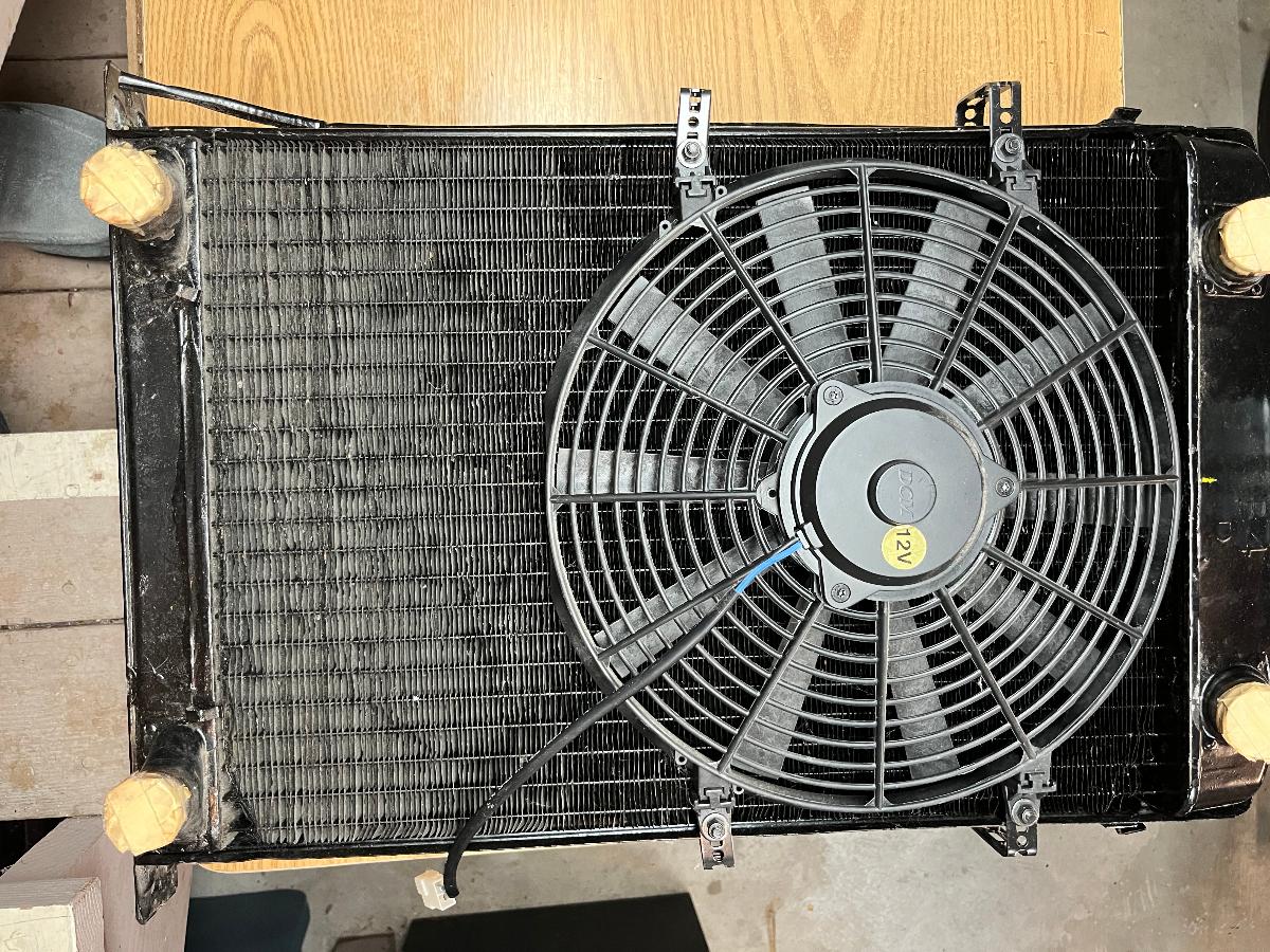

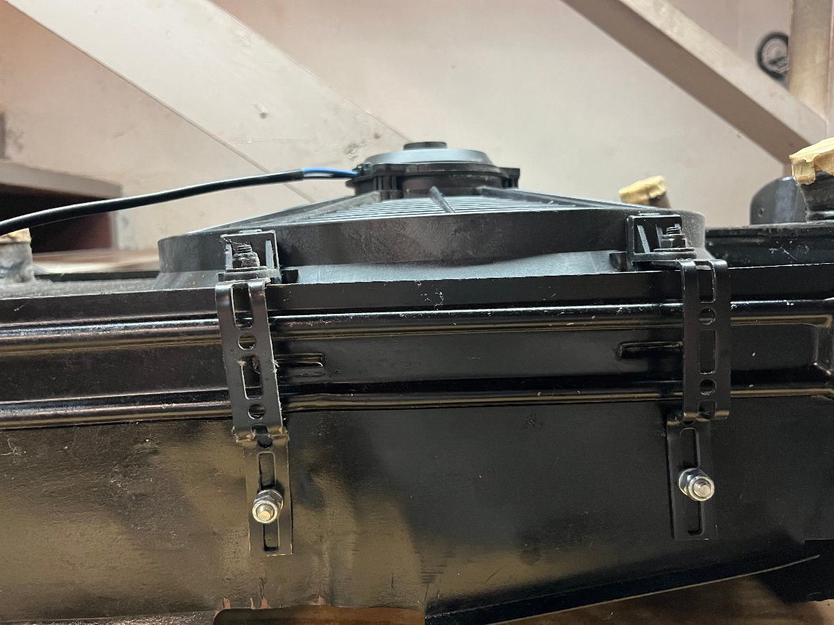

08-28-2023 @ 4:50 PM
Posts: 1976
Here are some pictures of the electric fan mounted to my 1937 Ford V8-60 radiator.
The fan is actually mounted near the top of the radiator. Orientation of the photo makes it look otherwise.

Thanks for the photos. Why do you not have a shroud? I thought a fan without a shroud doesn’t produce the results that a shroud provides?? It sure would make it easier on me to not have a shroud.

Posts: 1976
This car is still under construction. If it has cooling issues, a shroud will be added later.
