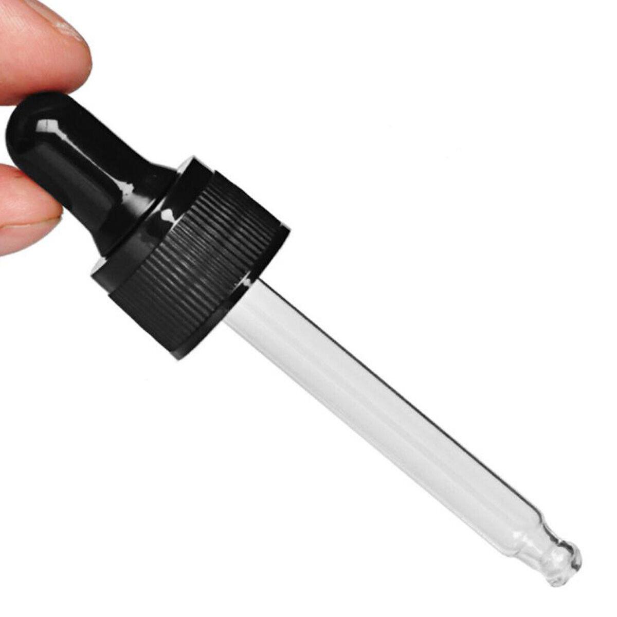

eye dropper
classiclover
08-29-2023 @ 7:49 AM
Posts: 84
Joined: Aug 2021
Genius
Thks

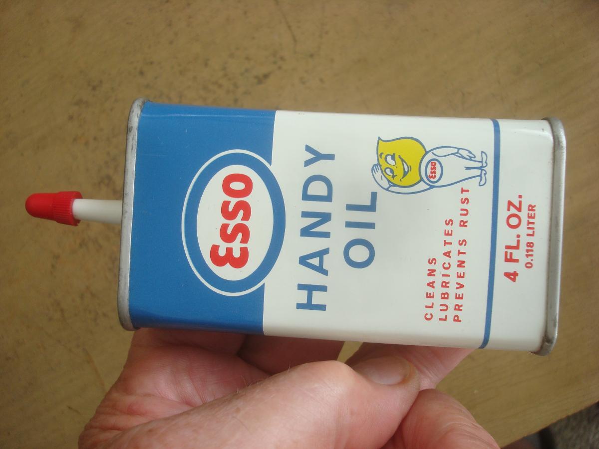

You could use 3 in 1 oil comes with a spout. and it is good oil,
my 2 cents 37Ragtopman, Maine
also a ESSO oil can would work,
